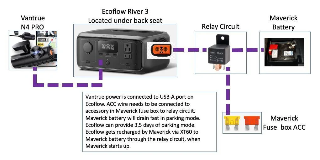

The 110v outlets supply a weird split phase current that many electronic devices don't like. Plug it into the 12v cigarette lighter socket instead and you'll be good to go. It puts out about the same (EDIT: I was wrong, it puts out around 250w, NOT 400w) that the inverter does
If you want to plug it in the bed, order a lighter socket from maverickinnovation on Etsy
250w, that's almost 21 amps. ecoflow dc charging option will only pull 8 amps at the most ughrrr!!!

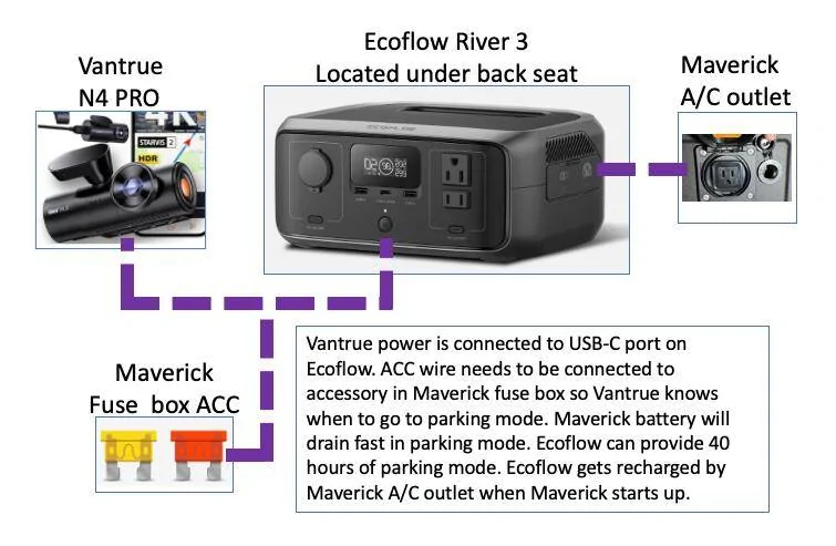

My Ecoflo didn't like charging in the 22 Maverick either. It was buggy at best. I bought a BESTEK 300Watt Pure Sine Wave Power Inverter to get it to work.

sorry 64jazz it didn't work for you either. i might hook up an o-scope just for kicks... i really want to use the automation as in when i turn on my maverick the a/c outlet turns on and charges the ecoflow. i'm old and lazy anymore haha!!!

i thought these a/c outlets in maverick was mainly for recharging tools?
A portable powerstation with picky GFCI/power input detection isn't exactly the typical basic switchmode power supply that most tool packs charge off of.
