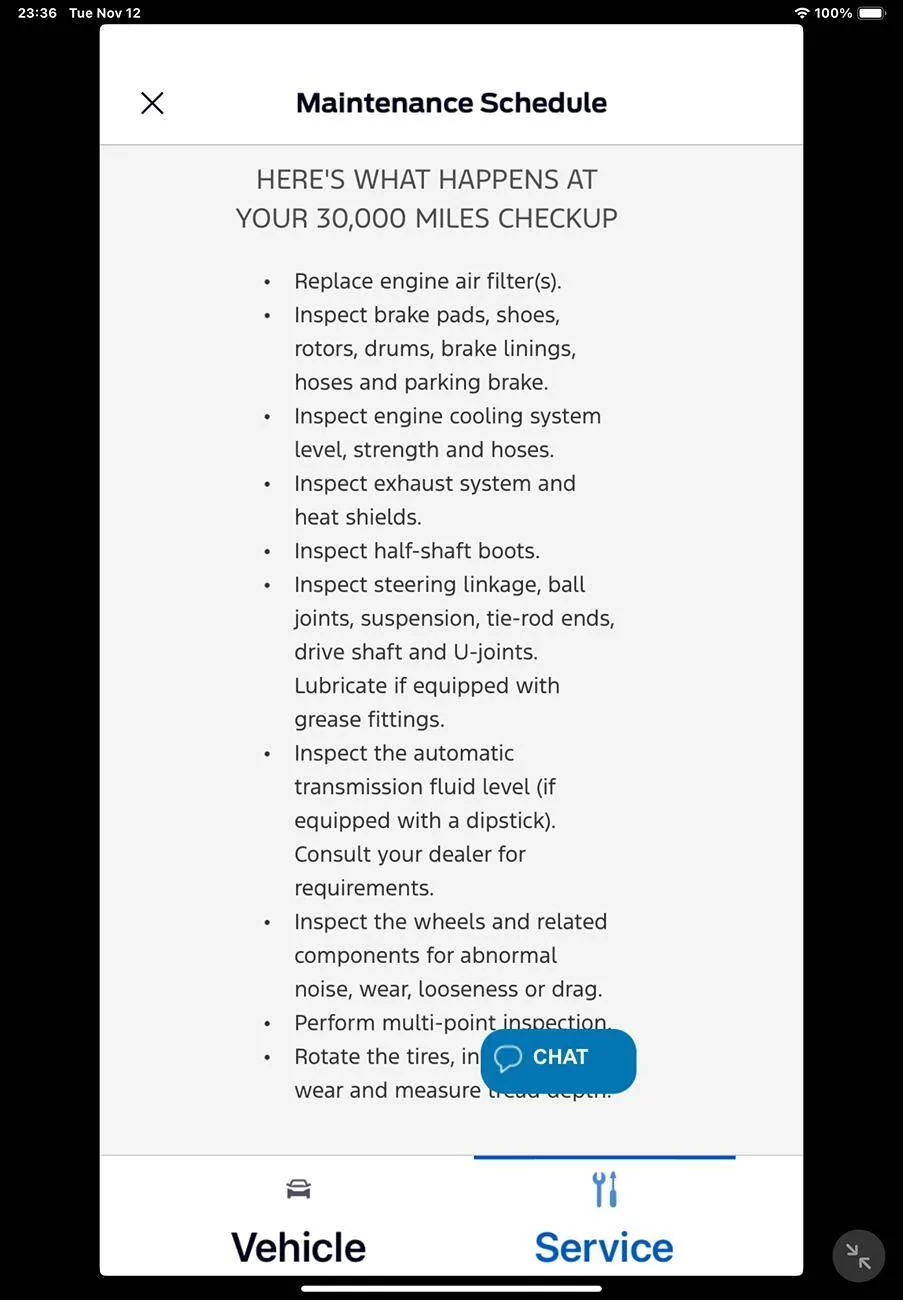

30,000 Mile Checkup ? Cost? Necessary for Warranty?

Ford's advertised interval for hybrid transmission fluid change is 150K miles under normal conditions, down to 30K for extreme conditions, like towing.
numike
mike
Dec 17, 2021
69
372
219
96912
car
Unlike the automatic, there are no friction materials (clutches/bands) in the hybrid transmission. Breakdown of the friction modifier additives are the main reason for changing automatic transmission fluids.
Think of the hybrid transmission as more like a manual transmission. It only contains gears and bearings so the lubricant lasts a long time.
and when is the normal service recommended?
