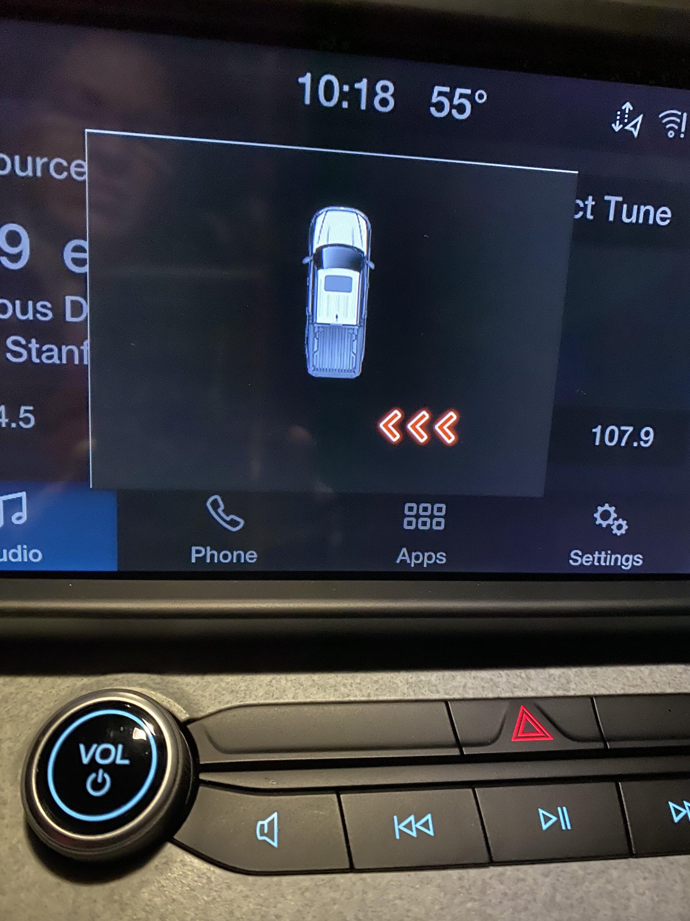

These 3 arrows increase from 1 to 3 and did not turn off on my 10 minute drive home. No other warnings on the instrument cluster. I can’t find anything on the manual. Any ideas?

Cross-traffic alert. It's trying to tell you that a person/vehicle is approaching from the side behind you. Should only be active in reverse. It's the feature that gets shown off in commercials as backing out of a driveway when a kid comes down the sidewalk behind you...
Probably just a bug, did it come back the next time you went for a drive?
https://www.ford.com/technology/driver-assist-technology/blis-cross-traffic-alert/

Thanks for the quick response! Hopefully it’s just the rain that made it stay on, I’ll find out tomorrow.

I had it bug out and stay on screen like that once as well. It went away switching into AA, but after parking it showed up again (although wasn't on-screen when I reversed to park).
