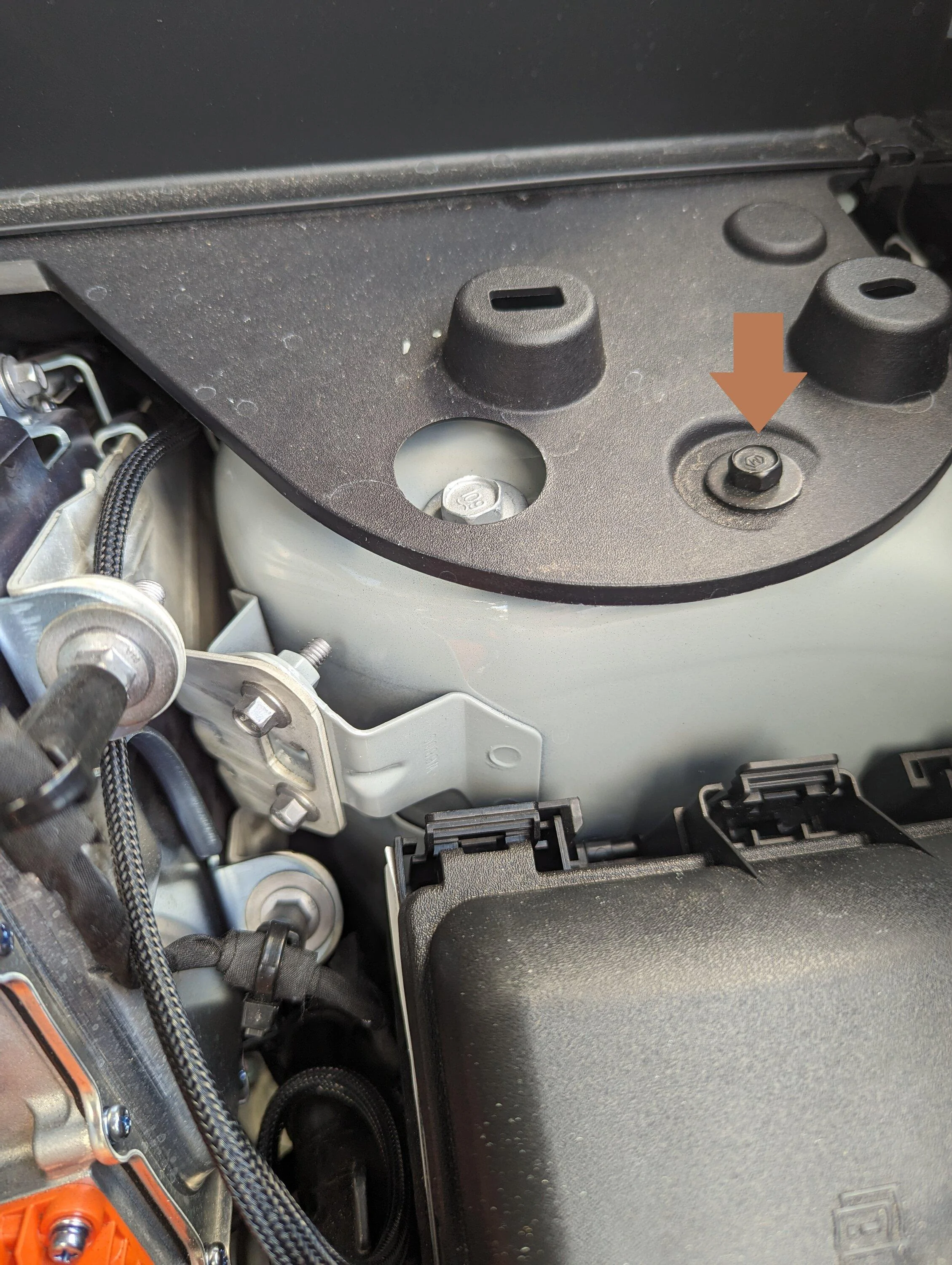

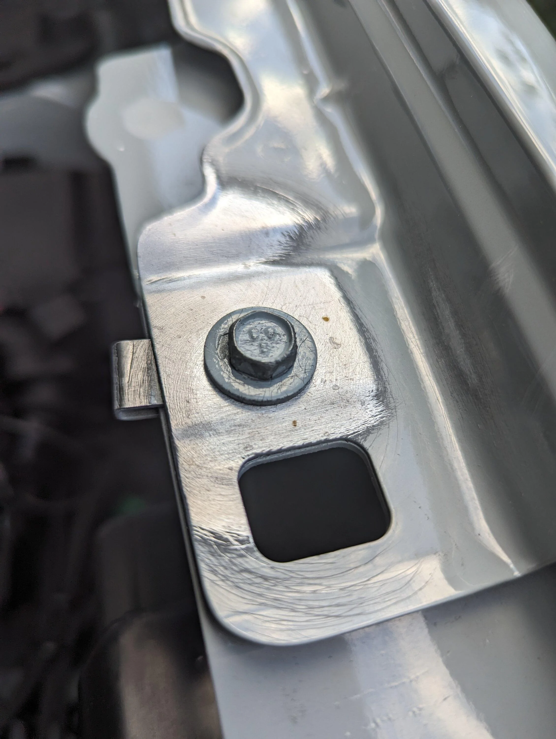

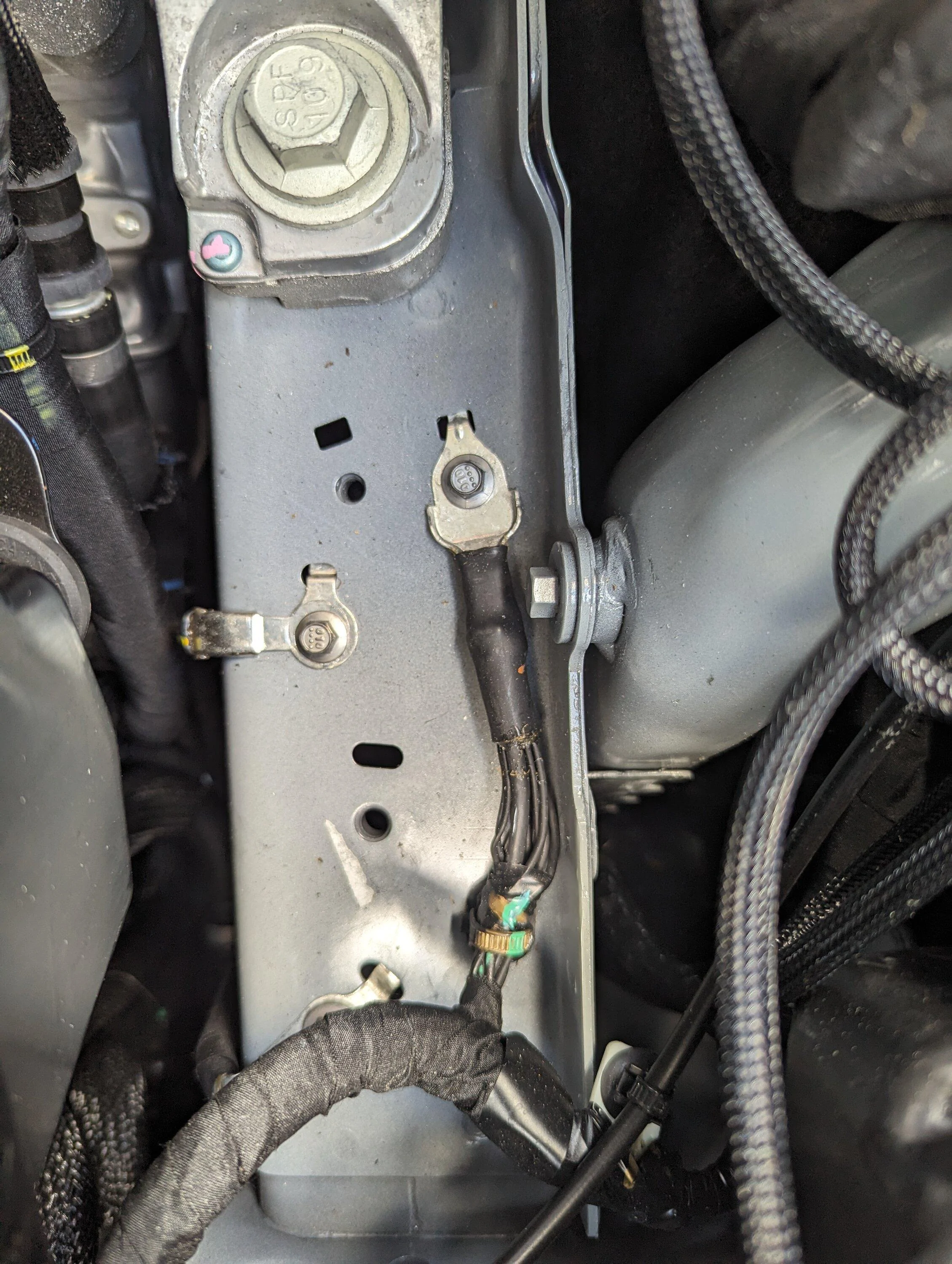

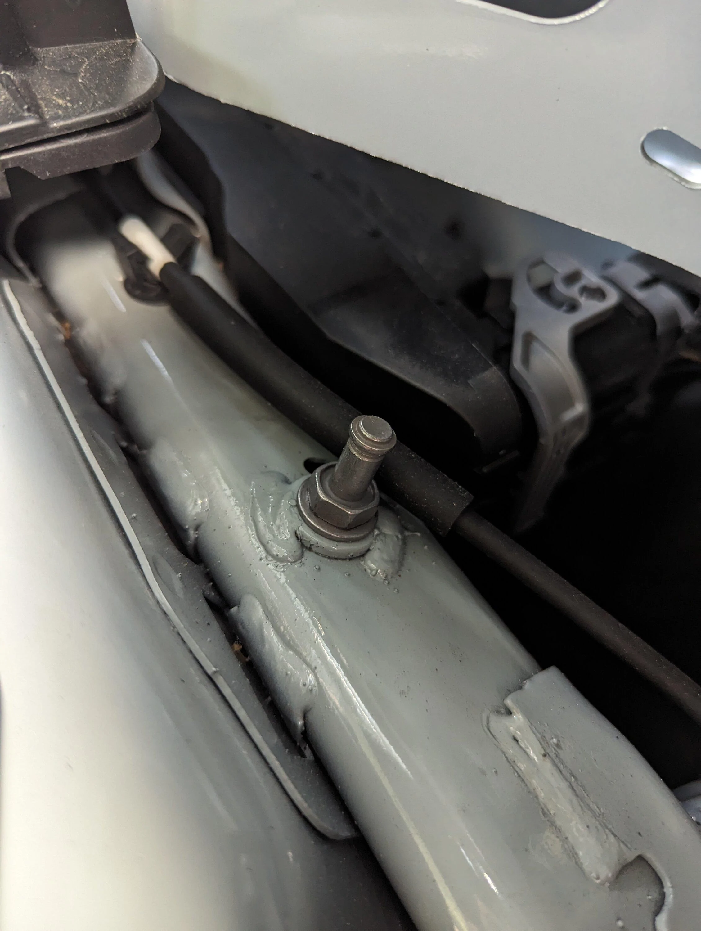

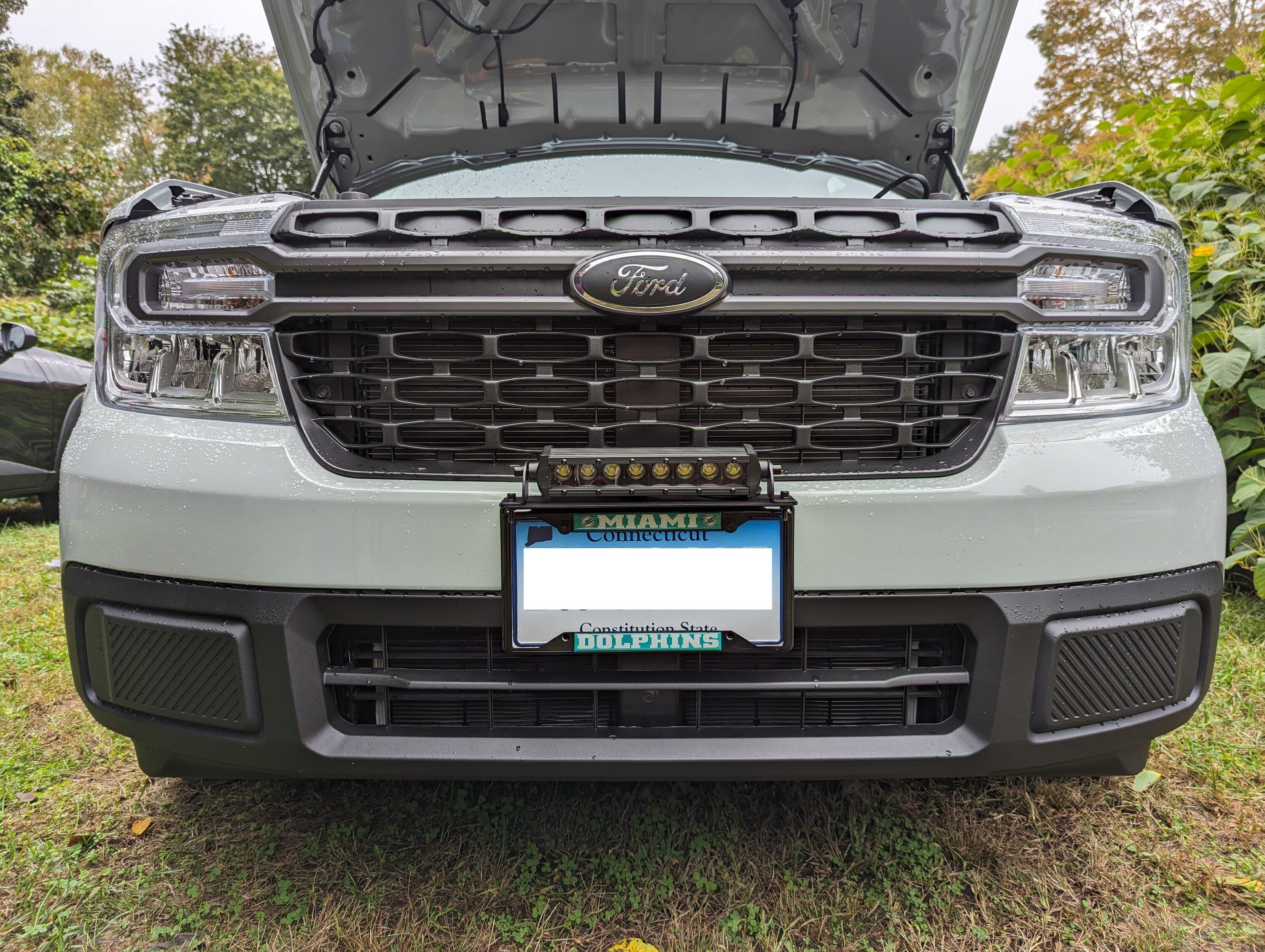

Purchased this LED lightbar (1) with a license plate mount. Watched a few different videos off the YouTubes. Installation took about an hour(2,3). Issue was the ground. Tried all three points (4) and a suggested point after removing paint (5). I also tried the negative post (6) and a LED strip ground post (7). Even after all those, still had awful EMI over the radio.

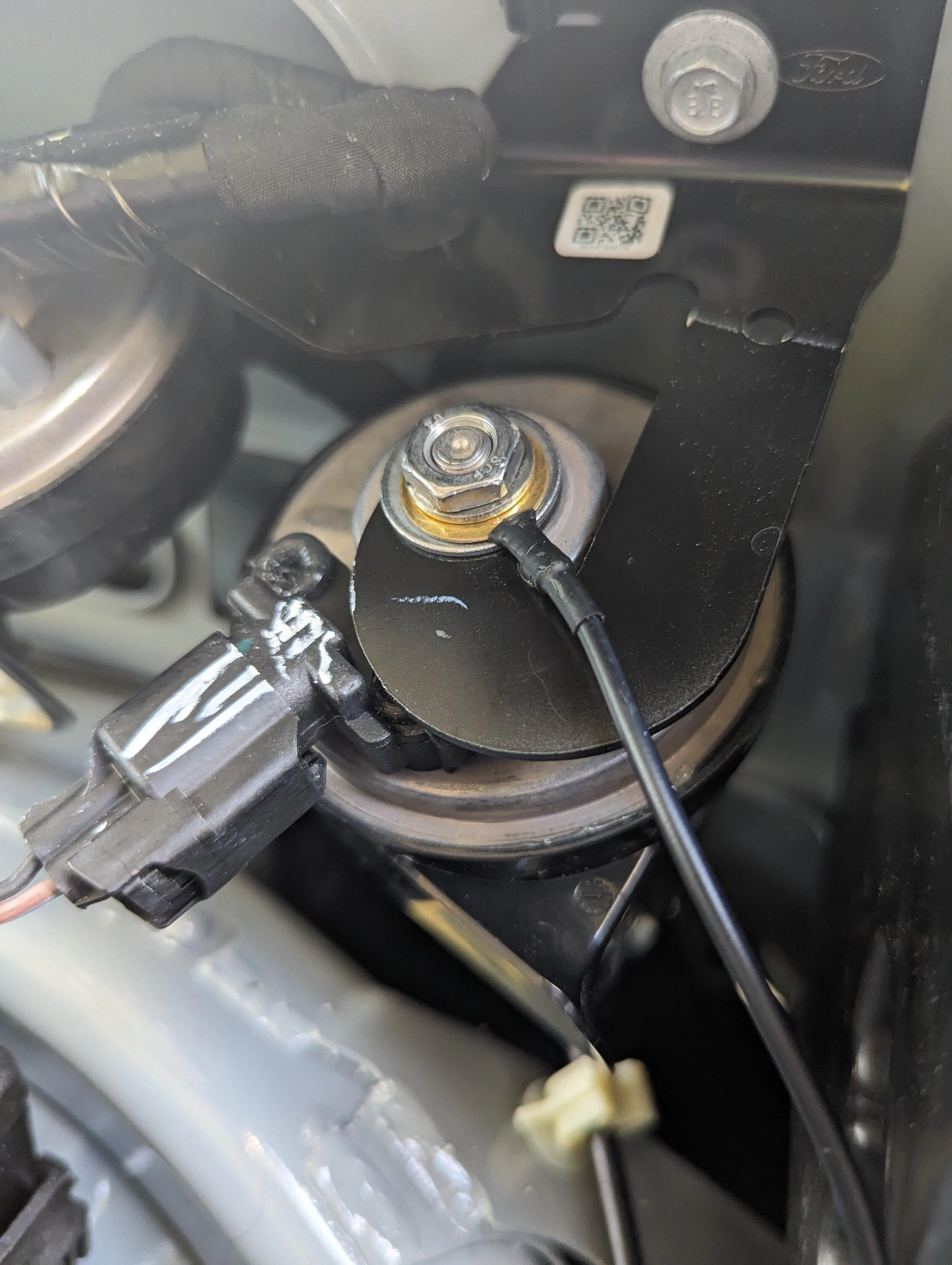

I ended up using the horn as suggested in another video (8, nut/washer/ground/OG washer/bracket). it gets rid of the EMI (yay) but am wondering if another hybrid owner has tried a different location.

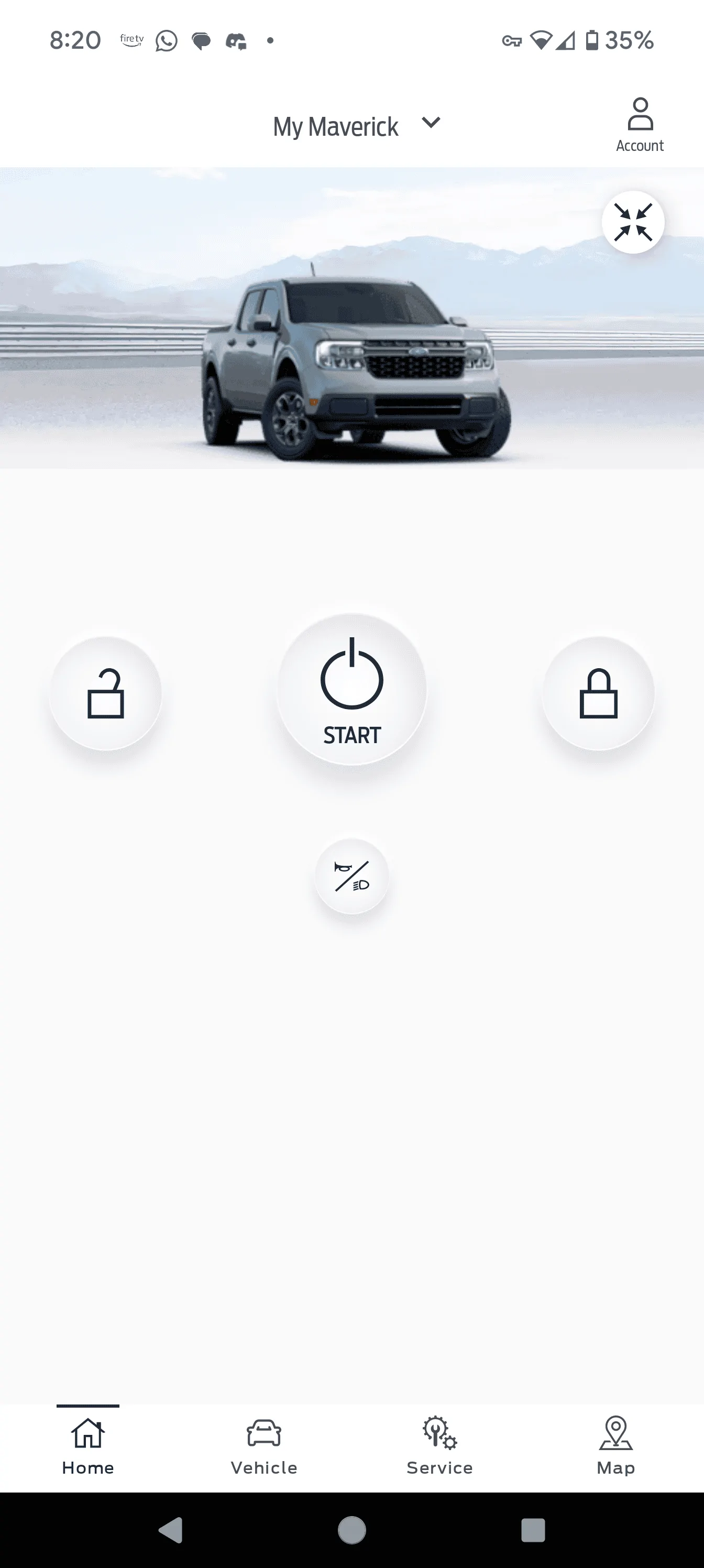

Strange. I went with location one for mine and works fine. Also have hybrid. My problem is my lightbar power-switch has a small LED (red off, green on) that is now constantly powered since I got power from the jump post in the engine bay. This results in FordPass app telling me it's shutting off useful features like remote start. I tried pulling power from the drive side blinker but don't think it has enough power for the light bar as the bar cuts off after a split second. Where are you getting power from for yours?

Hola! Same power source as you, positive jumper post, with that always on LED. terminal post to have it more snug. However no issues on the Ford Pass. I double nut and a washer on the post.
