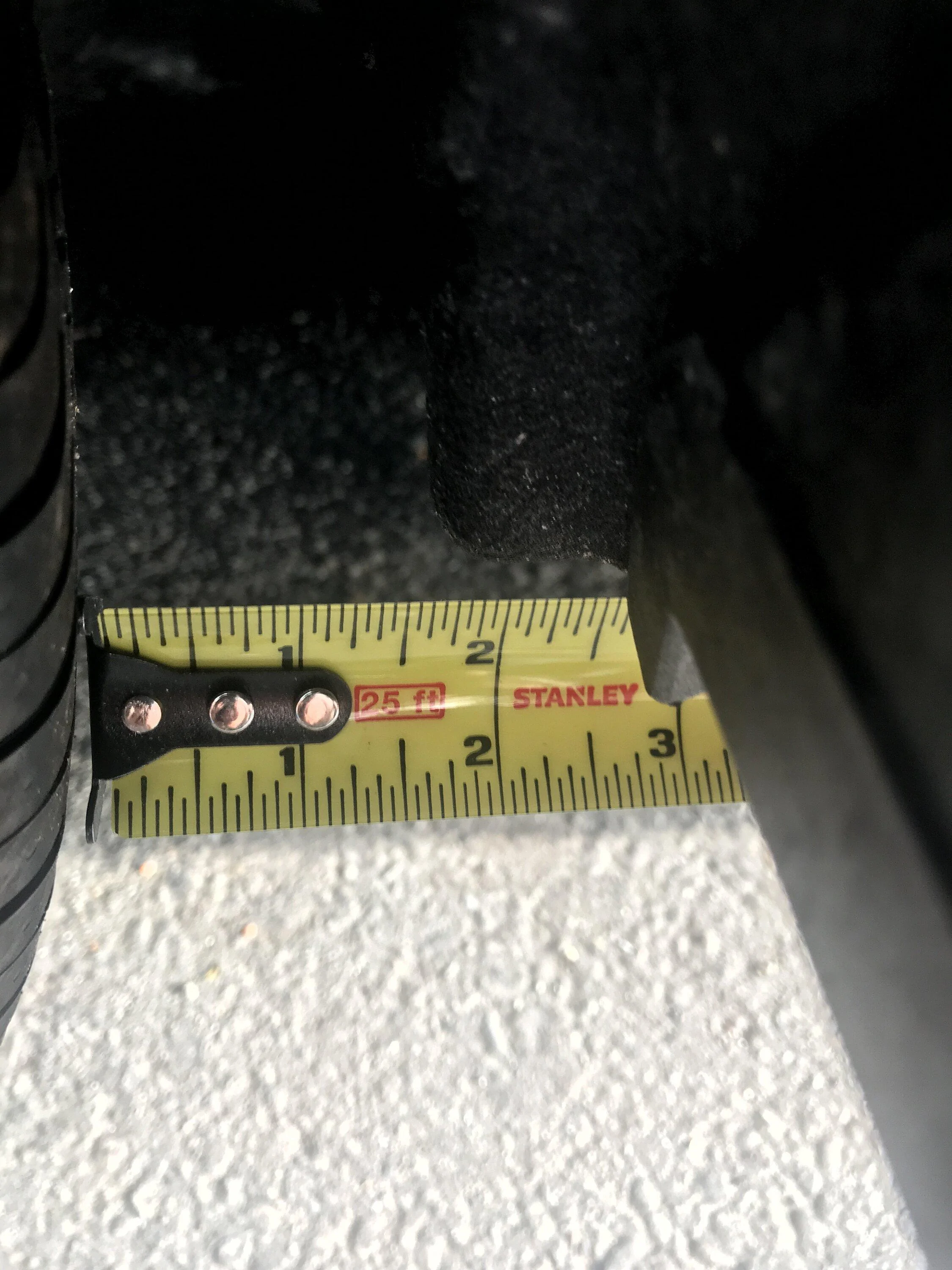

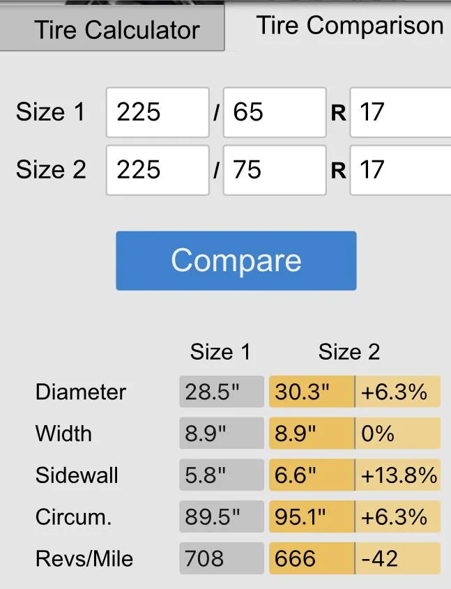

I am thinking of that size as a winter tire on the stock wheel. I like the look and the increased clearance. There is a 1.8” increase in diameter.
I have not seen a single installation in the forum. They are not widely available and would cost a bit more.
Update:

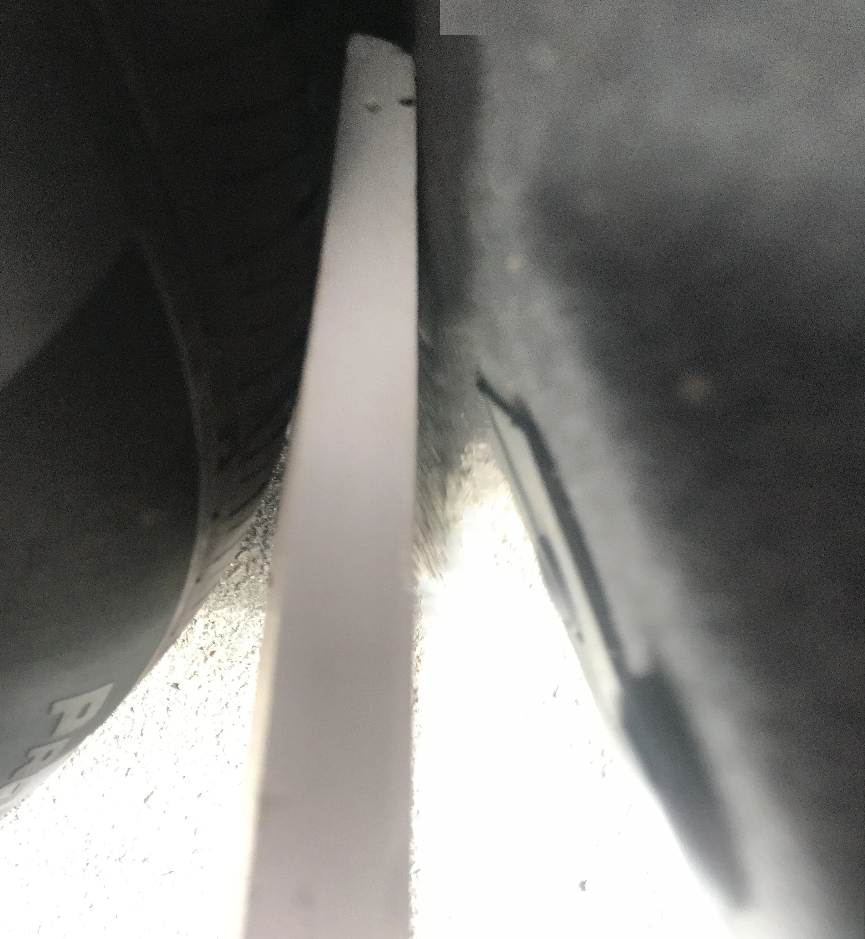

in my opinion it will NOT work without cutting. A 3/4” of lumber barely fit the gap when the front wheel is turned.
please prove me wrong as I really like those tire size.

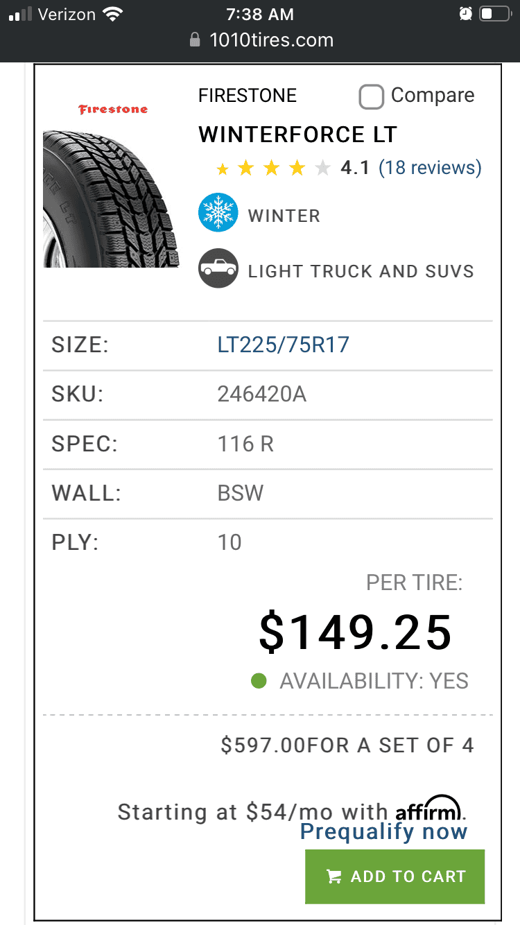

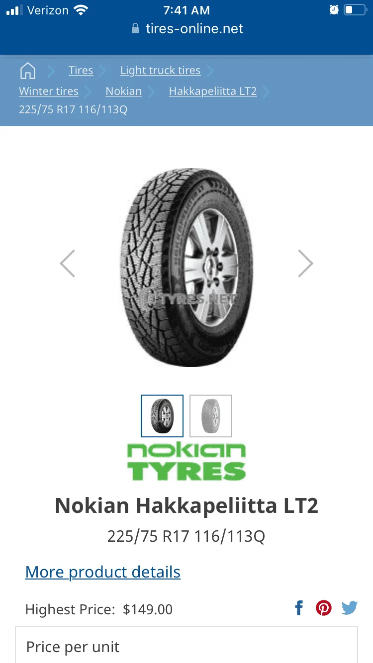

few ..but there are some..
In particular I am interested to the nokkian
