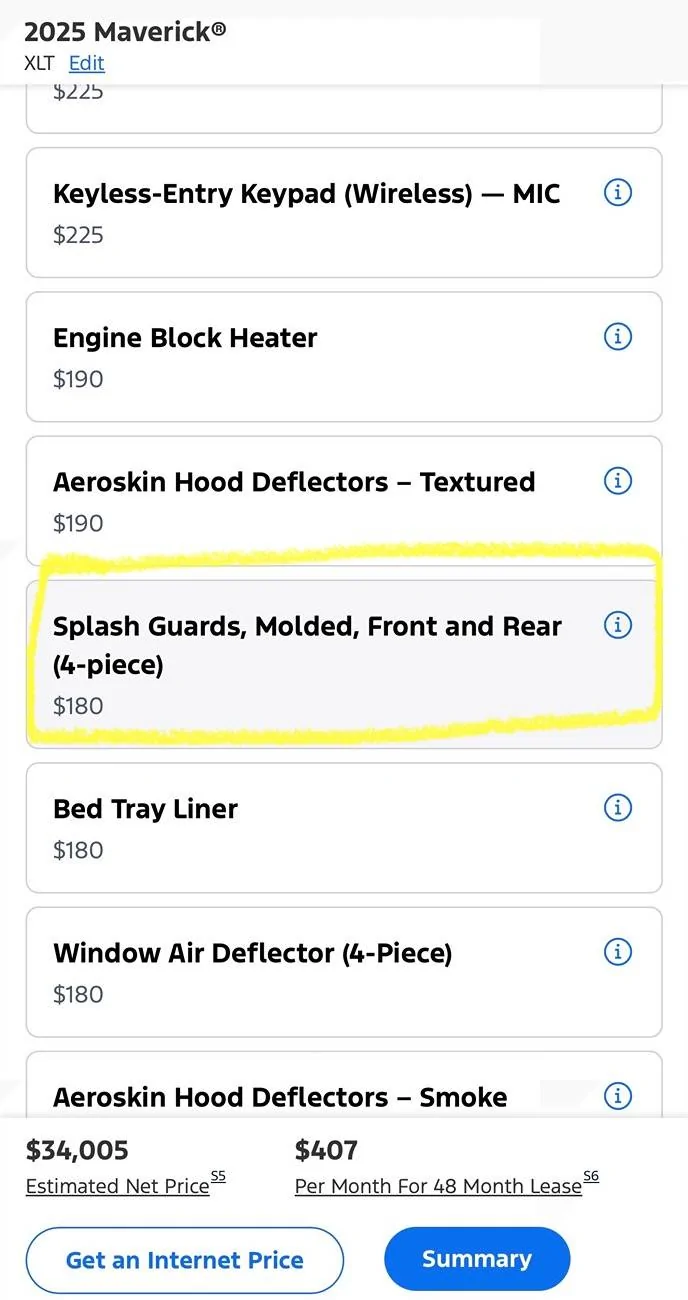

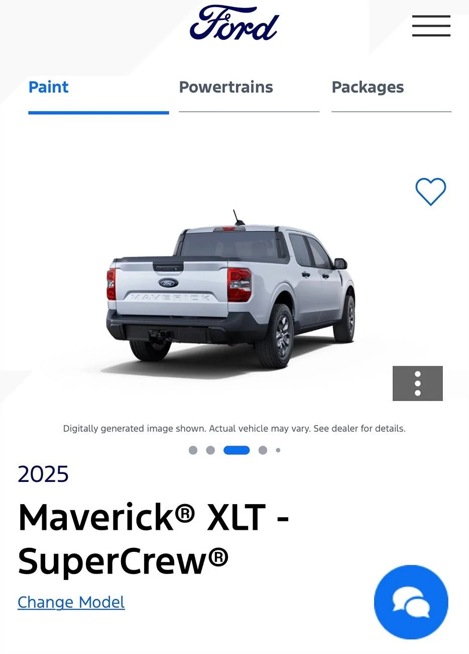

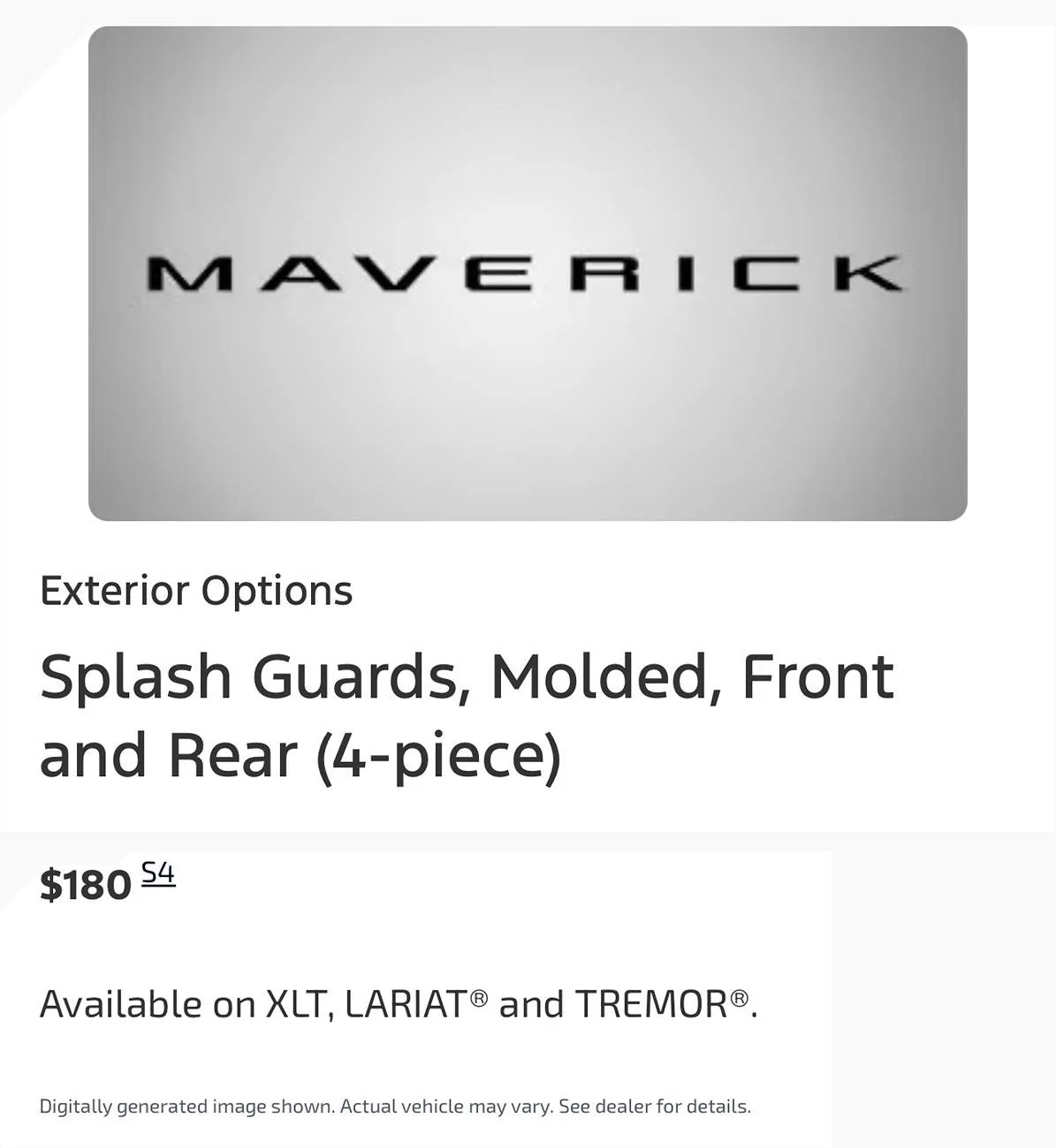

The slash guards are not standard, as shown in the pictures on the Ford website.
Ford Maverick 2025 XLT Hybrid AWD stock tire clearance tight IMG_2023
Ford Maverick 2025 XLT Hybrid AWD stock tire clearance tight IMG_2026
Ford Maverick 2025 XLT Hybrid AWD stock tire clearance tight IMG_2024
Ford Maverick 2025 XLT Hybrid AWD stock tire clearance tight IMG_2025
