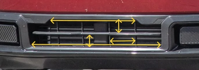

for those who've already received their '25 (if things are different between trim levels, this relates specifically to an XLT Hybrid, AWD), I'm wondering if someone might be kind enough to take some measurements of the openings in the front bumper facia for me? I'm kicking around different ideas for offroa & fog lighting & would like to know what kind of room I"m working with....any of the yellow highlighted dimensions (even better, all little "cubbies") would be greatly appreciated

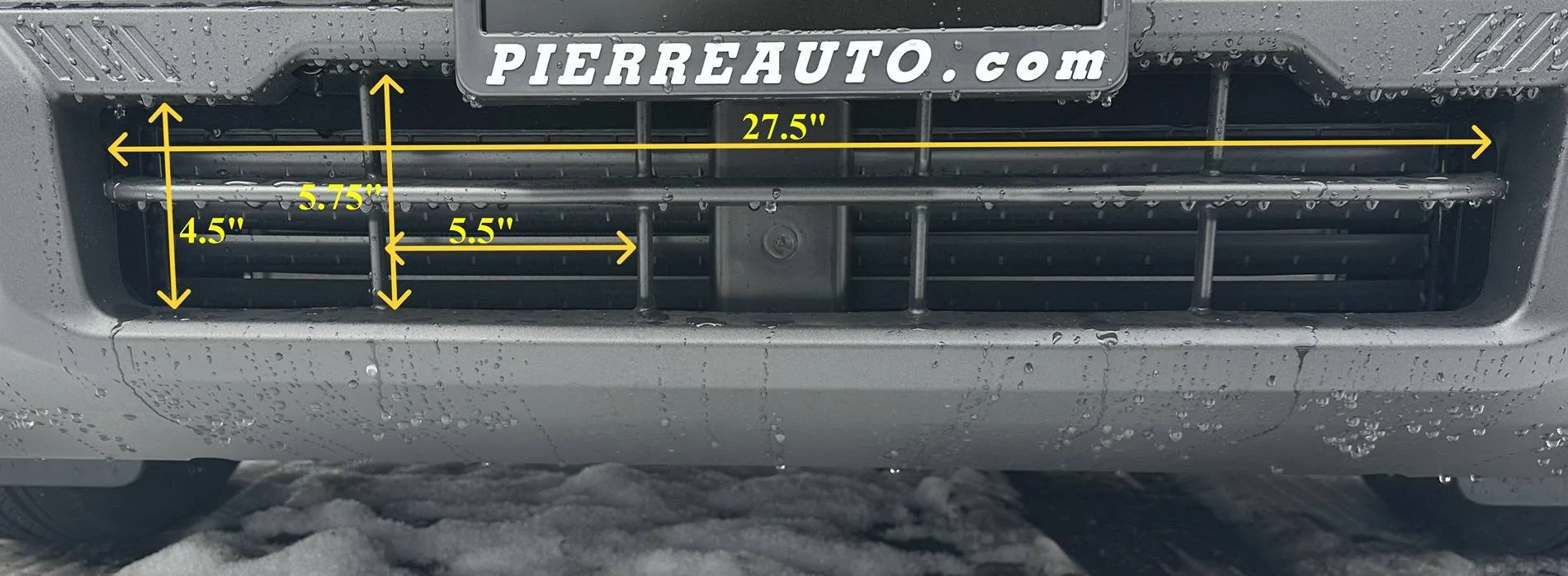

the local stealership FINALLY got a 25 on the lot: here are the *rough* dimensions of the bumper facia openings.
the (6) central openings are roughly 5.5"W X 2.75"H
Upper left & upper right openings are roughly 5.5"W X 2.75"H, tapering DOWN to 2.25"H at the low end
I forgot to measure the width at the wide and narrow portions of the lower left and right, but these measurements should be enough to give some idea of what kind of space you're working with for those wanting to know.
looks like with a little trimming of the central support on the far left and right, the DD SS3's (with total overall height of 3.8" and width of 3.3") will fit just fine (I'll find out, in the future, if the roughly 2-2.5# weight is going to warp the lower portion of the facia, but the plastic seems fairly sturdy & I don't *think* that weight is going to cause any concerns) & with my intent to use the Spod wireless, there'll be no need to do any tapping into the factory wiring at all

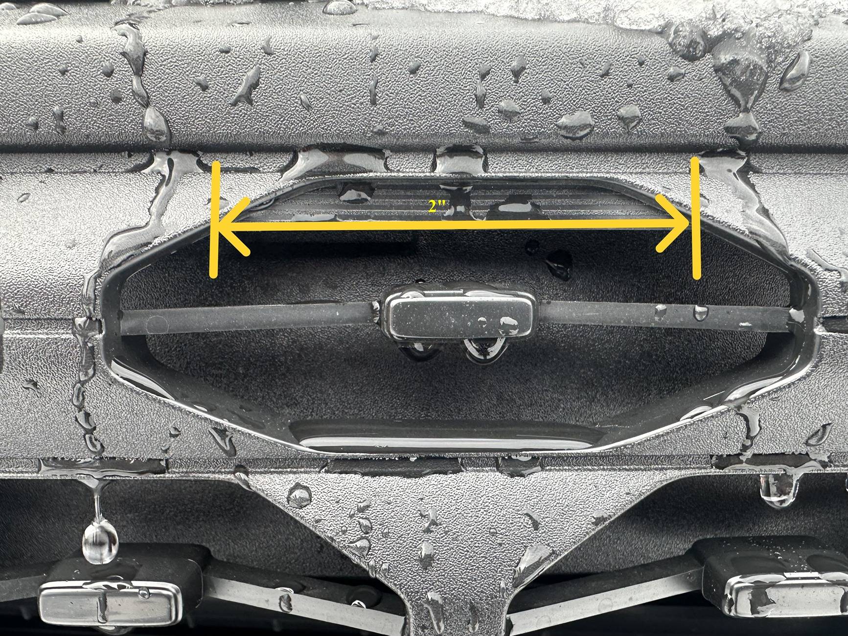

My other concern was that with the newer grille, there might not be an easy solution to installing the raptor style lights from @F150LEDs.
althought they would be angled slightly down (and trust me, that WOULDN'T be an issue as these raptor style lights are freakin' bright to begin with), the available width of the grill openings is about 2": if @F150LEDs were to produce the raptor style lights in a 2" width, with the wiring exiting from the back, I don't think that would be an issue, either
