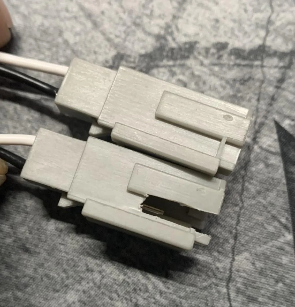

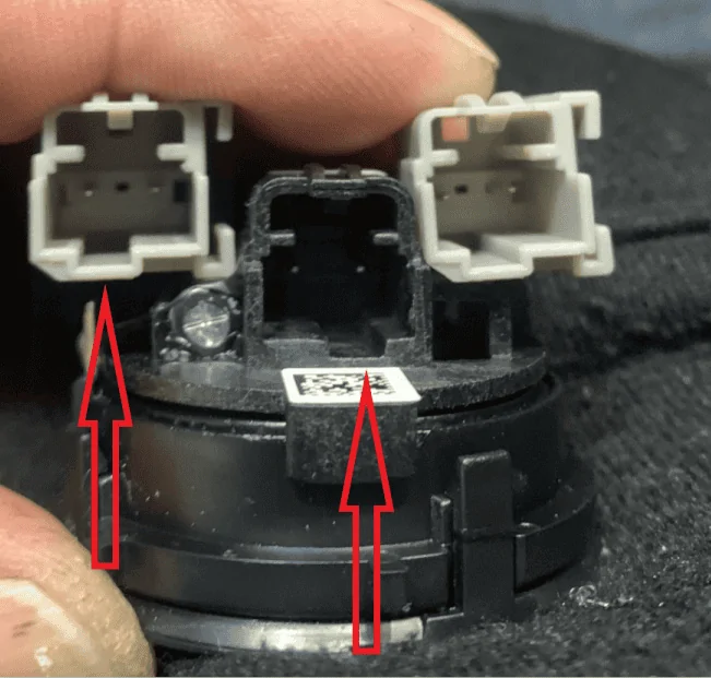

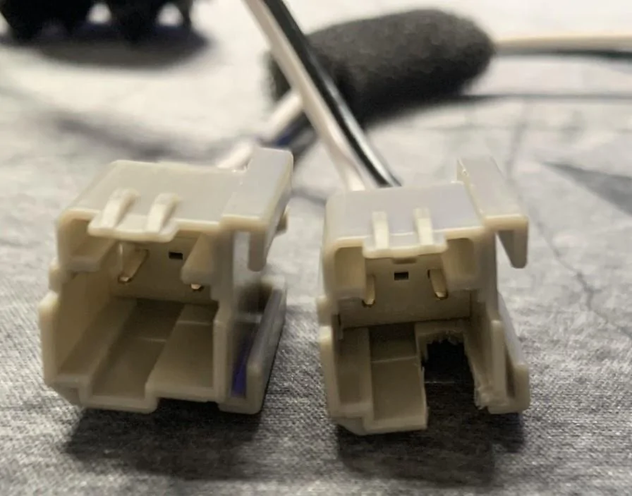

Just installed the Focal RSE 165’s. If anyone decides to buy through Crutchfield these speakers come with plug and play adapters, however, there is an issue with what Crutchfield is shipping. The tweeter adapter is not exactly plug and play. Crutchfield tried to remedy the issue and sent me new adapters but they were the same as the original. I had to cut and trim the adapters and they now fit. Keep in mind that stereo and wiring are my least favorite thing to do, but I managed not to mess things up too badly.

Looks like they send out Metra 72-5603 for the dash (and rear). Is that the one you had?
I have been looking at an amp and speakers for a while and now you have me curious as to what cutting and trimming I may have to do...

Yes, its the 72-5603 that didnt work for the tweeters. The tab on the harness was on the wrong side. I had to trim out the adapter to make it work.

Yikes lol. I guess anyone ripping into their dash and door panels needs to be able to homebrew stuff like that, but I know I would've been "annoyed" the first time I tried to plug that square peg into a round hole.
Good intel. Thanks.

Crutchfield immediately sent out replacements thinking they were packaged wrong, but they were the same.
You also have to splice in the crossover which took some homebrew. Since I had 2 sets of the adapters I was able to make it work with the connections.
