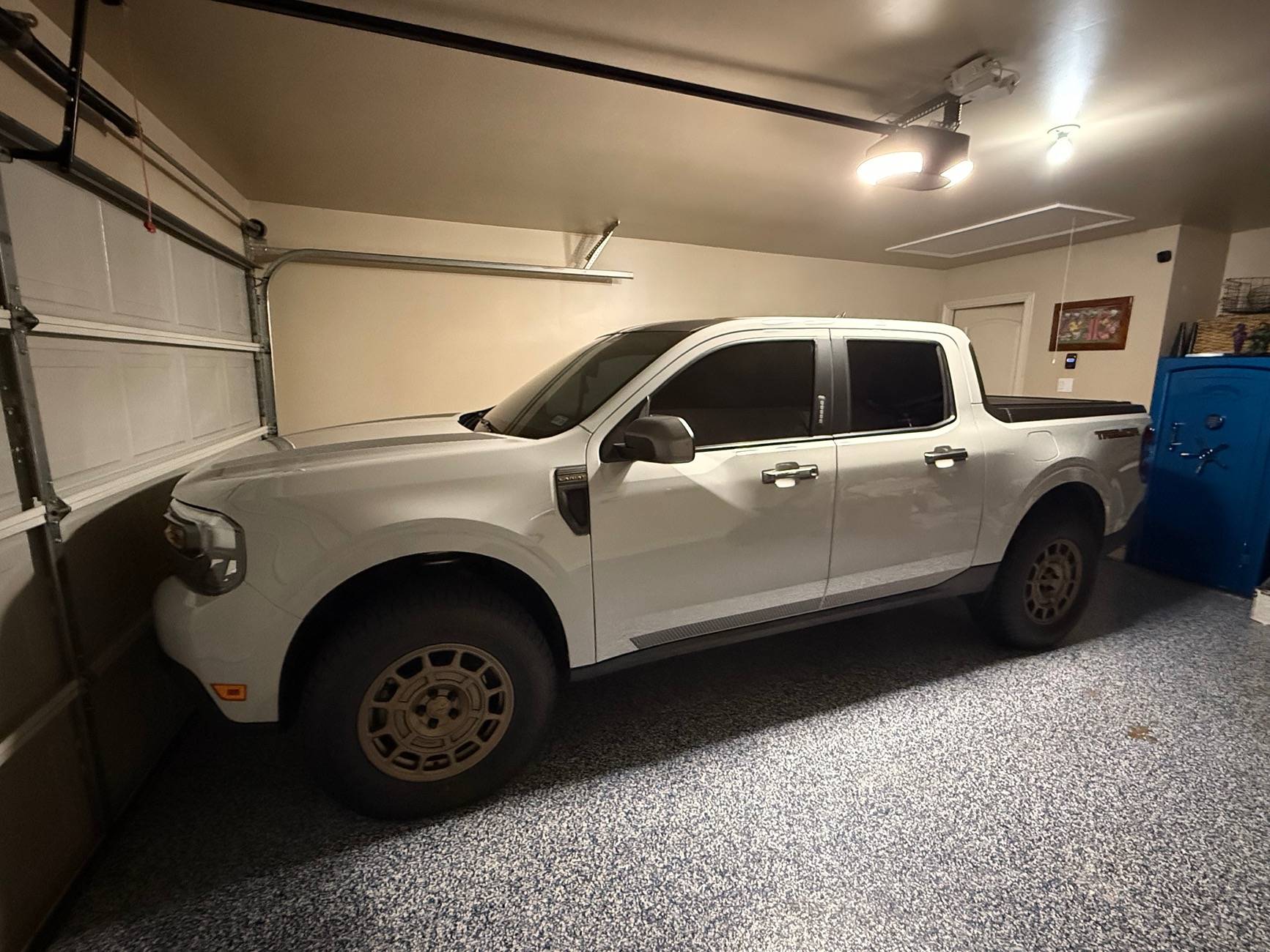

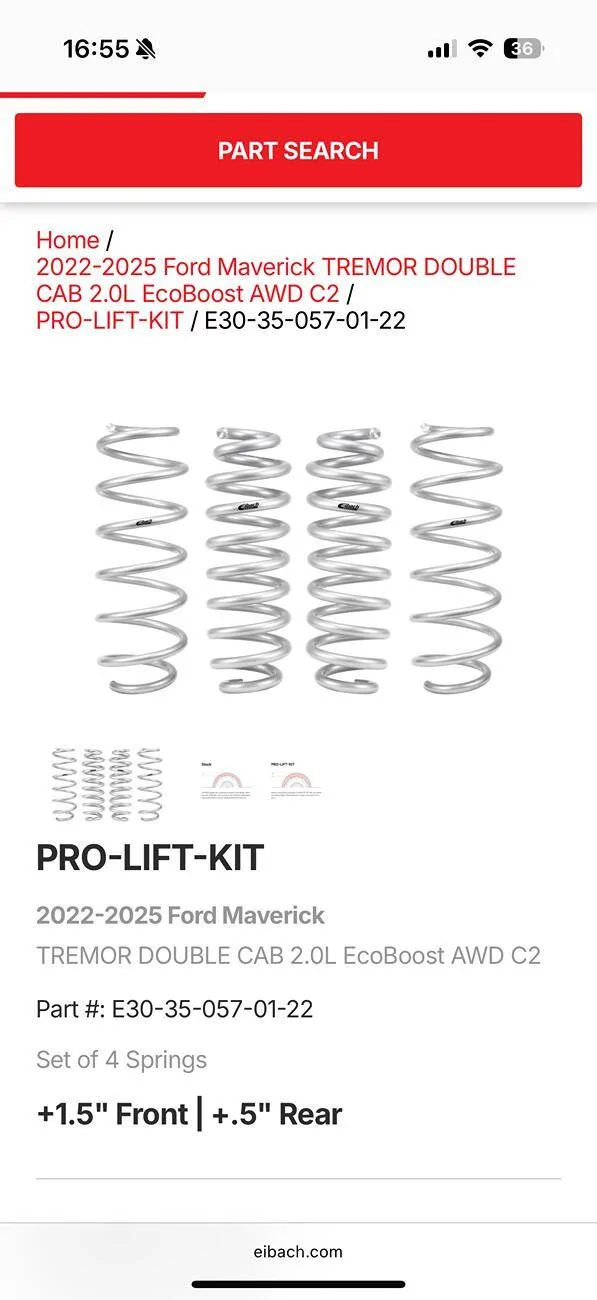

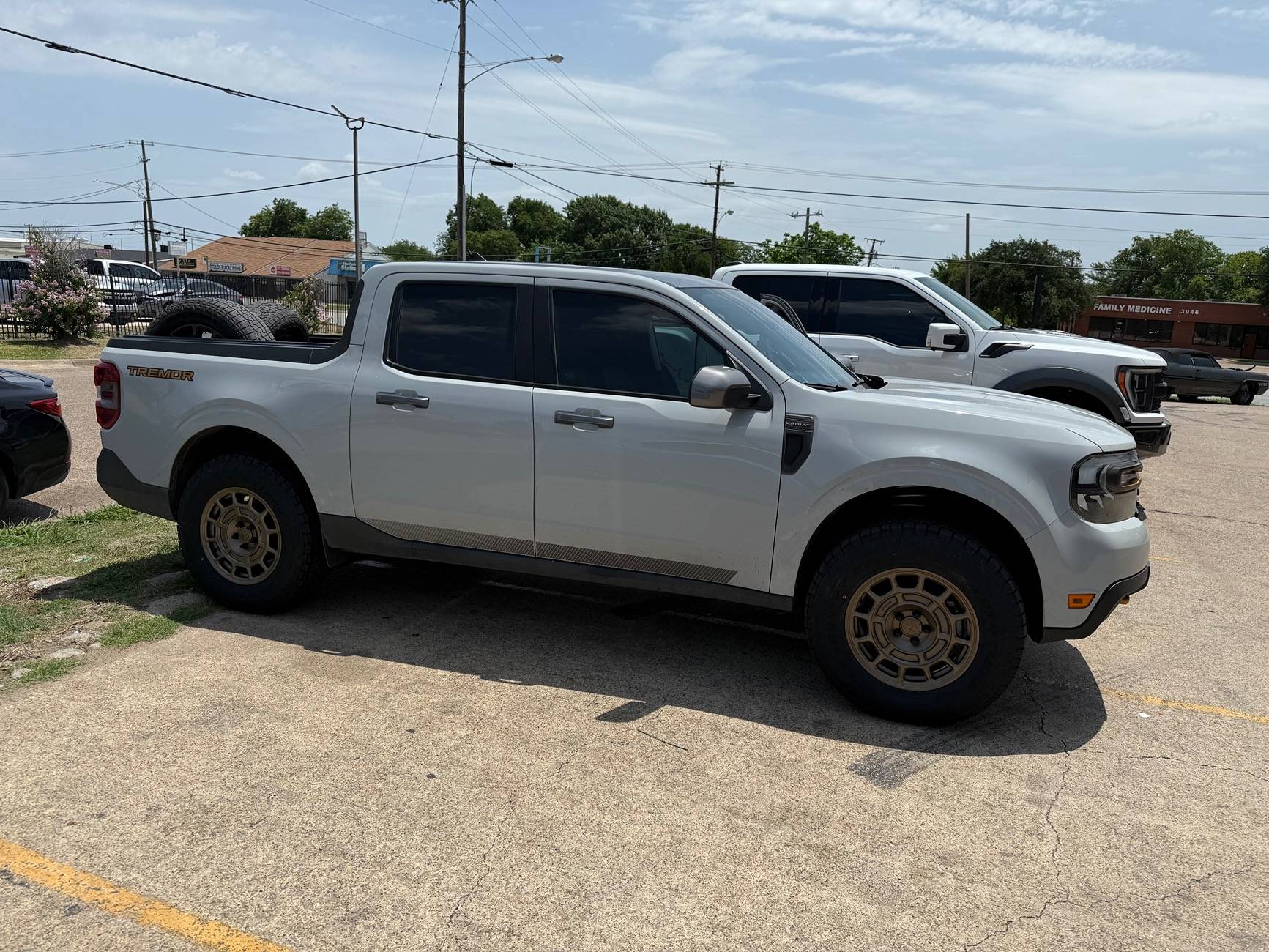

I’m looking to get the tallest and fattest sized tires as possible with my Tremor. Keep in mind, the Tremor comes out of factory with a 1” lift. I added the Eibach Pro Lift Kit that added an additional 1.5” in front and 0.5” in rear. I do not mind light trimming of the plastic in the wheel well, but I do not want to mess with the pinch. Stock tire size is 235/65/17. I will be buying new wheels, so 17” tires is not a requirement. Here’s my Tremor in Avalanche Grey.

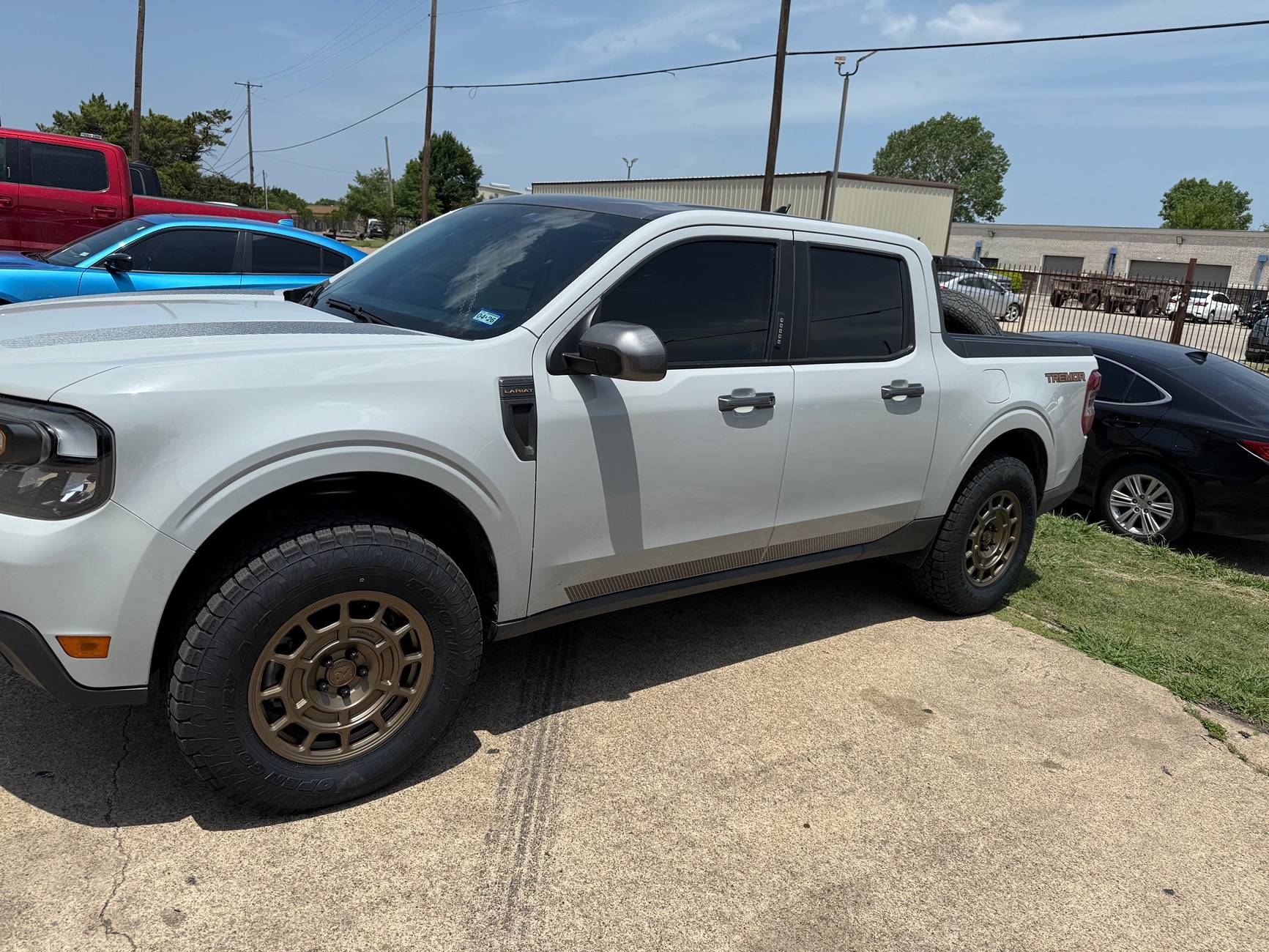

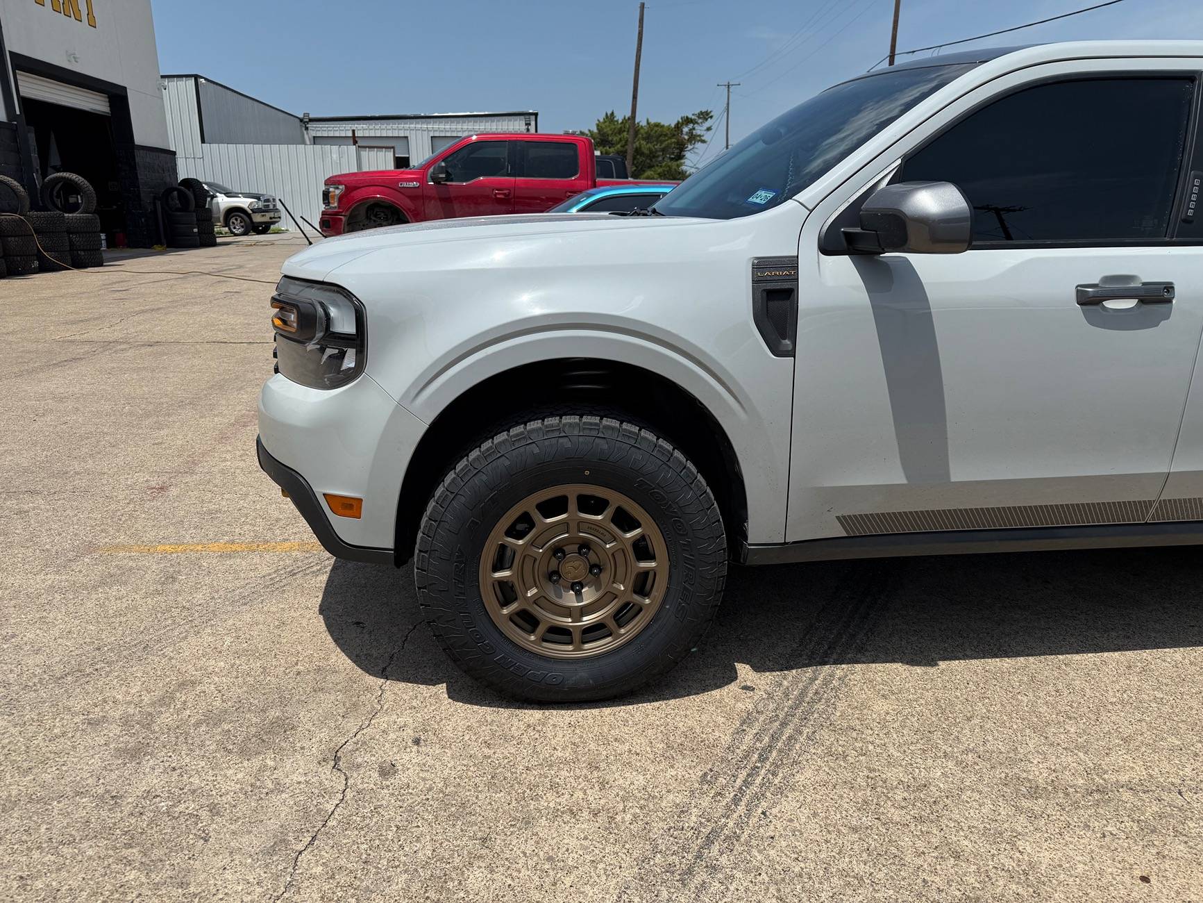

THIS PIC IS WITH THE LIFT INSTALLED , WHAT SIZE TIRE DID YOU END UP GOING WITH ?
Cancunbadlands
Cancun
Jul 5, 2025
3,988
4,128
Cancun
245/65R17 or 235/70R17 is the biggest you can go without cutting or welding required, play safe!
