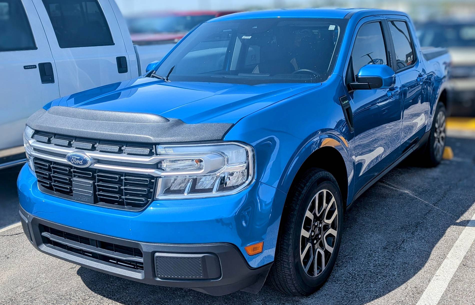

Just picked up my 2022 Hybrid Lariat, 35 days at the dealer, after having the Engine replaced under CSP 23N06.
I just realized my last $870 payment is today as well. Had the 0% for 36 months with 0 down.
Nice.
So you actually got the codes showing a problem might have been on it's way?
Did they actually clean it up for you, or is that a filter I need to find - shiny car filter?
Yes. It went into limp mode while driving and had error code P1061.
Had it towed to the dealer, and they confirmed the error code and found metal in the oil filter and pan.
I just used the Dynamic mode and portrait in Google photos to blur the background a little.
They washed it, it's still pretty shiny even though the ceramic coat I put on was 3 years ago.
