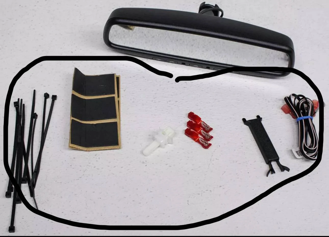

The only thing you use is the wiring.
It plugs into the mirror and the you trim off the excess, strip the ends and follow the instructions.
The whole thing takes 20 minutes.
The only thing you modify is that you use a file to make a gap in the black cover, for the wire to go from the mirror up into the black cover above the mirror.

That’s great. I think you will be impressed with how well the installation goes and how well the mirror works.
