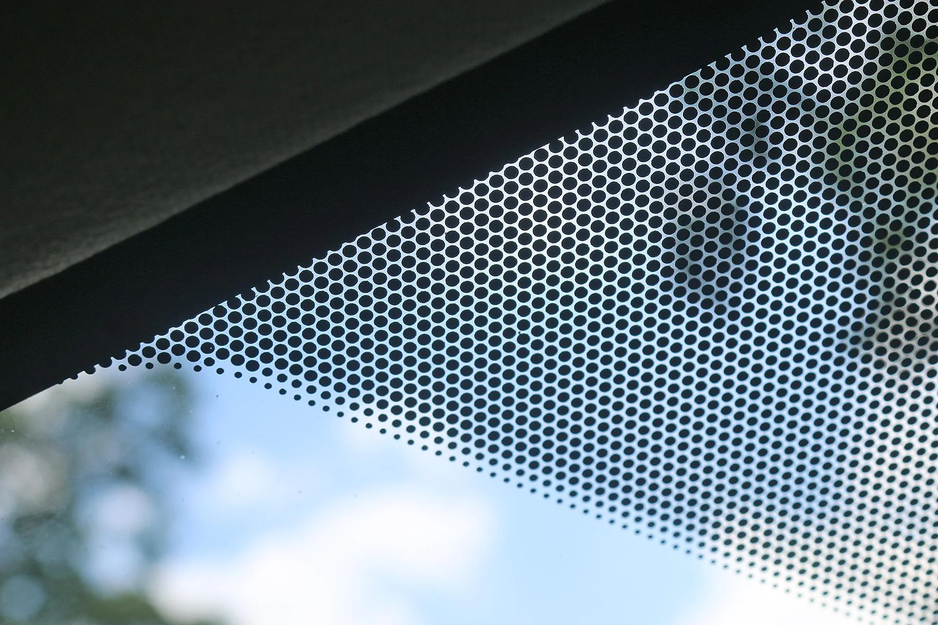

like this?
Ford Maverick Windshield With Small Dots dots
jsus
Dec 20, 2021
2,885
3,886
2022 Ford Escape Hybrid AWD
like this?
See also: they're called frits.
https://jalopnik.com/heres-what-those-little-dots-are-on-the-edges-of-your-c-1791075995
The “dot-matrix” you see on windows is a halftone pattern, serving an aesthetic purpose. The pattern simulates a smooth gradient by gradually decreasing the size of the solid black dots as it moves inwards. This provides a more visually pleasing transition from the black frit band to the transparent glass.
UPDATE: An engineer with Pittsburgh Glass Works contacted me to point out another, more important purpose for the dots! He told me that Windshields are bent in a hot oven (like the one seen here), and that, because the frit band is black, it tends to heat up faster than the transparent glass. A sharp thermal gradient between the frit and the clear glass can cause optical distortion, or “lensing,” so faded dots are used to help create a more even temperature distribution, minimizing this distortion (and also hiding it from view).
On modern cars, there’s another group of dots on the windshield right behind the rearview mirror. As shown in the clip below, these dots, called the “third visor frit,” are there to help block the sun as it beams in from between the two front sun-visors.

This is not the dots I'm talking about these are all over the windshield and you can't see them unless the sun hots them at an angle.
Can you get a picture of what you're seeing?
