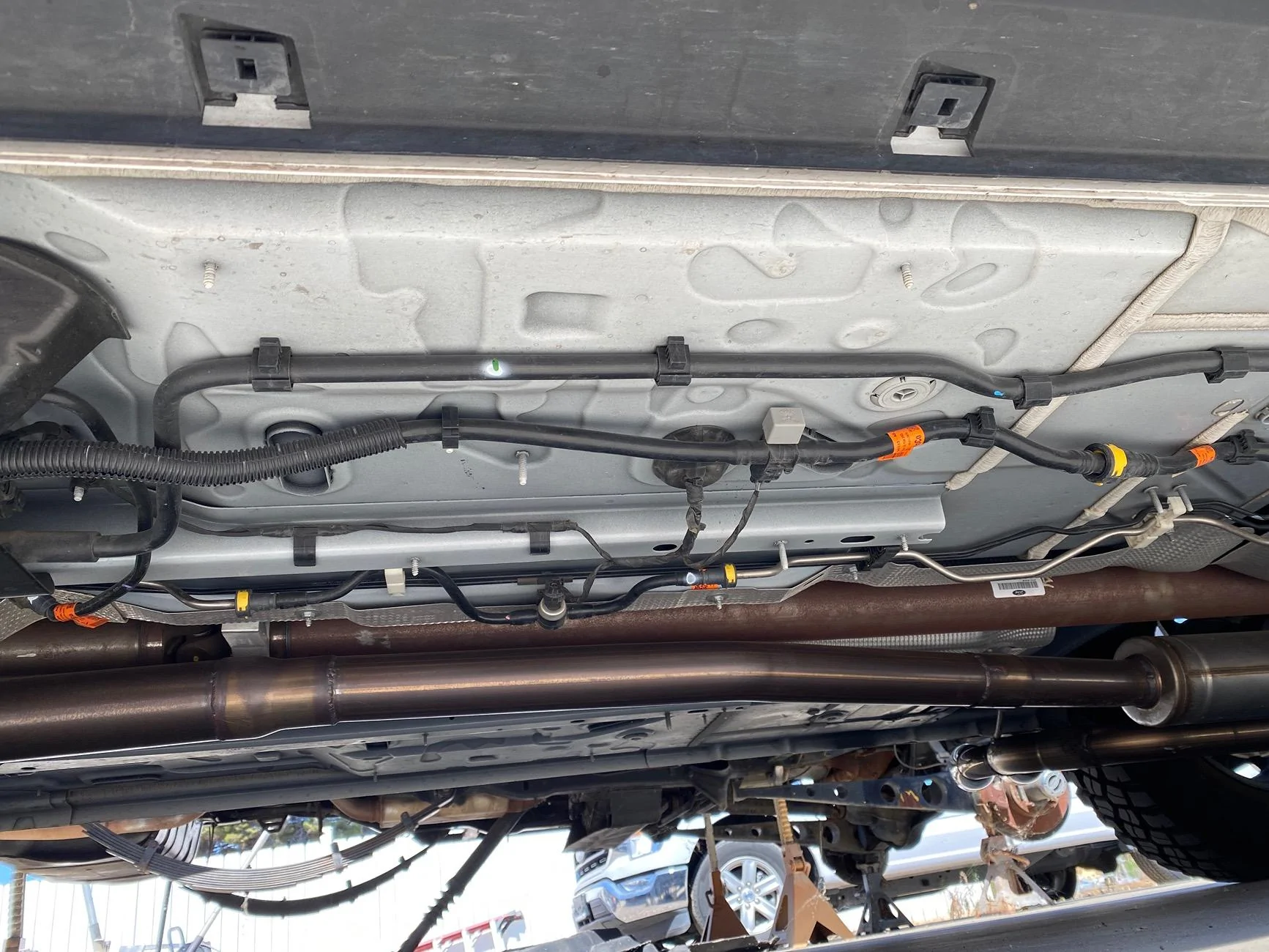

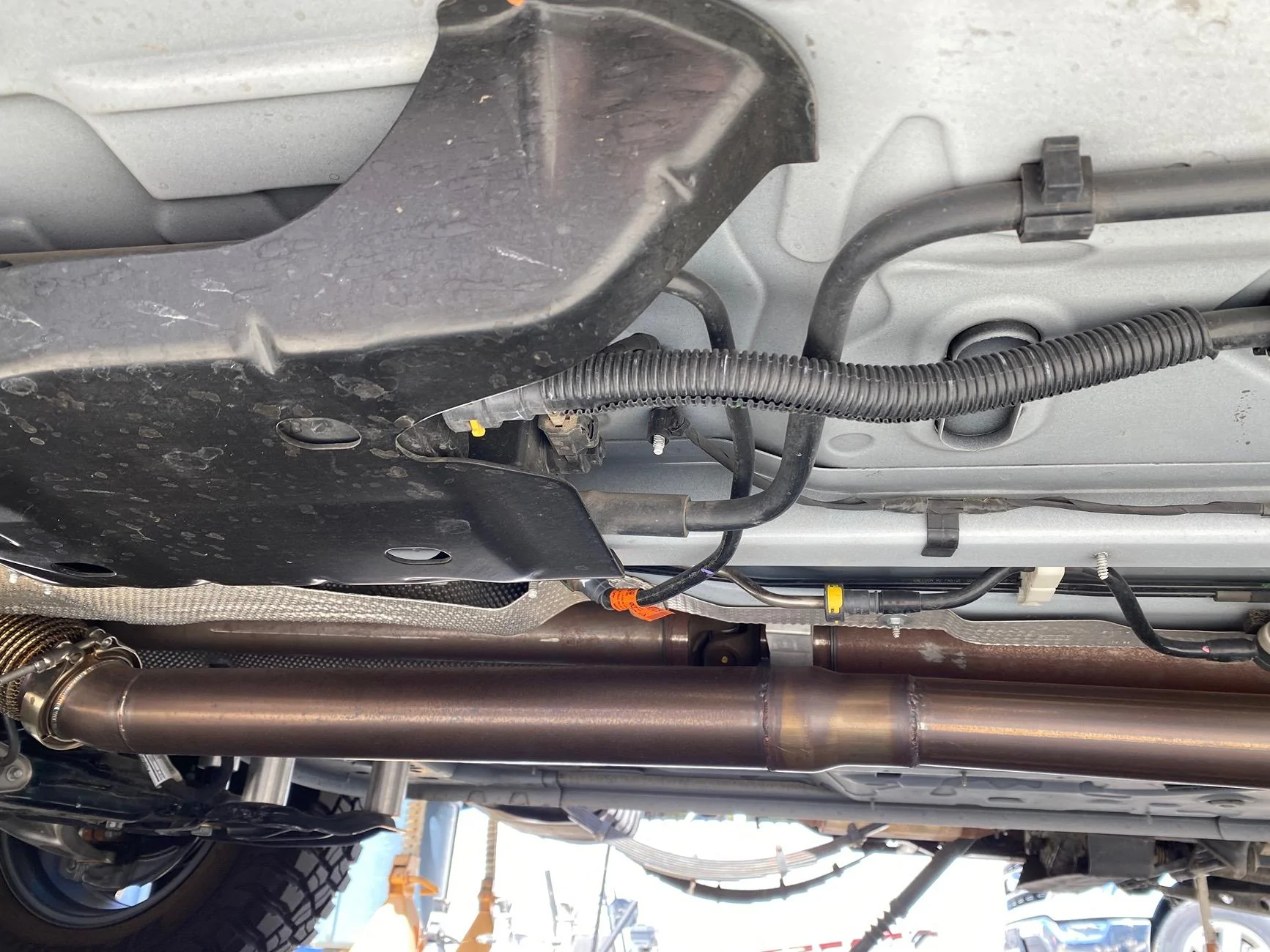

Under footwell area is gas evap canister , under seat area is a few plastic gas evap lines , fairly open towards seat rail on outside.
Ford Maverick What is under the Driver's Seat Carpet- 24 Lariat IMG_3811
Ford Maverick What is under the Driver's Seat Carpet- 24 Lariat IMG_3812

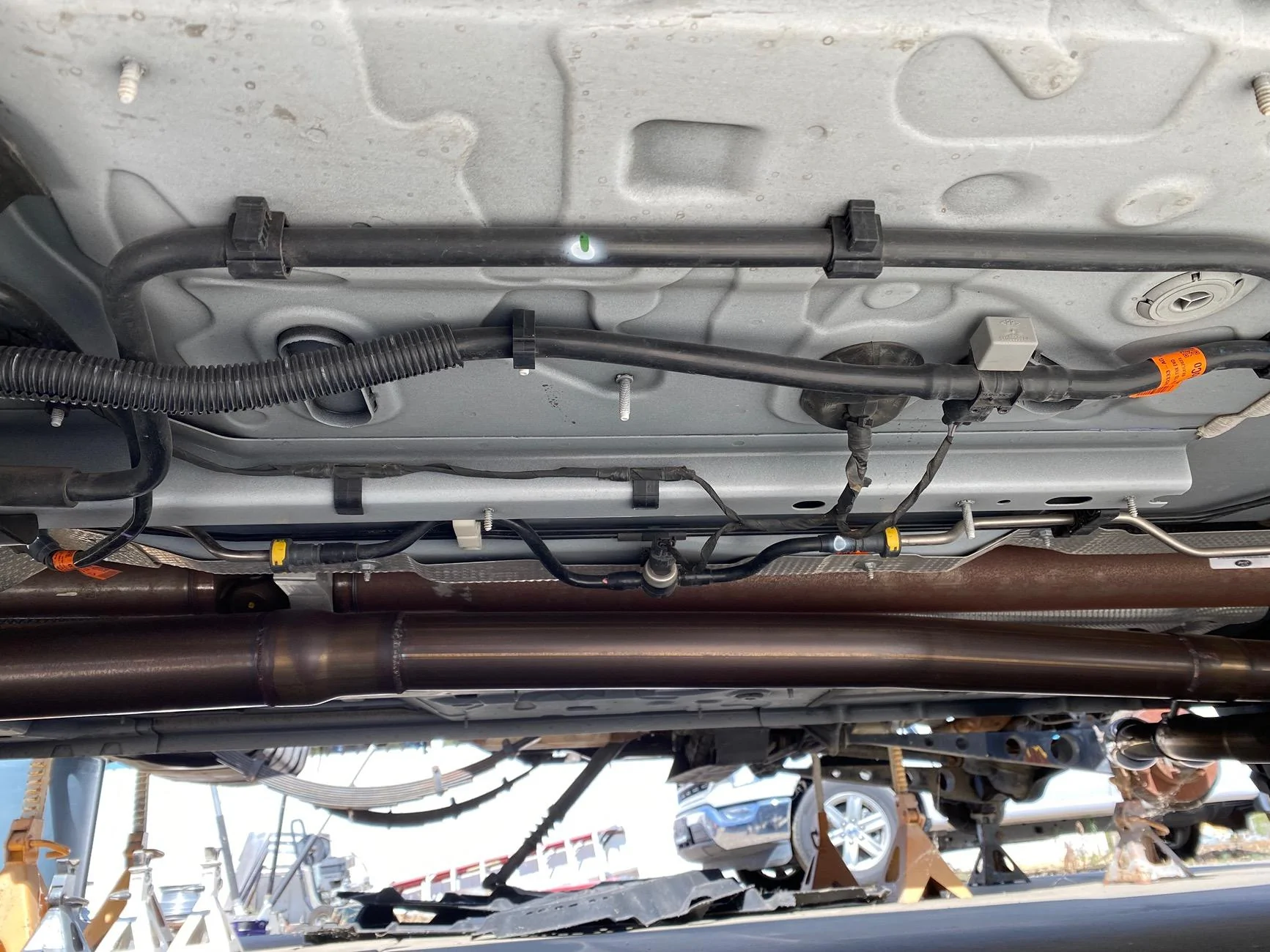

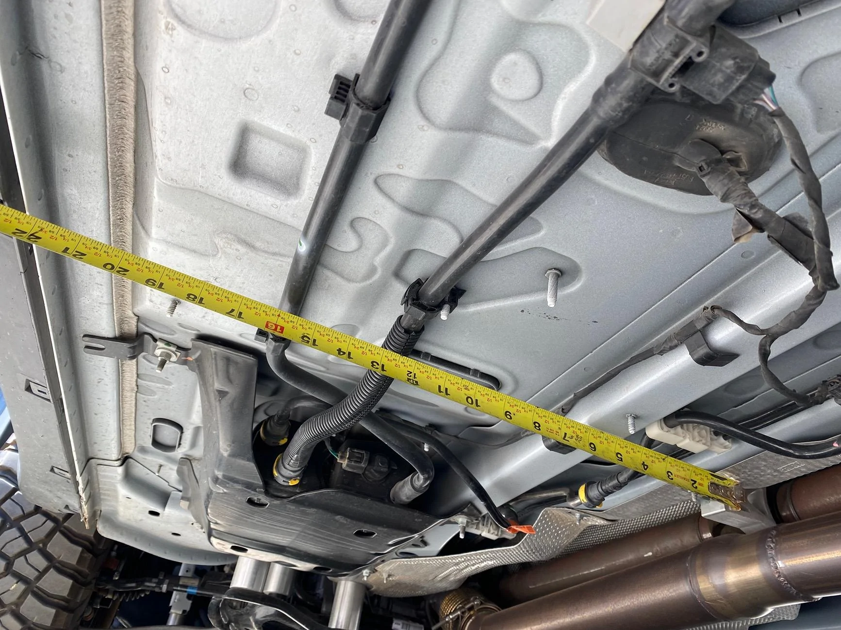

Here is better pic with tape across flat part of floor
Ford Maverick What is under the Driver's Seat Carpet- 24 Lariat IMG_3814
Ford Maverick What is under the Driver's Seat Carpet- 24 Lariat IMG_3813
the high pressure fuel lines are on inside by the driveshaft(awd) and exhaust tunnel.

Thanks Bwicka - I could not feel anything under the carpet and pad on the top side - Thanks for the pictures of the underneath - Makes things easier for me.
Thanks again.
