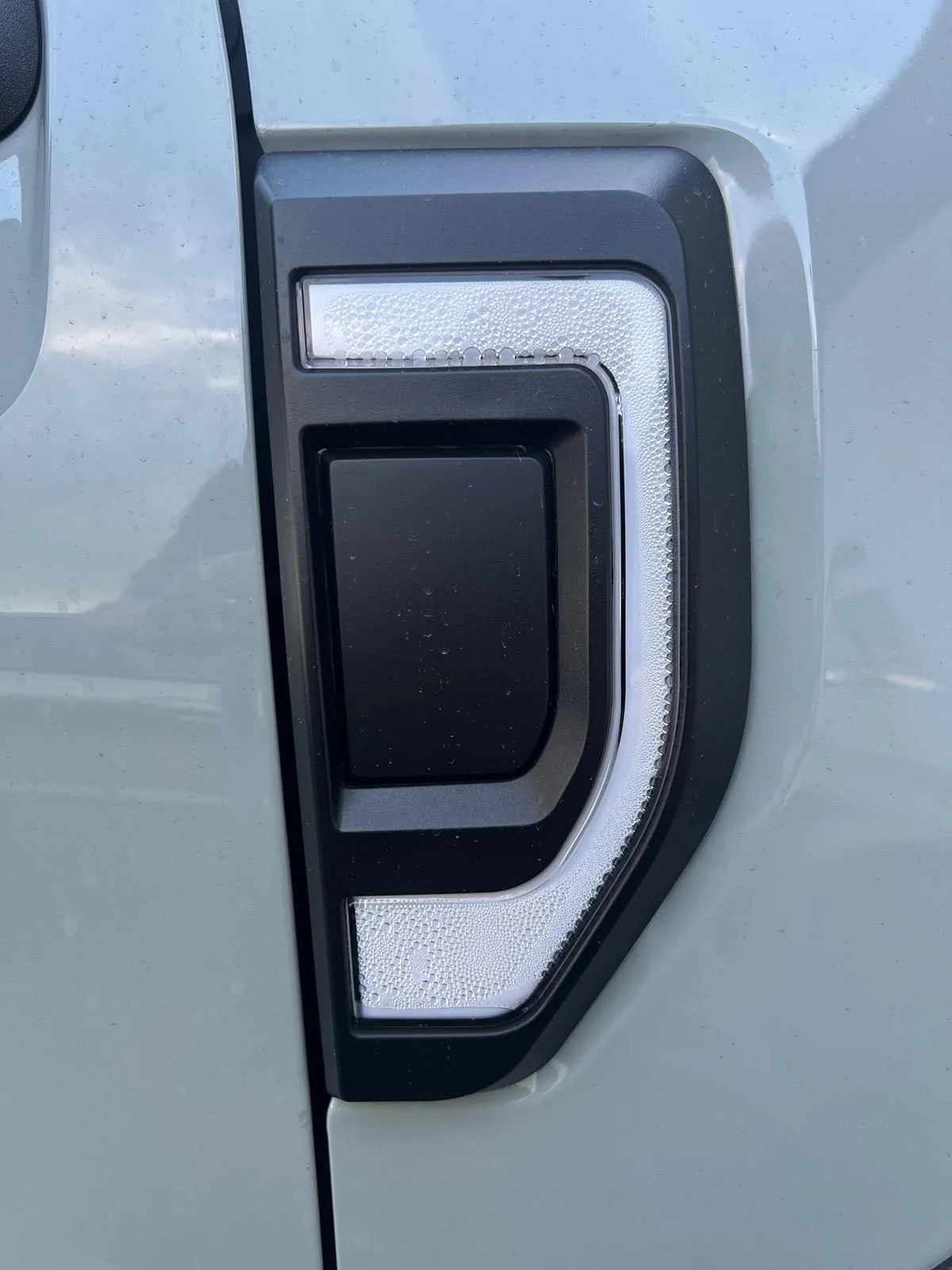

Is the condensation issue fixed on any new orders from Amazon, or are you replacing their light with another dysfunctional light?
I'm considering buying this from Amazon, but I live in Florida and the water damage worries me.

There obviously is a seal problem in production that is happening. Whether it is on the front or back is the question. If it is the back, silicone sealant will fix it. If it is the front, silicone won't work and will look horrible.

I actually had to remove the foam padding behind to reveal some of the screws. Had to remove one of the clipthat’s blocking one of the screws.
once screws were undone, you can lift the black accent to reveal the clear housing. I noticed that the sides of this housing has some gaps, I ended up applying silicone all around it on both side marker lights.
I opted to add some silicone to where the 2 screws were passing thru the clear housing.

As a replacement for the foam padding that I removed initially. A bit thicker but still works for me. Just had to cut it accordingly.

It looks like the lense pops in the front. My hypothesis at the moment is the seal behind it might not be placed correctly. Maybe pop it out as silicon and put back.

I still haven’t tested mine yet as I’ve just installed it yesterday. But I’m hopeful that what I did would prevent condensation in the future.
