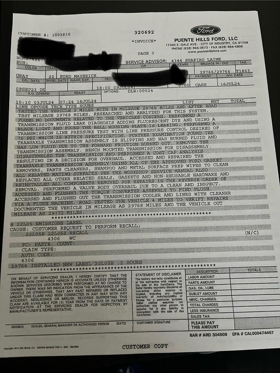

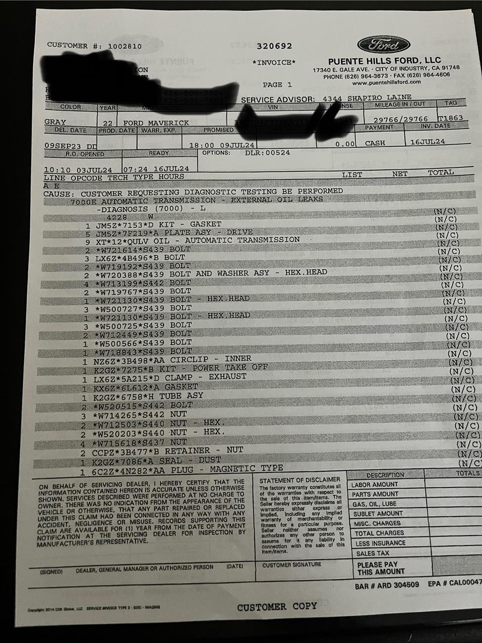

Update to my post about my Transmission pan nuts being loose and there being a fluid leak, Ford Service had to pull the Transmission and put a new valve body in it, They flushed the entire system, They did it in less than a week and all under warranty

Sounds like you had a good tech. Awesome.
