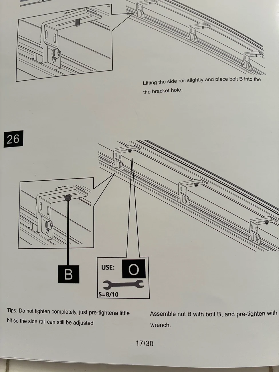

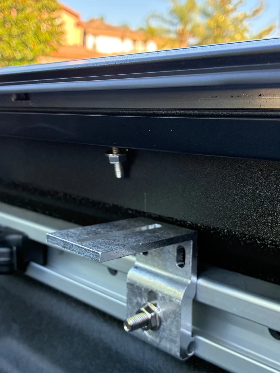

I just got the Flowkottu Cover for my 2025 Lobo with the factory installed bed rails. I know I used the proper brackets that were in the box, but the bolts are too short to attach the Cover Rails to the Bed.

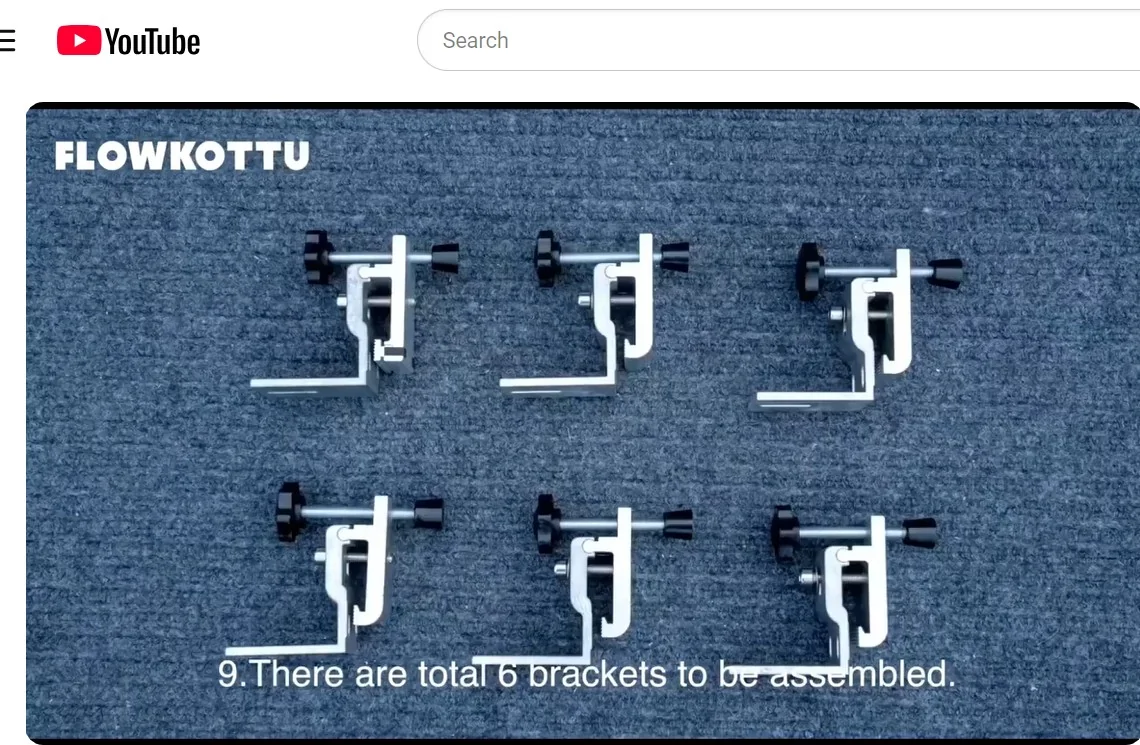

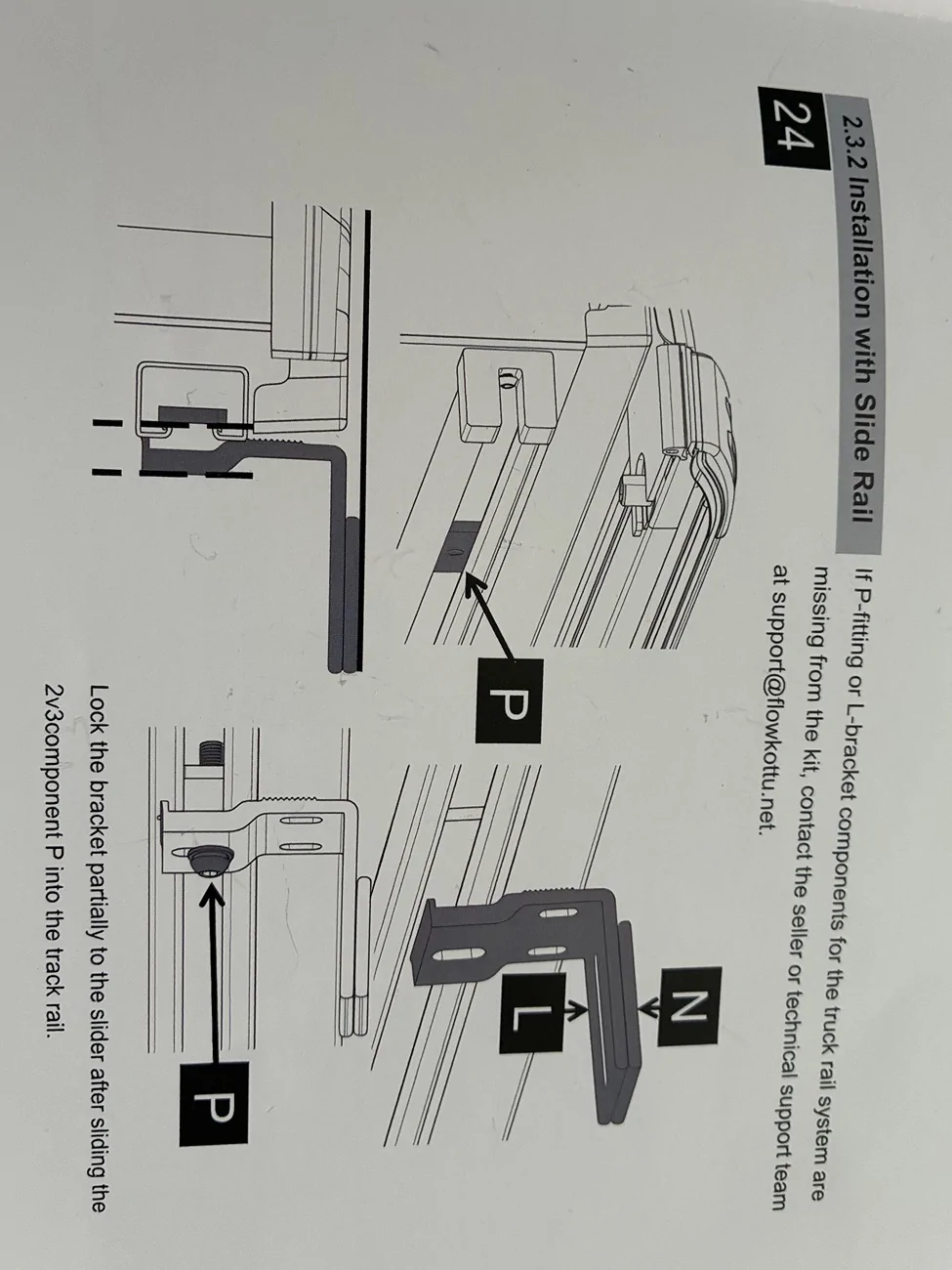

Those clamps don't mount to the cargo cleat rails. There are other parts that get assembled to that bracket, then "squeeze" the truck rails.

I'm curious, do those instruction say Ford Maverick anywhere, or are they generic?
