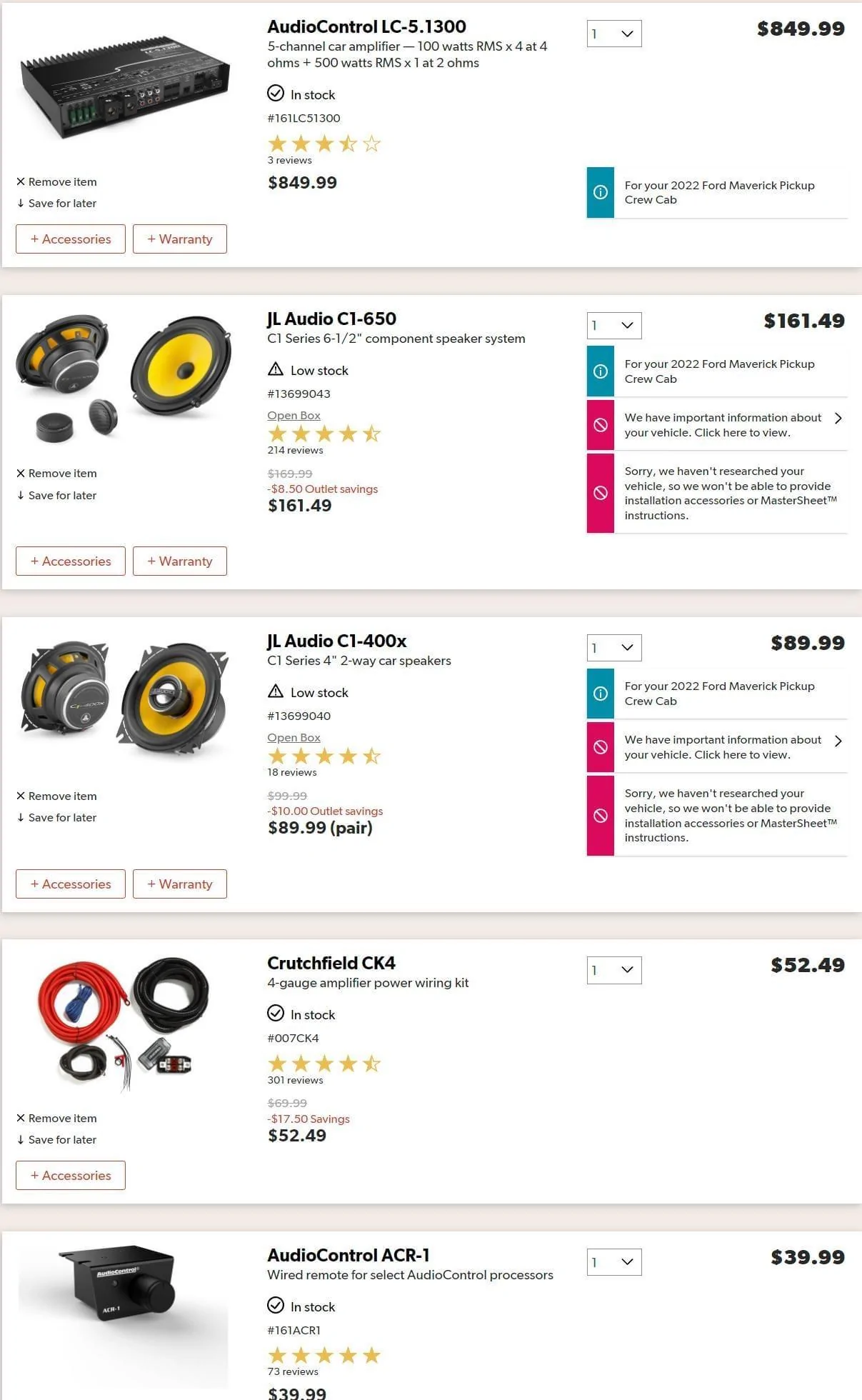

Thoughts on shopping list??
btg321
Brandon
Nov 26, 2021
Colorado Springs
Maverick XLT
FIgured this would be a decent setup. I already have a JLw3 12 slim I’m going to find a spot for.

Love the 5.1300, but my first thought is if you’re going that route (and paying up for it), I personally would go with speakers that handle more power, but that’s just me…
Do you have a wiring plan yet?

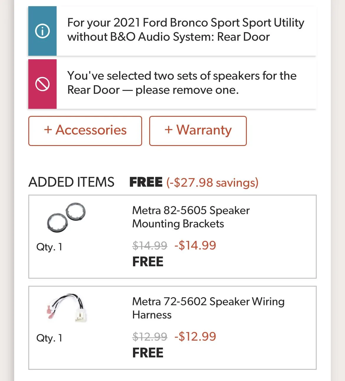

One suggestion is change your vehicle on crutchfield to a 21 bronco sport so you can get the free wiring and speaker adaptors… last thing, on that “12, likely the only place you’re going to be able to fit that is in a wedge style box behind the rear seat (and depending on model/trim/options may have a harder time fitting it than others)
