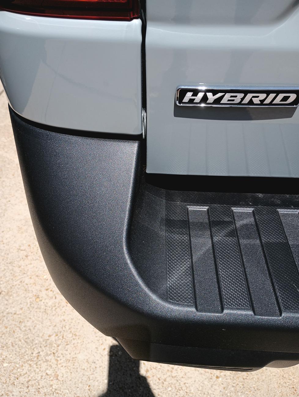

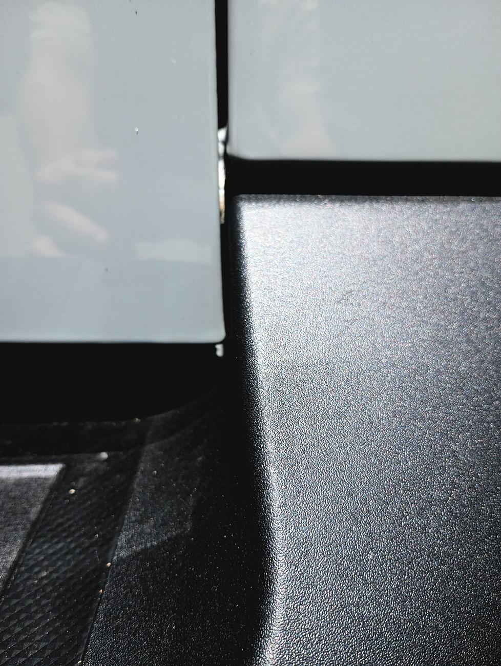

Tailgate rubbing bumper can it be adjusted
Midwest2nd
Jul 7, 2024
Missouri
24 XL Hybrid Co360 hitch
Received 24 xl hybrid about a month ago, asked dealer to look at where the right side tailgate is in contact with bumper on passenger side. Not touching on driver's side. Gap at top of tailgate is slightly less on passenger side versus driver side. They sent off pics to Ford but no response after 30 days. Is this normal for a Ford response?
My first posting thank you for this wonderful forum.
Ford Maverick Tailgate rubbing bumper can it be adjusted IMG_20240707_122028354
Ford Maverick Tailgate rubbing bumper can it be adjusted IMG_20240707_122041467
https://www.mavericktruckclub.com/f...t-of-tailgate-hinge-yes-it-can-be-done.41972/
Another forum member shared the same issue and how they fixed it. Could help if your handy or to pass along to dealer

Thanks for the link. I saw that one. I have forwarded to the dealer via email. His was in and out on position mine is more side to side but it definitely helps.

OP, was this fixed? Can you confirm how this was fixed by the dealership?
Midwest2nd
Jul 7, 2024
Missouri
They sent it to their body shop guy down the street. I don't know what exactly they did but spacing is equal now on both sides.

I have this issue on my ‘24 XLT BAP and it has caused paint to come off in the corner of the tailgate. Is this something that would be covered by warranty?
