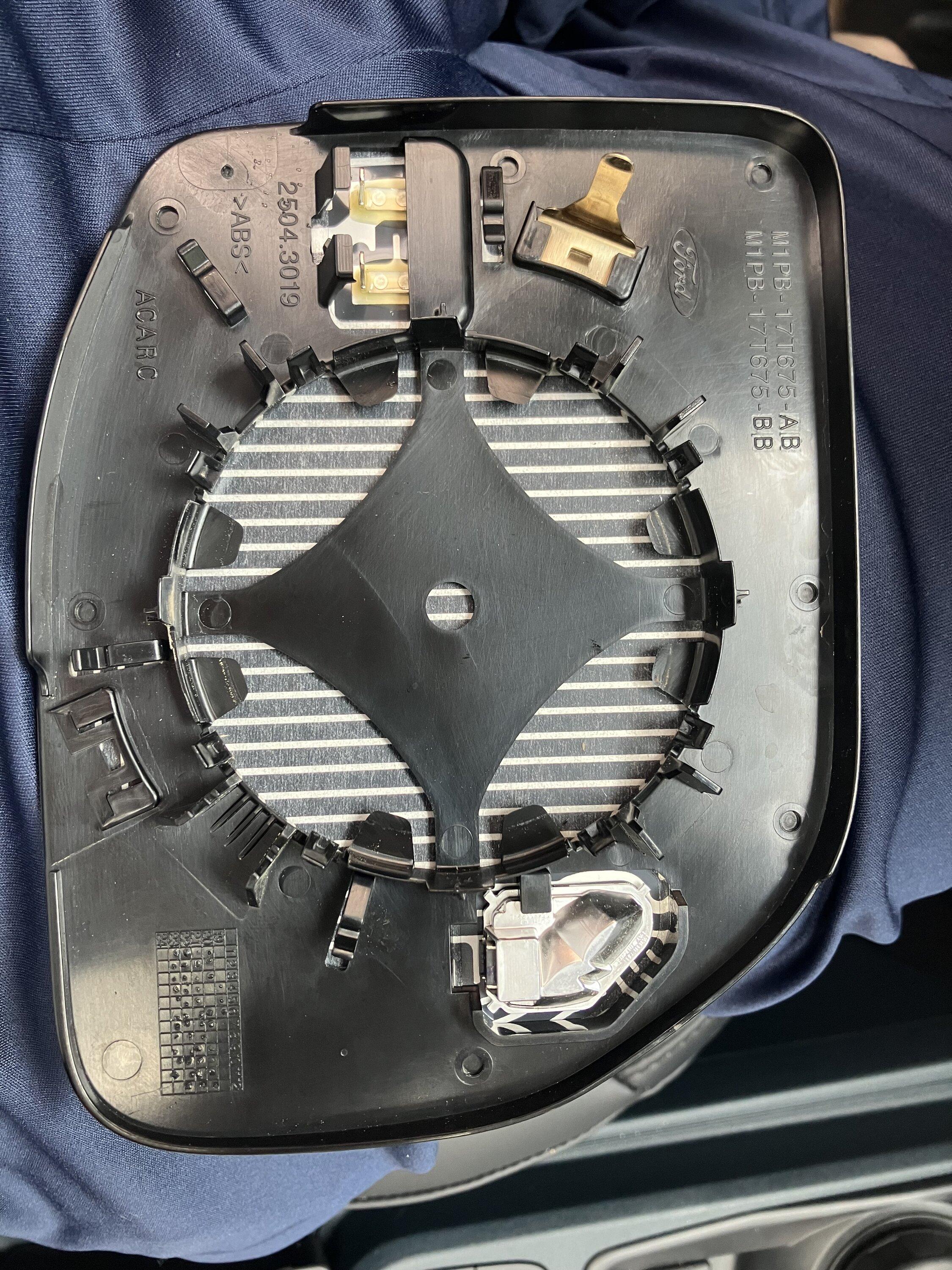

OEM mirror with a decent amount of structural plastic on the back. You can see the two plastic clips next to the two gold heating element connectors in the top left. Along the left and around to the bottom you can see Ford has some bending plastic clips to route/hold the BLIS cable out of the way.
Ford Maverick Suma Mirrors oem

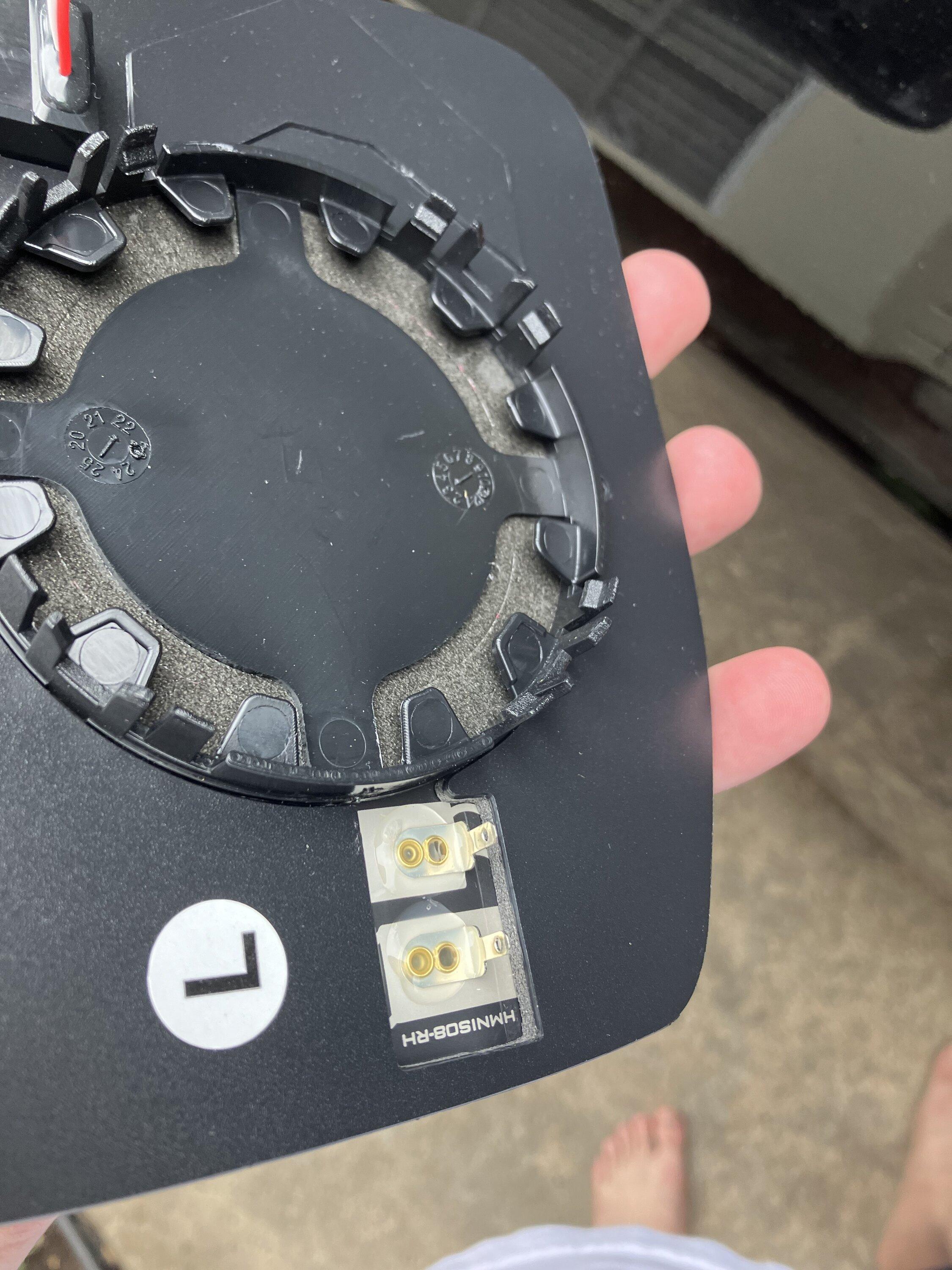

SUMA mirror. Note the absence of clips to hold the heating element wires... (this is the opposite side mirror from the pic above).
Ford Maverick Suma Mirrors suma
Slightly closer look at the suma mirror:
Ford Maverick Suma Mirrors suma connec

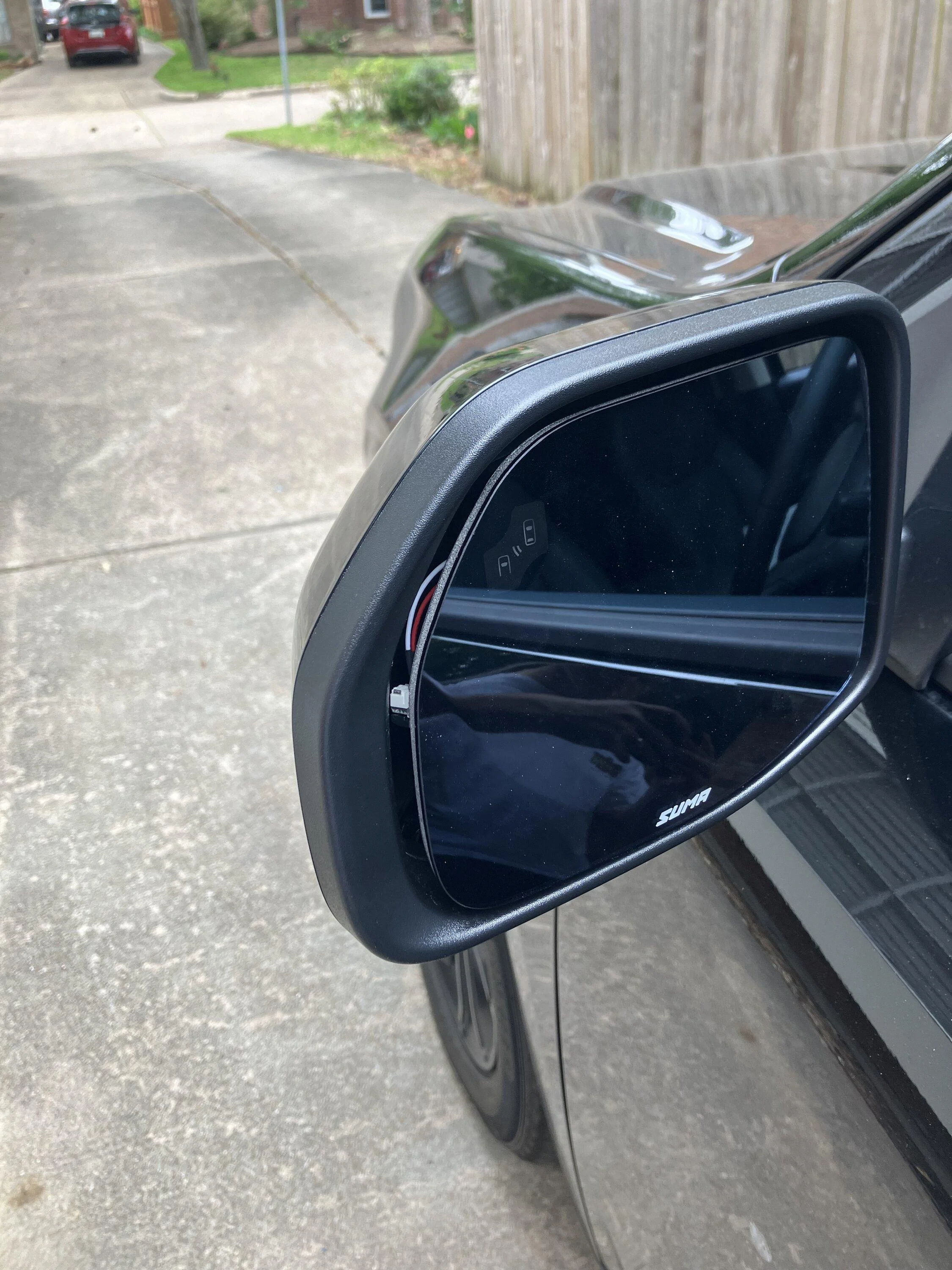

Result of the missing routing tabs on the SUMA mirror is the BLIS cable just sort of hangs there and can be seen from the side:
Ford Maverick Suma Mirrors suma holder

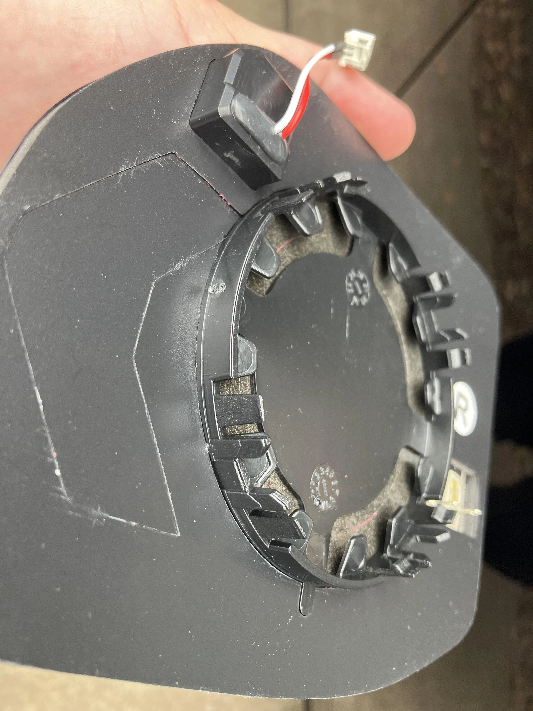

Closer look at the plastic ring on the SUMA mirror which appears to be glued to the flat part of the mirror.
Ford Maverick Suma Mirrors suma glu

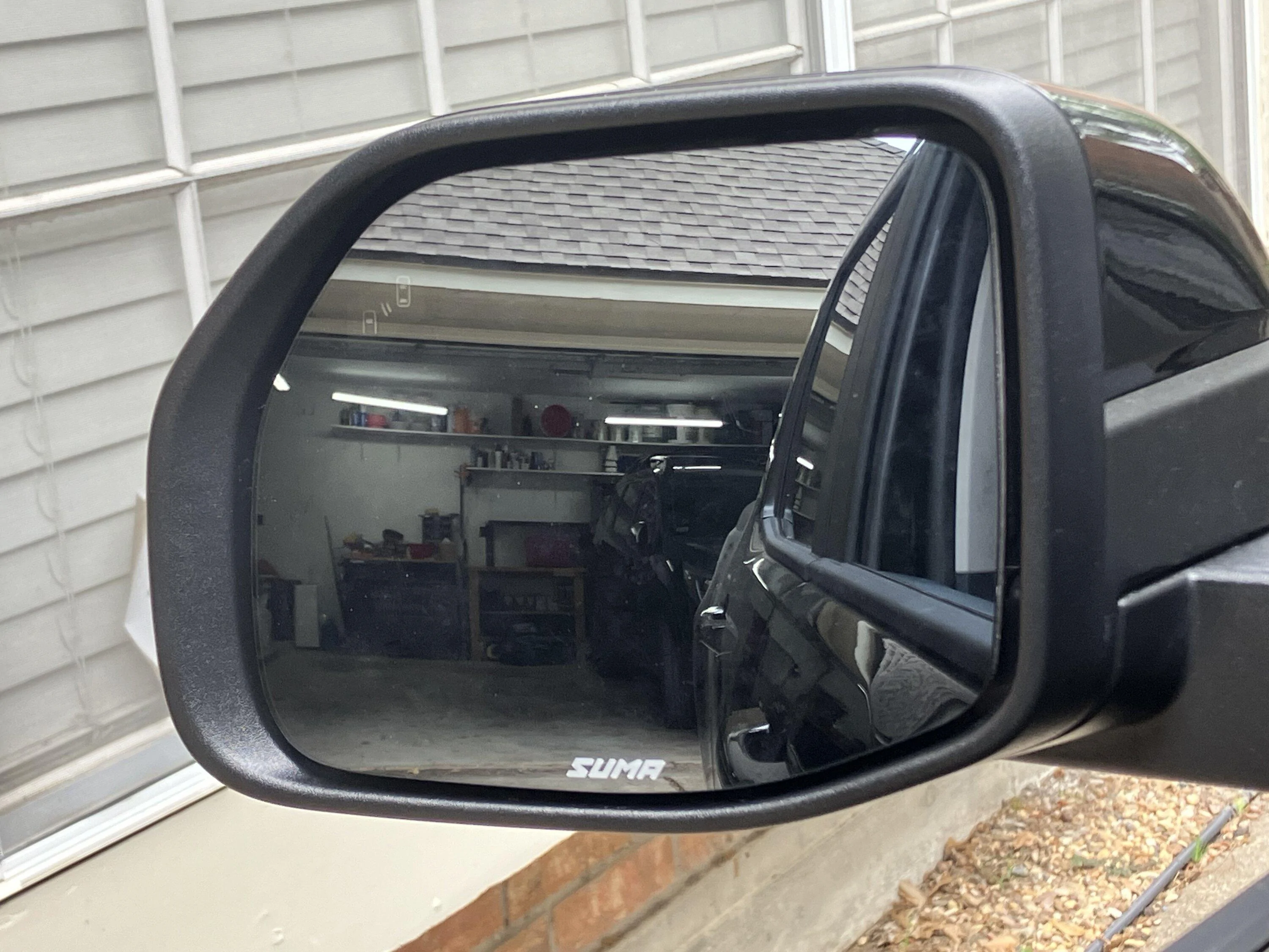

Overall post-install pic:
Ford Maverick Suma Mirrors suma after
