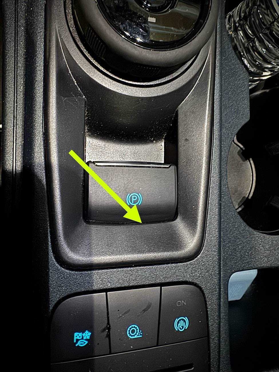

EDIT: I'm adding to the end of this the resolution of this frustrating problem. Relook at the first photo, then skip to what I've added at the end for the explanation. Be aware, this could happen to any owner, and it had NOTHING to do with being set up to flat-tow!

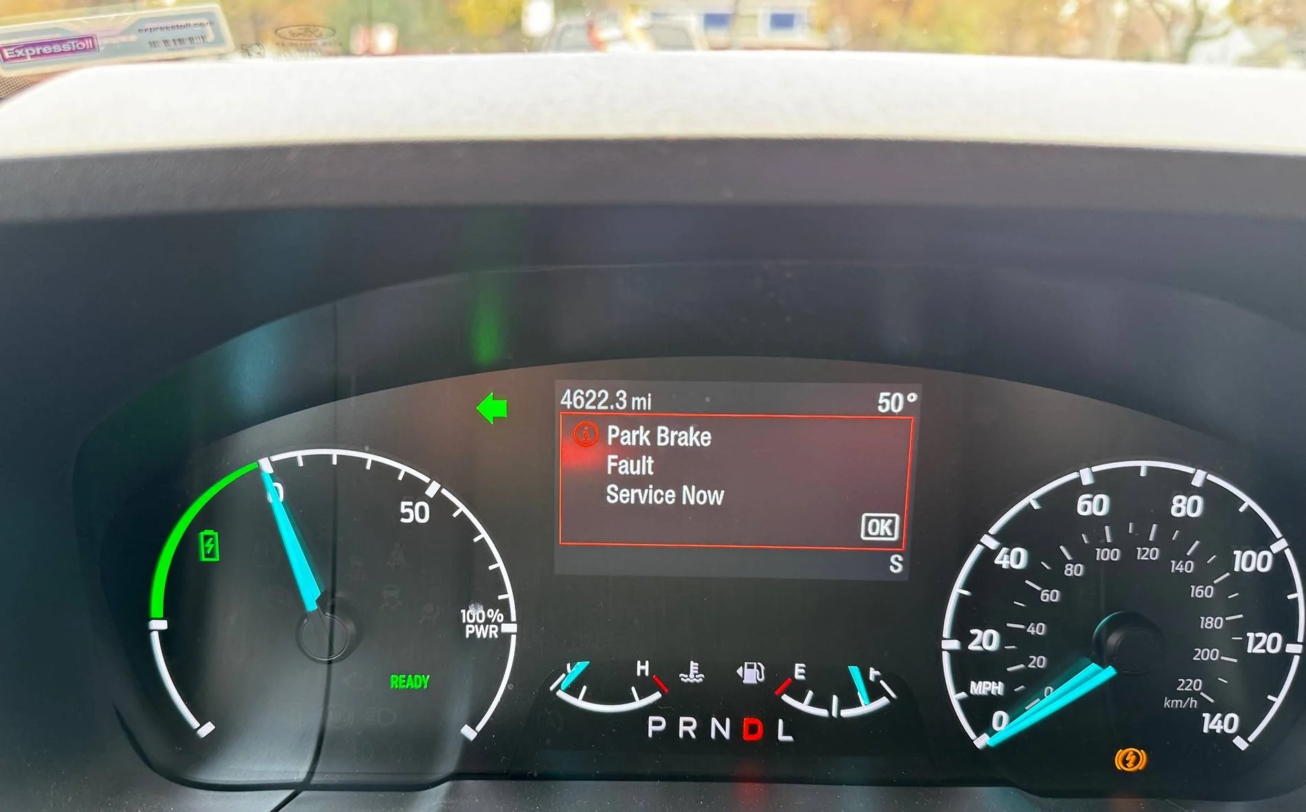

I first became aware of problems while driving our Maverick XLT Hybrid just last week when my left rear turn signal quit working and left turn gave me fast flashing. It was about due for first service anyway, so I made an appointment at our selling dealer here in Longmont for that + a look at the turn signal issue. When they discovered we'd had our Mav adapted for flat-towing, I was told they'd have to keep it for 2 to 3 days to hook it up to Mother Ford and "Diag." They also told me I'd have to pay $180 for that since after-market stuff was installed AND it might make diagnosing the cause impossible. Oh, and the 2-3 days and $180 are just diagnosis. Repair time & cost could not be estimated.
[Be aware that came to Ford asking what they had we could flat-tow because we had just down-sized from a Class A to a small Class C (based on Ford Transit 350HD AWD with dailies and 3.5L Eco-boost V6), and our next stop was going to be our old go-to across the road: the Jeep dealer. They just happened to have a 2024 Maverick on the lot, we were sold, BUT they were unable to enable it for flat-towing. So we went to our old go-to Lampert Hitch. They set us up and just a few weeks later, we hit the road... took a 3500 mile trip. The Maverick has 4,600 miles on it now, and this electronic melt-down -- in our Maverick's mind, at least -- has only now begun, and it has been maybe 3 months since it has been hooked to the RV. I'm really doubtful the flat-tow set-up is the problem, but it's inevitable our dealer will play it that way, I suppose.]​
Well, at that point, the service writers huddled with me and we decided to wait until I could visit with Lampert Hitch in Denver, the shop that has prepped all our vehicles for flat-towing since we started motorhoming, though all before this Mav were Jeeps. Unfortunately, while driving the Mav running errands around town two days later, we got the dash readout you can see in this first photo.
Ford Maverick SOLUTION NOTIFICATION!!!   2024 XLT Hybrid Electronics Sending Computer to Panic Mode IMG_3115
I immediately drove to our dealer and we ended up with an appointment for a Diag beginning Monday. Oh, and one more thing: No loaners available; the Pinto is booked for several weeks out. (Actually, it was more like "Up yours" than that fictional response.)
But the service writers did share the following screens with me. They display our Mav's thoughts in real time, and they store that data. Truly, I do not see these things all played out in the behavior of our Maverick, but every time we even walk into the garage, the poor thing begins bleating for attention. The first photo below shows our Mav's thoughts at the time it was parked in the shops waiting area, and the other two shots step back in time.

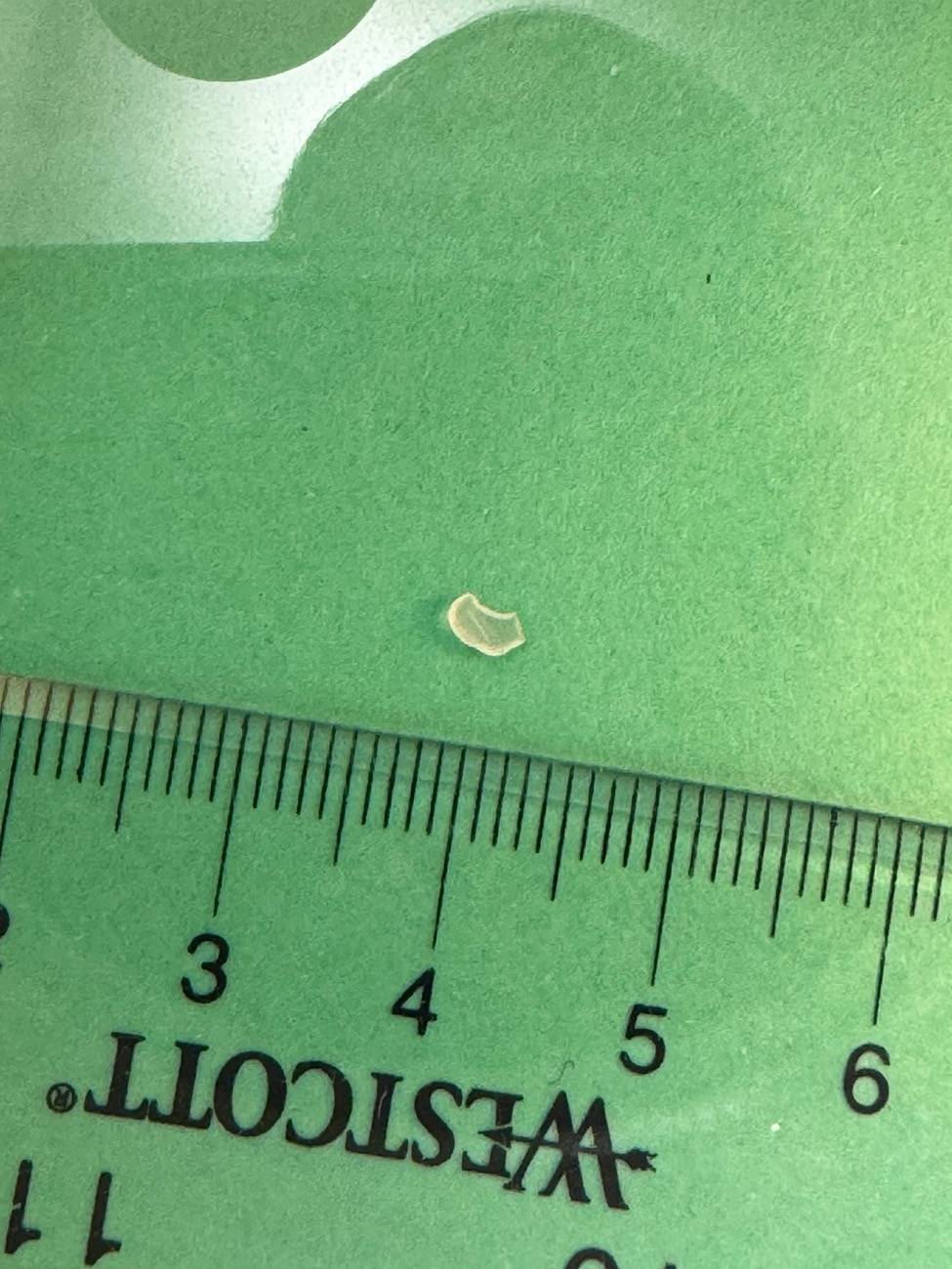

An alert technician at Lampert Hitch in Denver was double-checking all their connections related to flat-towing that we had paid them for, and he noticed that the Parking Brake lever appeared not to be fully in its upright position. The truck has been constantly displaying this dash error for a couple of weeks, thus we’ve driven it only when absolutely necessary. Anyway, the tech put 2 and 2 together and he dug this little fragment of plastic out of that gap and bingo, the alert went away and we’re all systems go! I cancelled our appointment for diagnostic imprisonment for 2 to 3 days next week!
Should you get this same dash alert or should the little red lightning bolt light up at the bottom of your dash screen and you start getting odd ALERT notices like SPEAKER #1 FAULT, REAR STOP/POSITION LAMP OUTPUT, ABS FAULT, ACM, maybe you got a tiny fragment of debris lodged in your Parking Brake lever.
Ford Maverick SOLUTION NOTIFICATION!!!   2024 XLT Hybrid Electronics Sending Computer to Panic Mode IMG_3161
That's millimeters, not inches!
