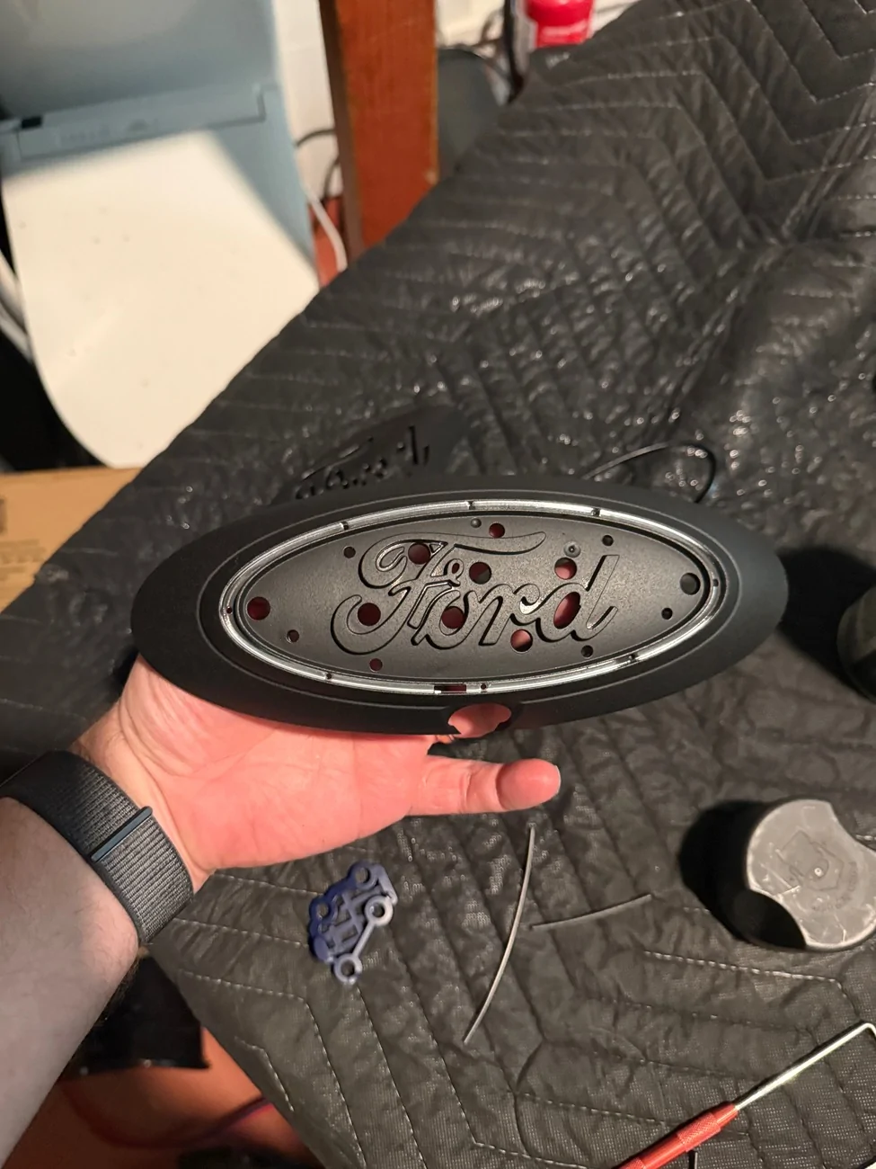

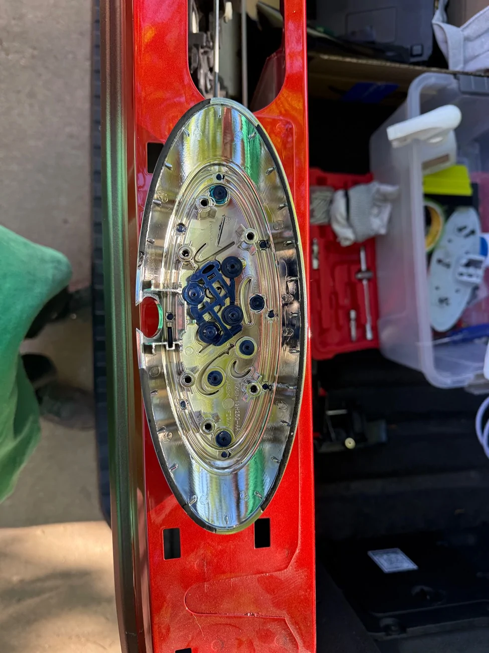

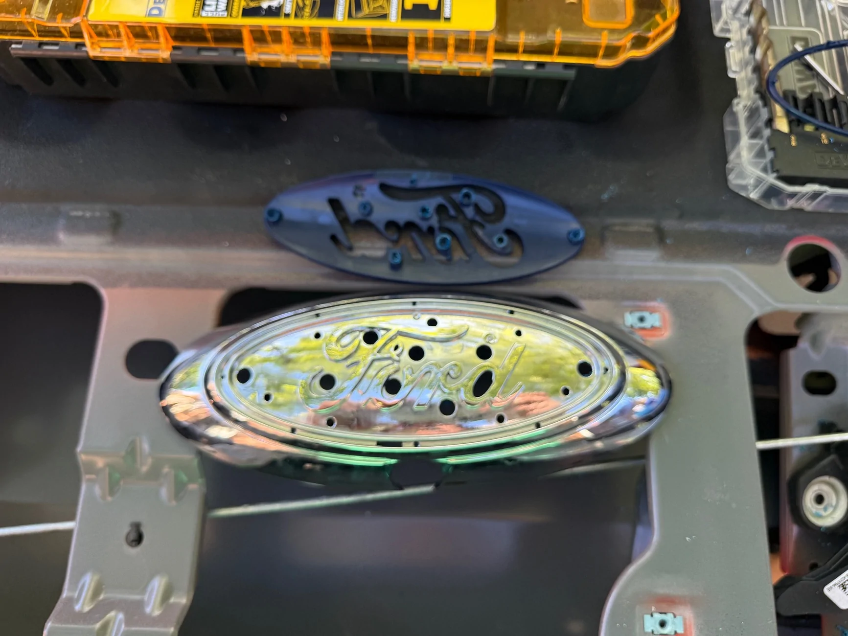

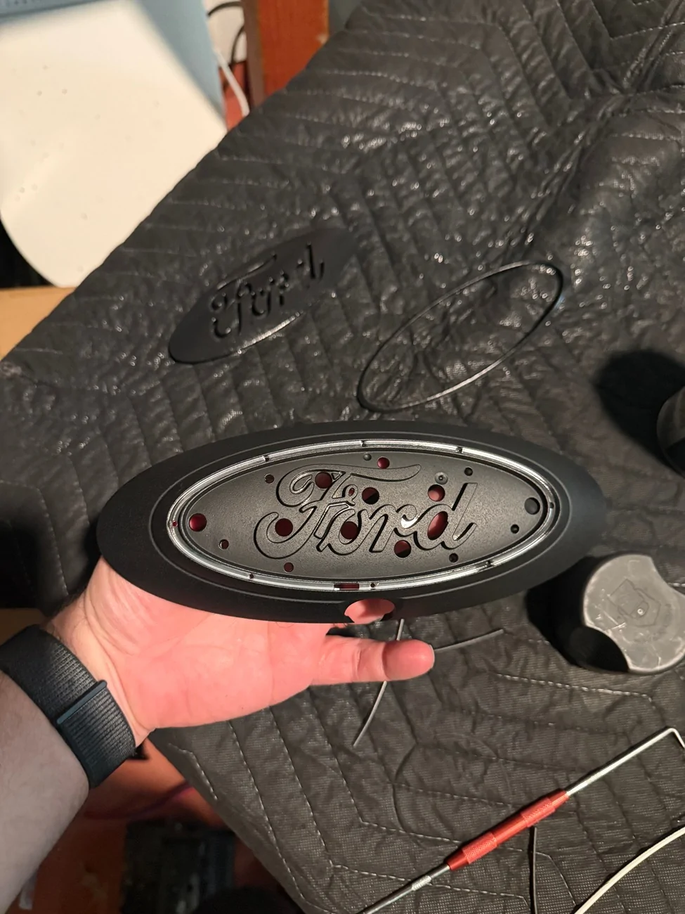

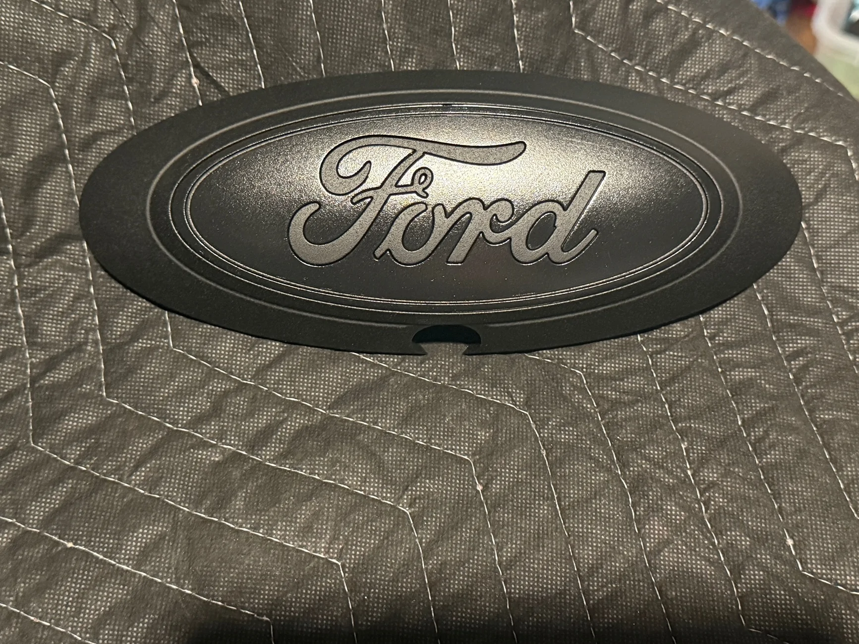

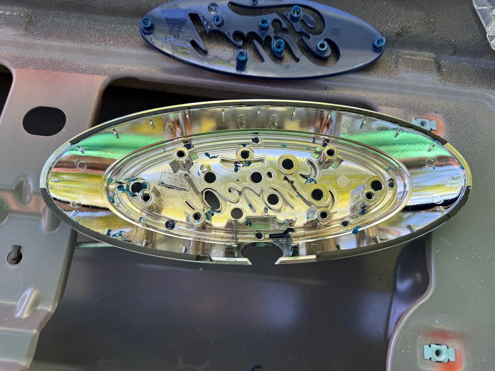

Thought I would share some pictures of painting the rear emblem.
Blue parts were painted satin black.
Chrome parts were painted with bed liner platinum (rustoleum).
Scuffing, plastic adhesion promoter, then black primer before the final coats.

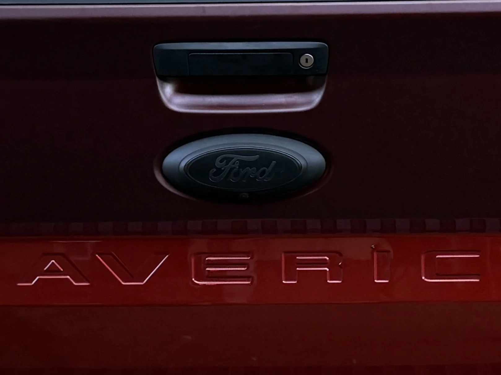

Interesting blackout effect.

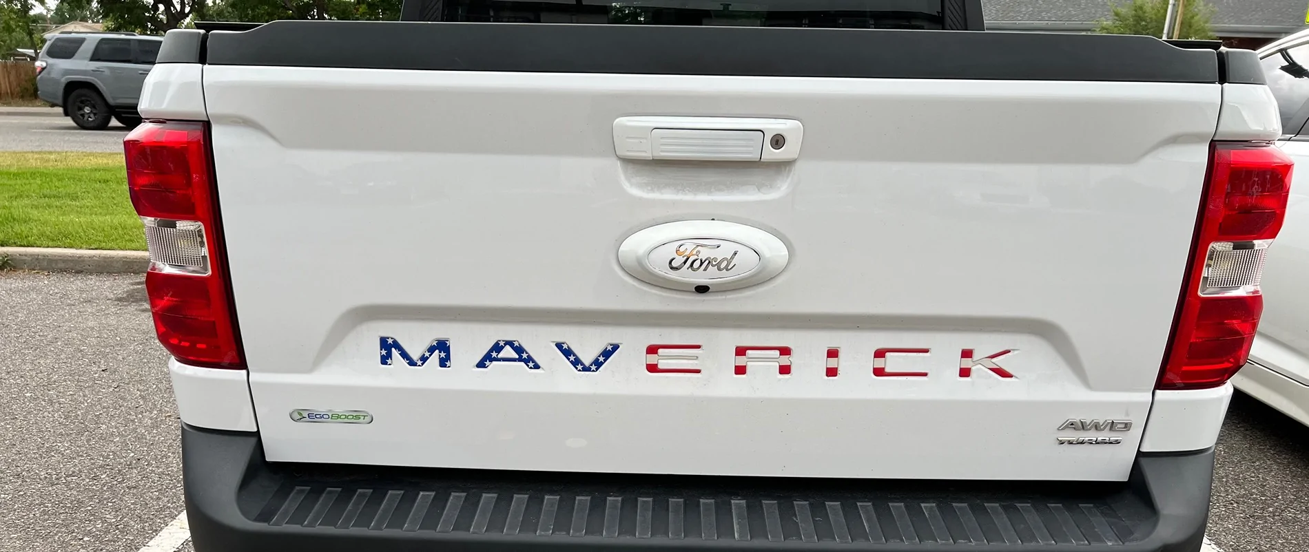

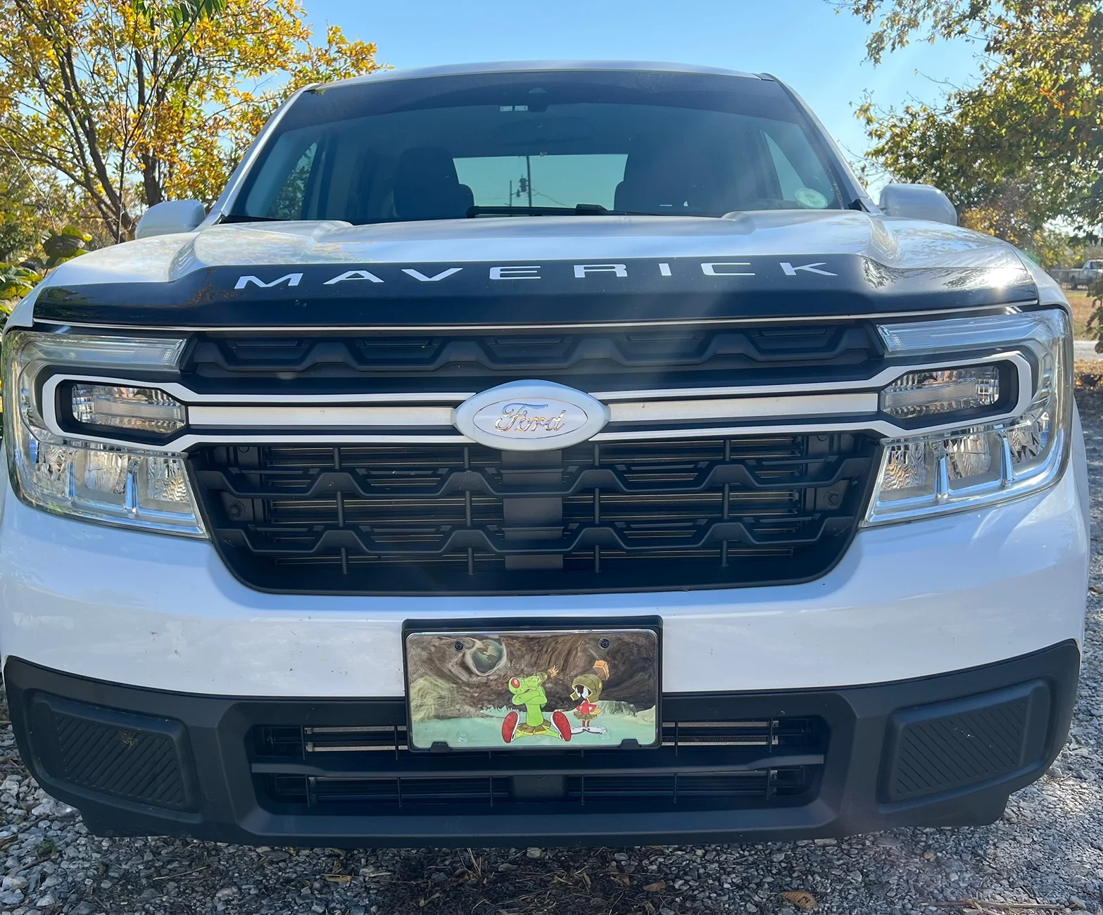

🤓 :unsure: I like the Ford in chrome, but doing a white thing I did it with overlays and a decal. Didn’t take anything apart.
