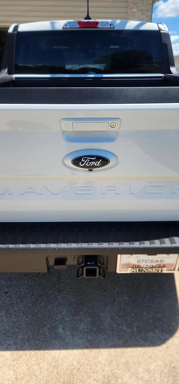

Do you think Ford will sell these? I'd really like a set for my alto blue build. One for my grill bar and one for the tailgate with the camera in it would be great.

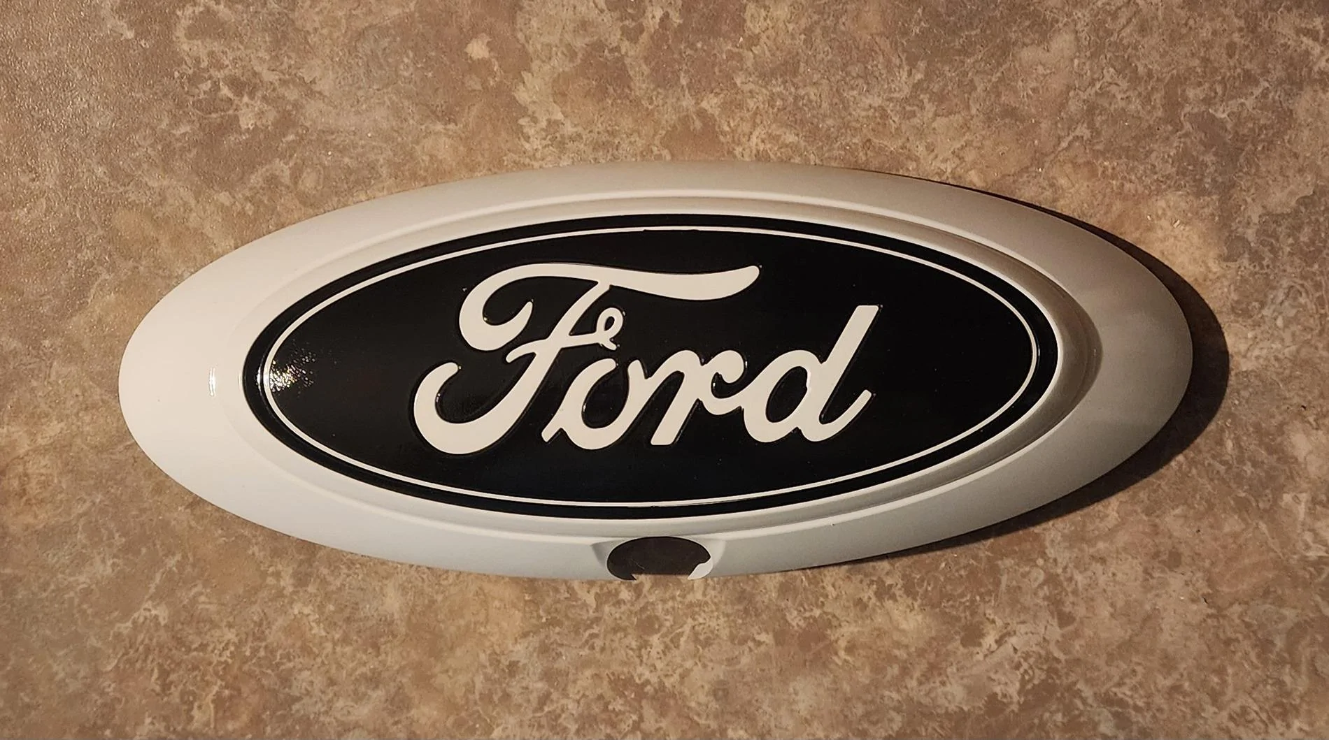

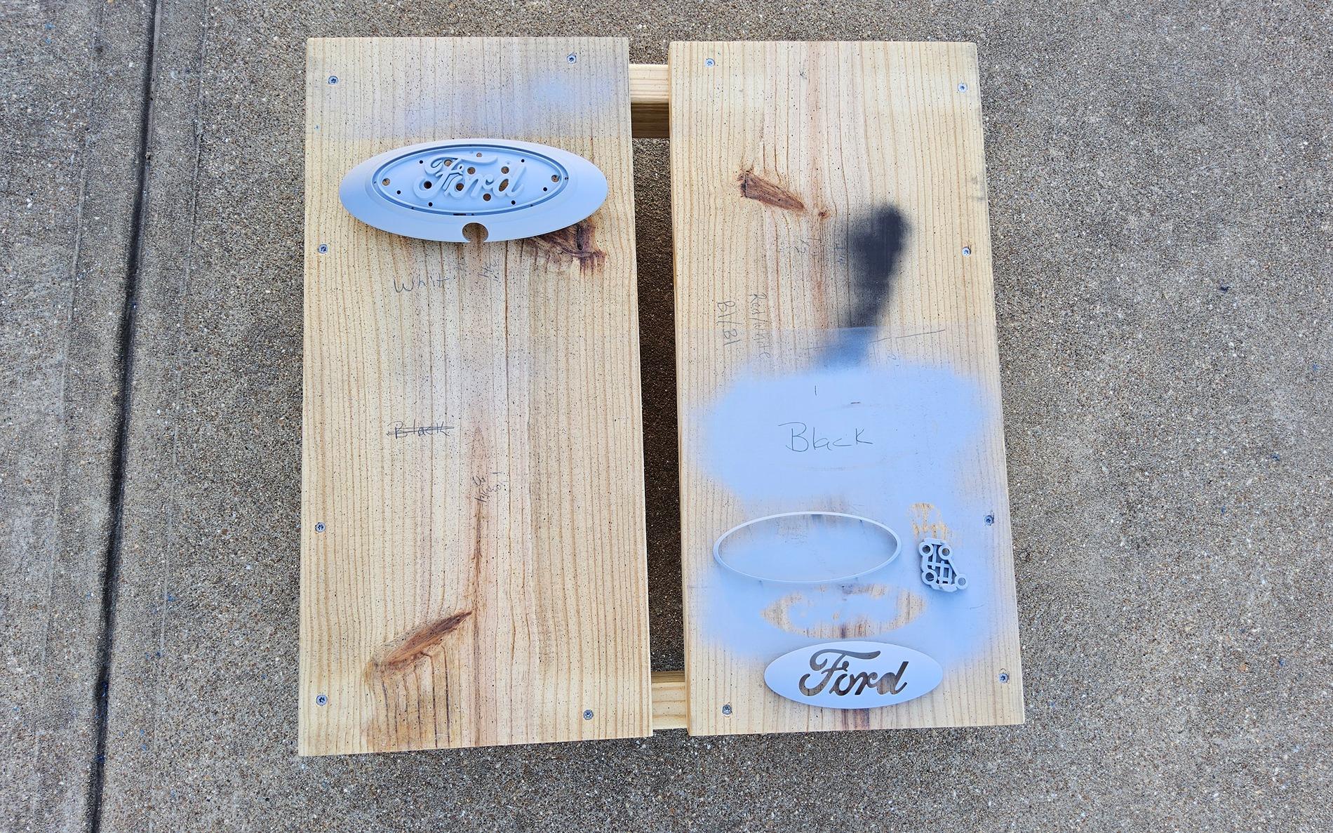

Thank you, took a round 3 hours total of painting and letting it dry between layers and another 24 to cure. Started on a Friday night after dinner reinstalled it on a Sunday evening.
Hardest part was the waiting for it to cure. Ha ha

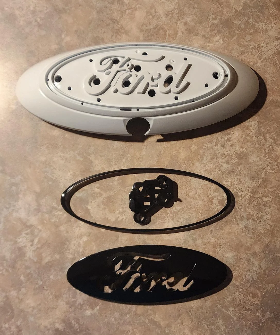

Pretty simple. Remove the 8 torx screws on the tailgate access panel, 2 bolts on the camera logo, disconnect the camera connector on the Ford emblem housing. Disassemble the emblem and prep and paint.
I got matching paint from O'Reilly's, primer, base and clear rattle cans.
