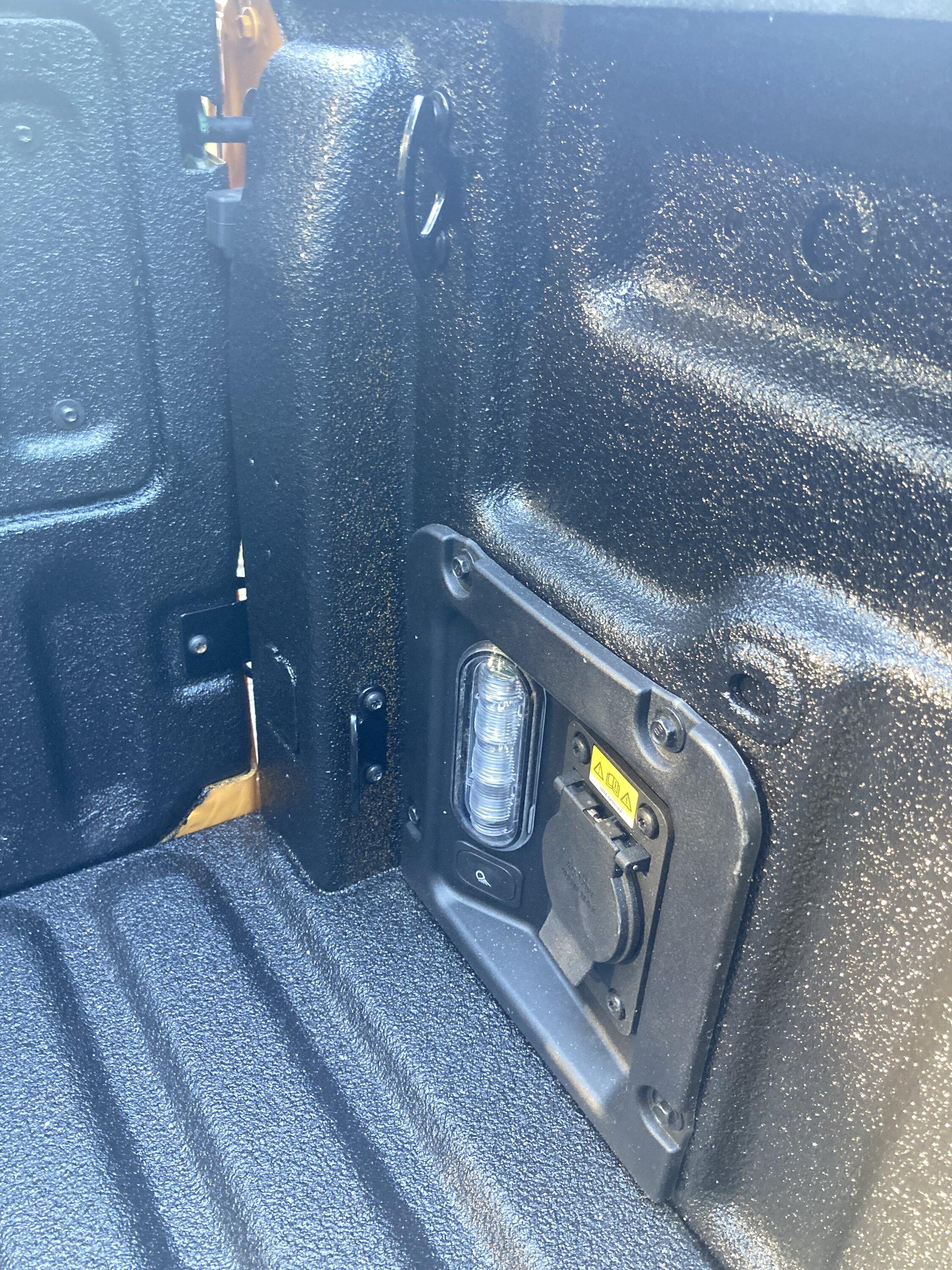

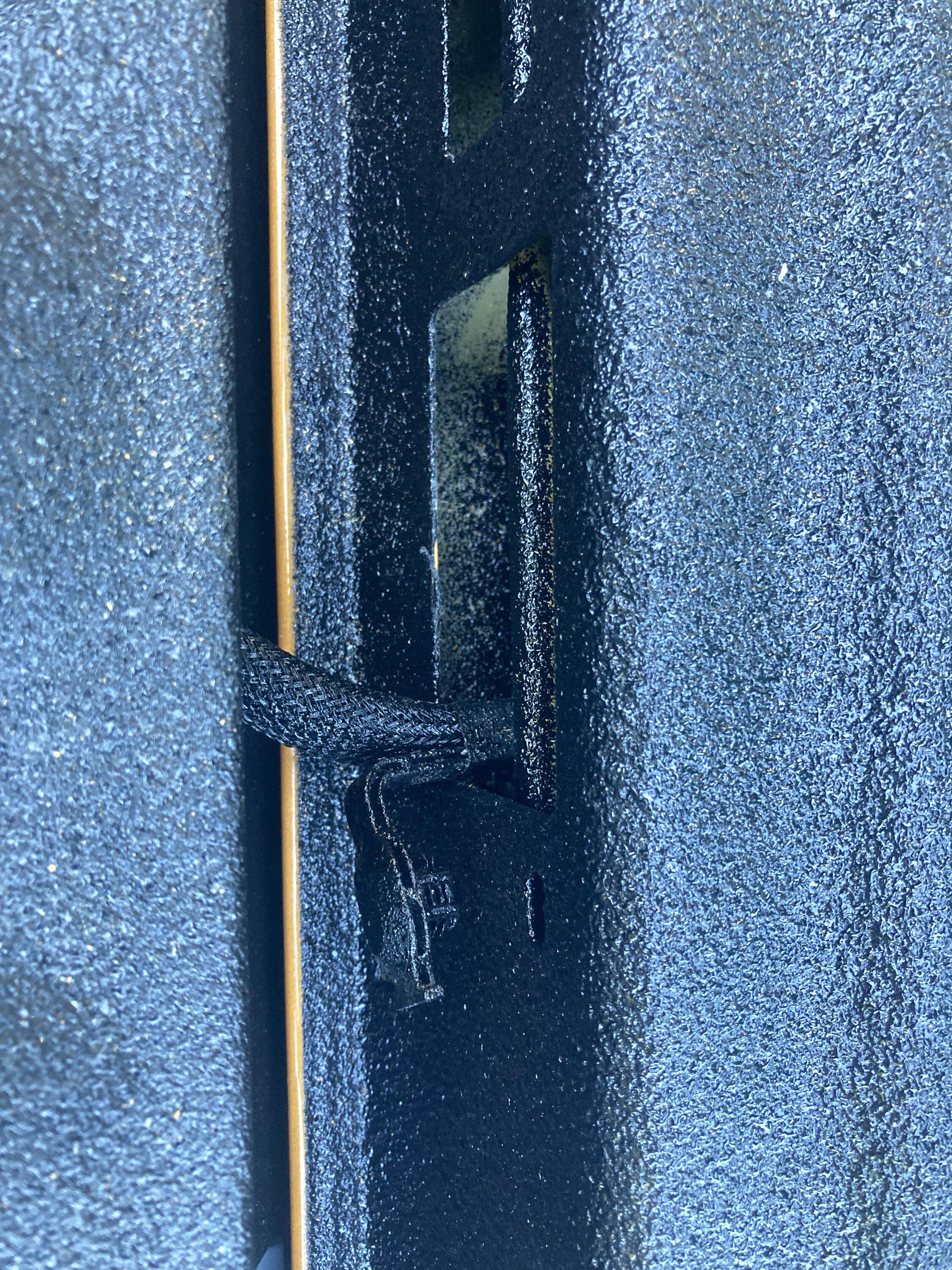

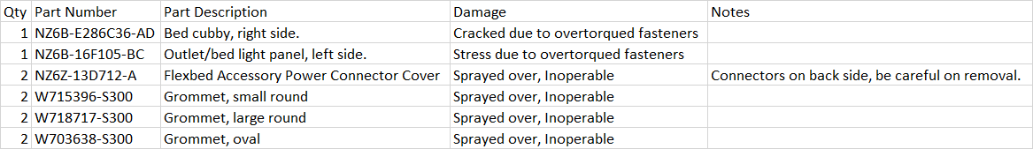

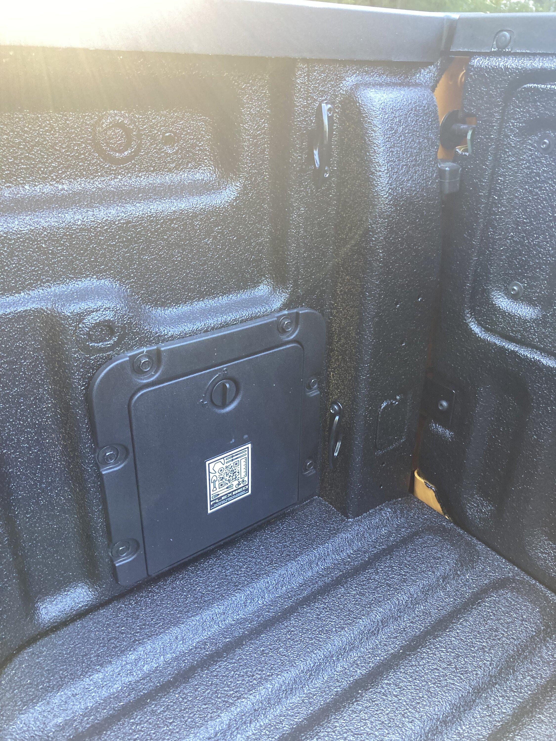

Here's the list from what they did on my Lariat:
- Sprayed too thin (note the yellow showing through).
- Wire for tailgate wiring ran through wrong hole.
- Overspray on bumper cover, tow hitch, and the crack between the taillights and the rear quarters (not pictured).
- Both bins/panels screw holes stressed/cracked from over-tightening.
- 12V Flexbed covers sprayed over.
- All grommets sprayed over.
- Lower corners of the tailgate not sprayed.
- Two of the tie-down bolts partially stripped but still operable.
The owner Eric did about everything he could to make things right on my truck by replacing the damaged parts and having the bed re-sprayed. However, my truck wasn't just a one-off mistake - I just found another forum member that had a similar (albeit not THIS bad) job done on his truck.
