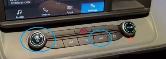

Seriously, do the following...
PUSH:
ON/OFF -Volume
button + Fastforward >>> same time for 10 seconds...
Ford Maverick Message about backup camera Info_system_reboot
Should reboot... :giggle:
