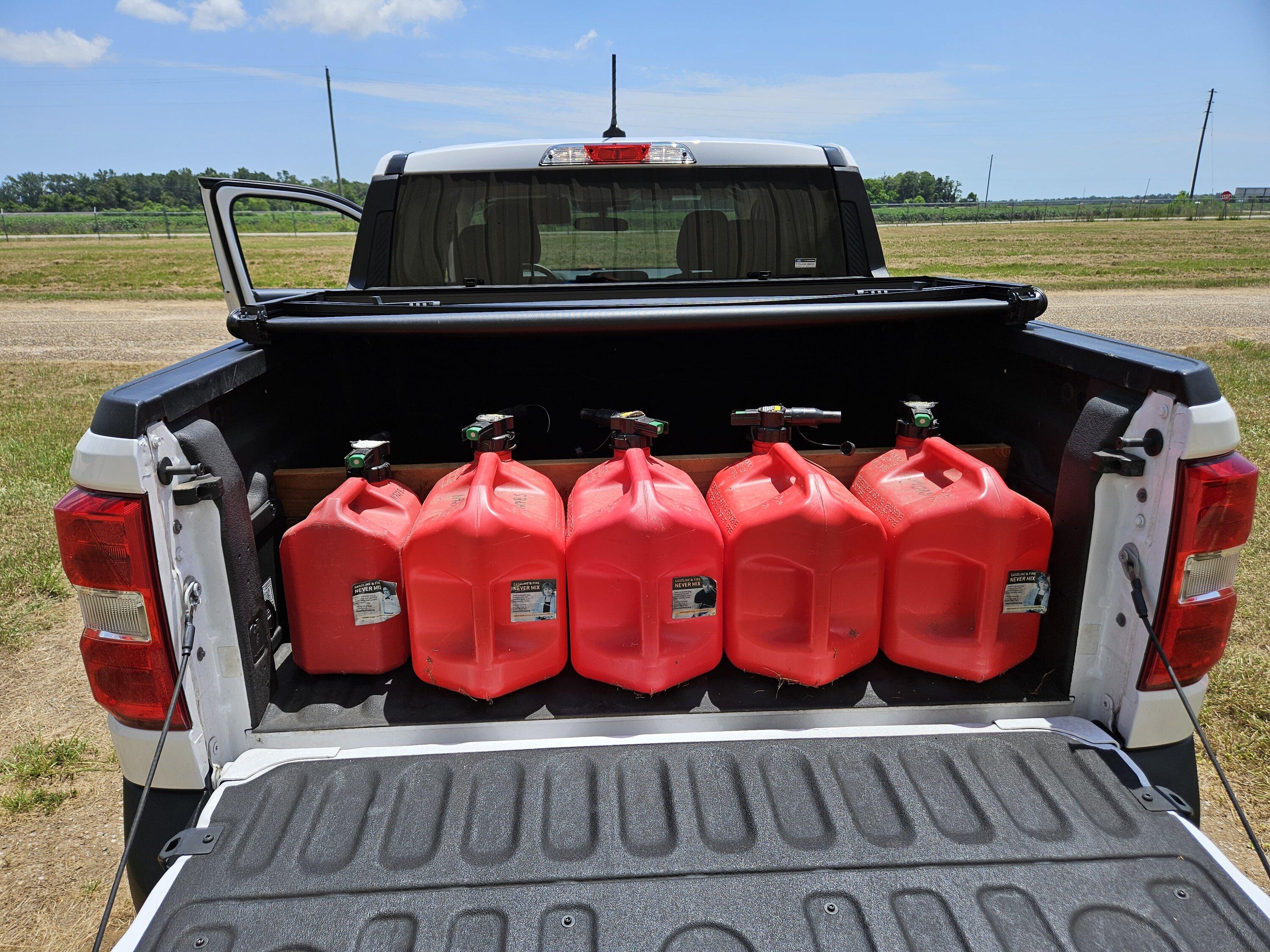

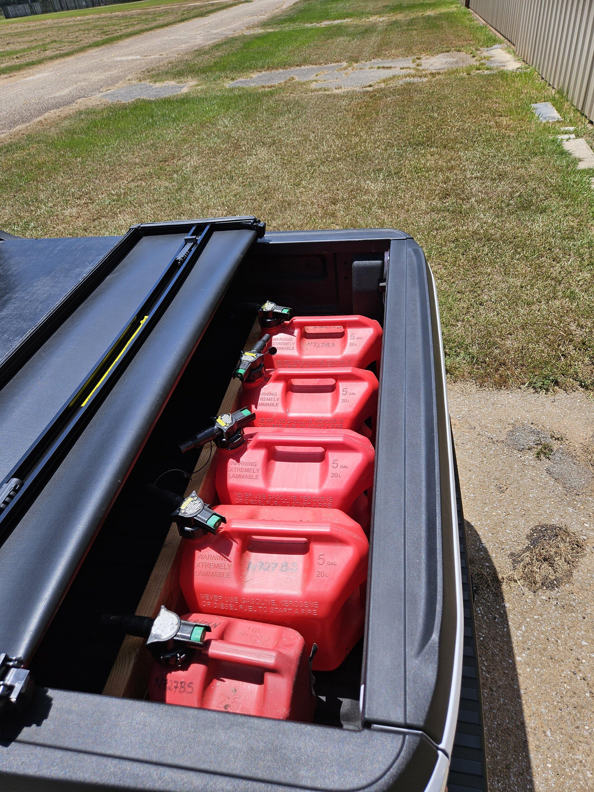

One of the beauties of getting the Maverick is hauling fuel for my Cessna 172D. I can put ethanol free fuel (called marine gas around here) in the 172, but I have to haul it from the gas station. Before, I'd have to put it in back of my Tiguan and I was always concerned about getting rear ended. Now fuel stores neatly in the back of the bed and the Flexbed partition keeps it from moving around....perfect.

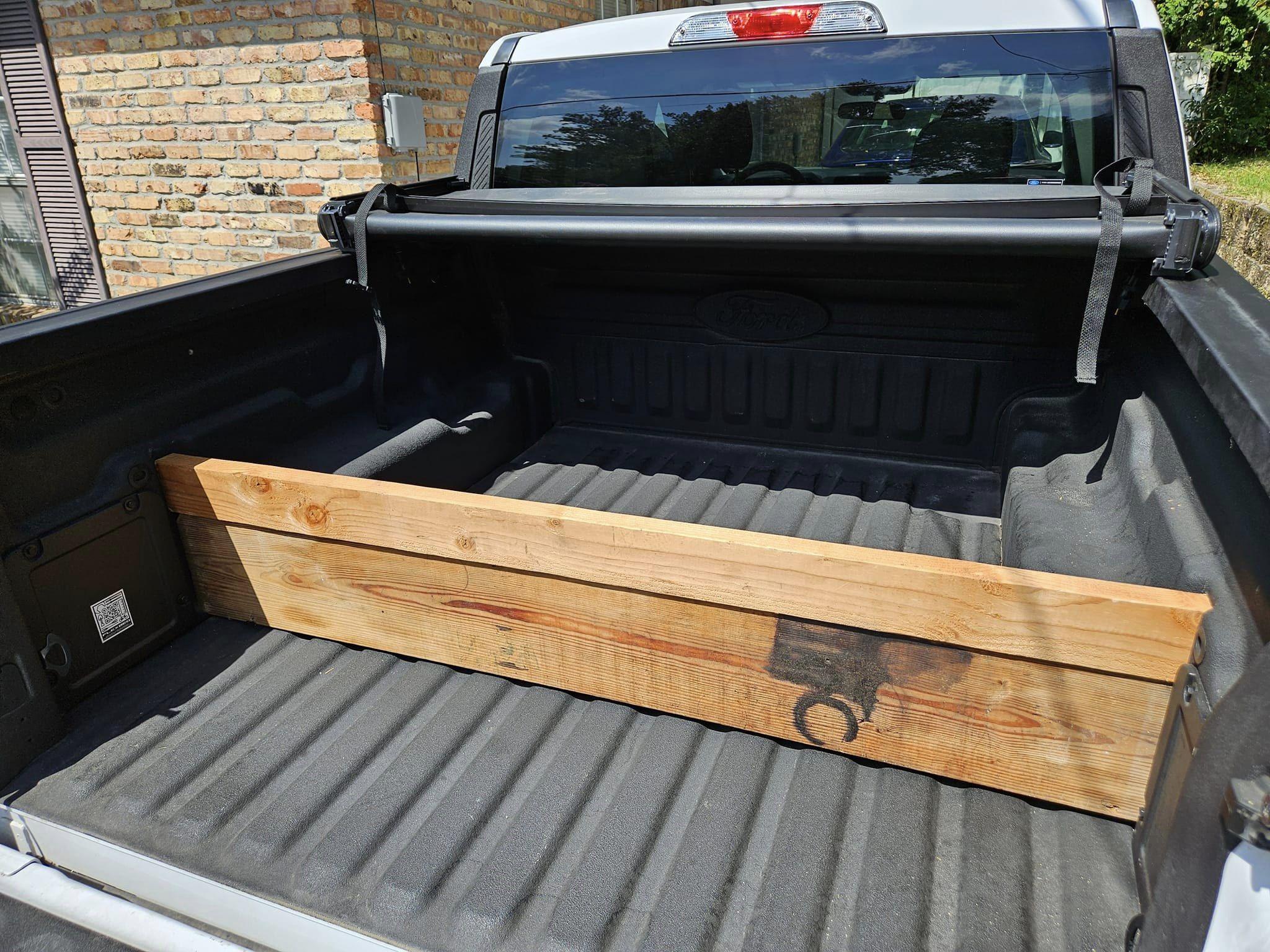

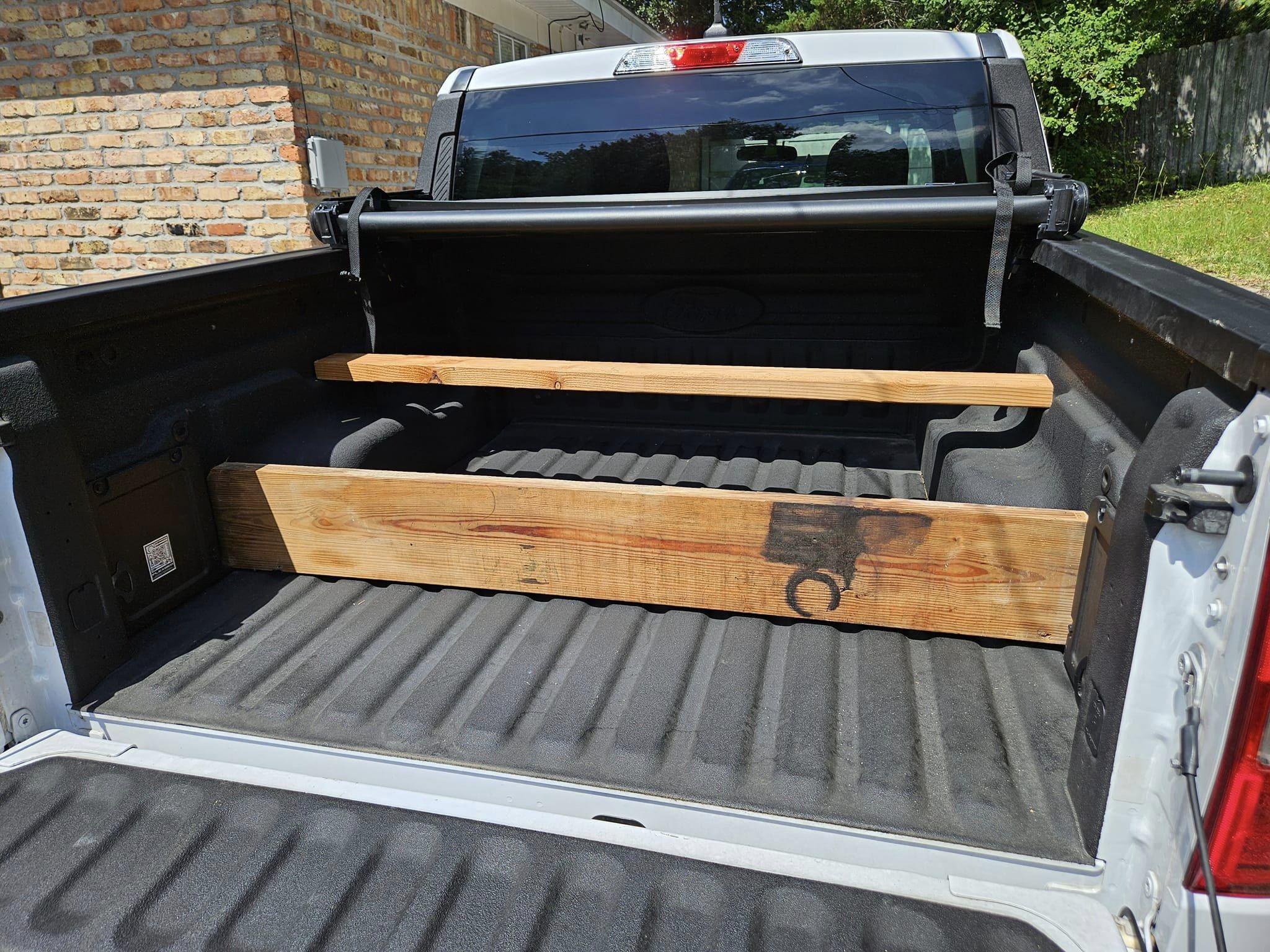

Fretman_2: What's the length you cut that 2x? board? Any wobble or rattle when you leave it in the bed?
fretman_2
fretman_2
Aug 9, 2023
Mobile, AL
2022 Maverick XL
It was a 2X8 that I cut down to a 2X6. The 2X8 worked, but the 2X6 was much easier to manipulate into place. An additional 2X4 on top makes the partition even higher if needed and that's what I did. There's plenty of height in that slot for the additional 2X4.
I believe the dimensions for the 2X6 was 54 and 3/8 inches (but double check that). The 2X6 isn't wedged in there tight, but there's no wobble or rattle that I can tell and I do have the spray in bed liner. The lengths for the 2X4's that go into the top slots is a little more than the 2X6 so be careful there. If you cut the top 2X4's to 54 and 3/8 inches, they'll still work, but you'll have about an additional 1/2 inch of space.
