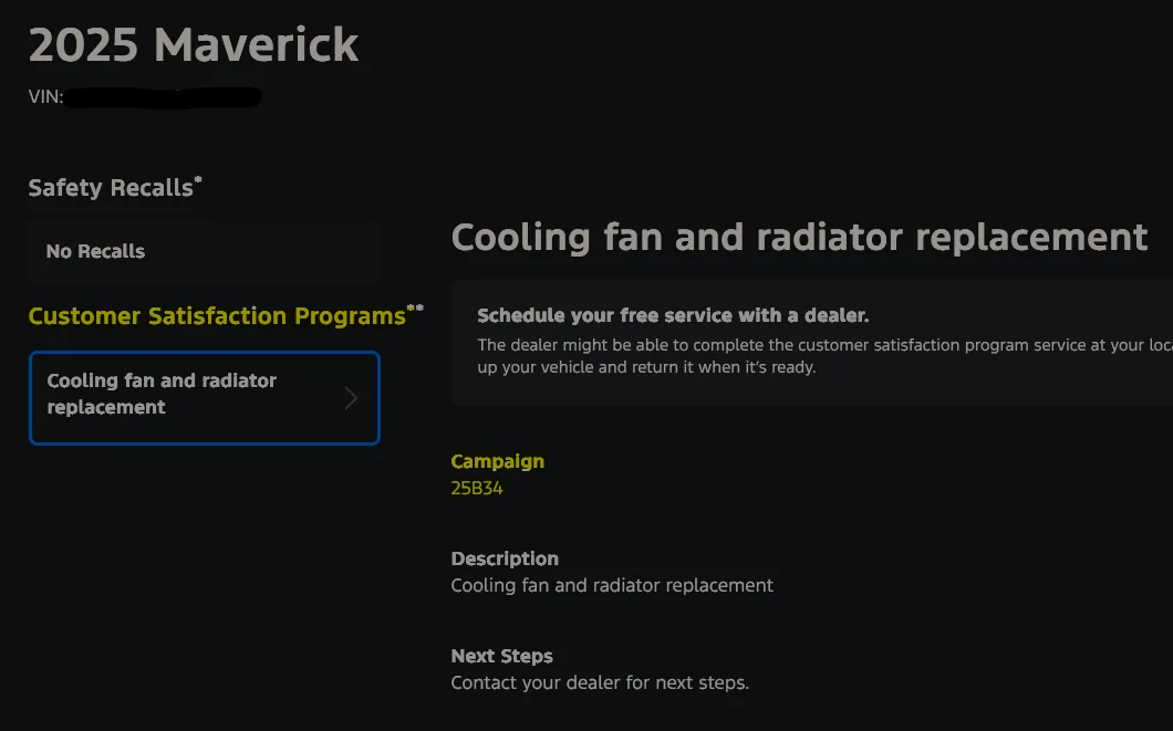

Update on my Rad/Fan replacement recall.
It took a day and a half to get my vehicle back.
I used the pick-up/drop-off service. Valet picks up in the morning (or whenever), delivers it to the dealer.
Pretty handy for me.
I expected it to be returned end of the day, but it took more time than expected.

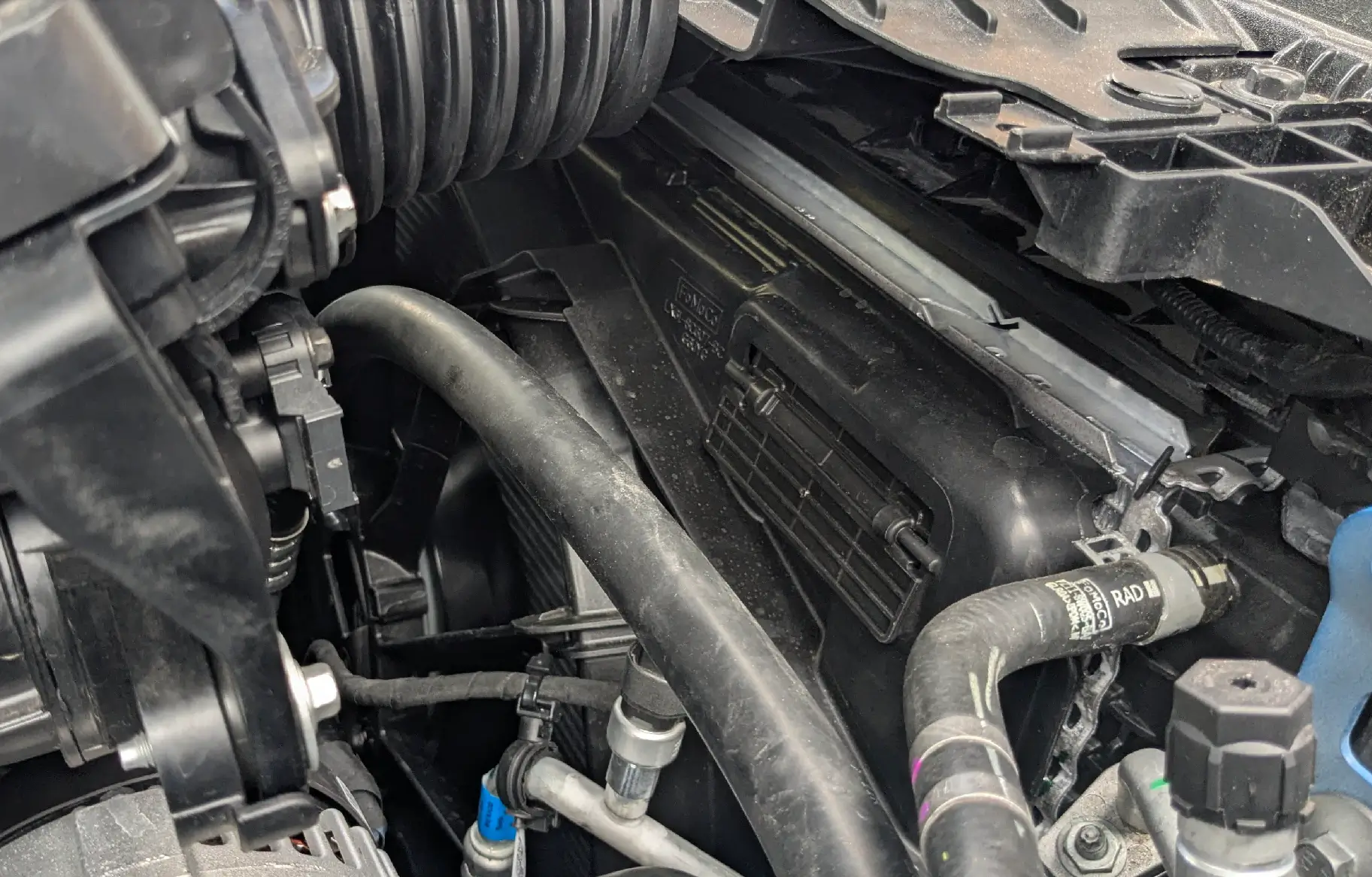

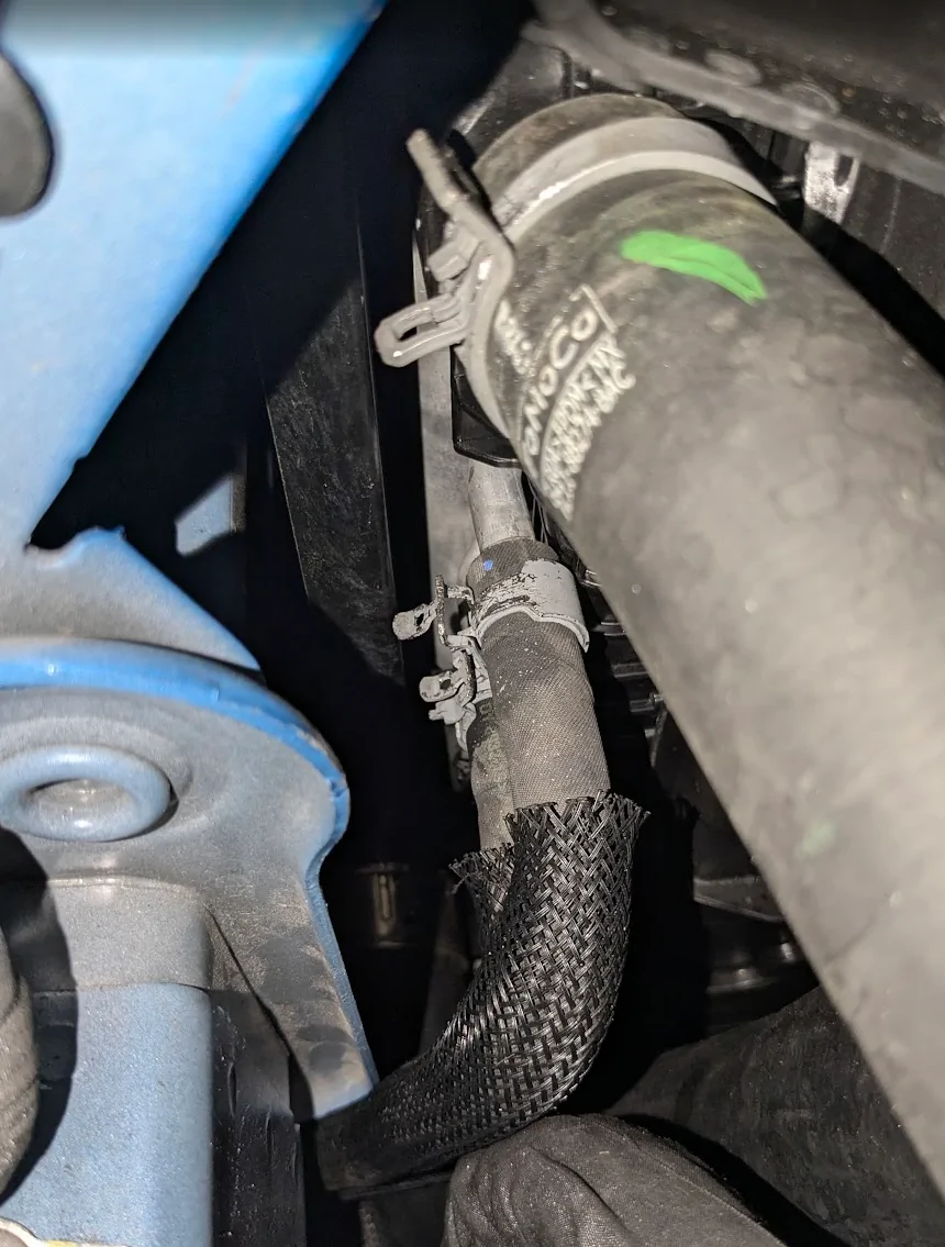

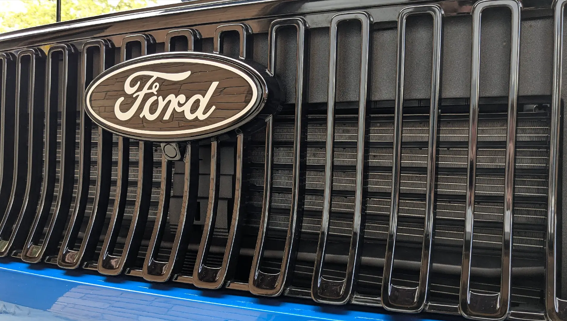

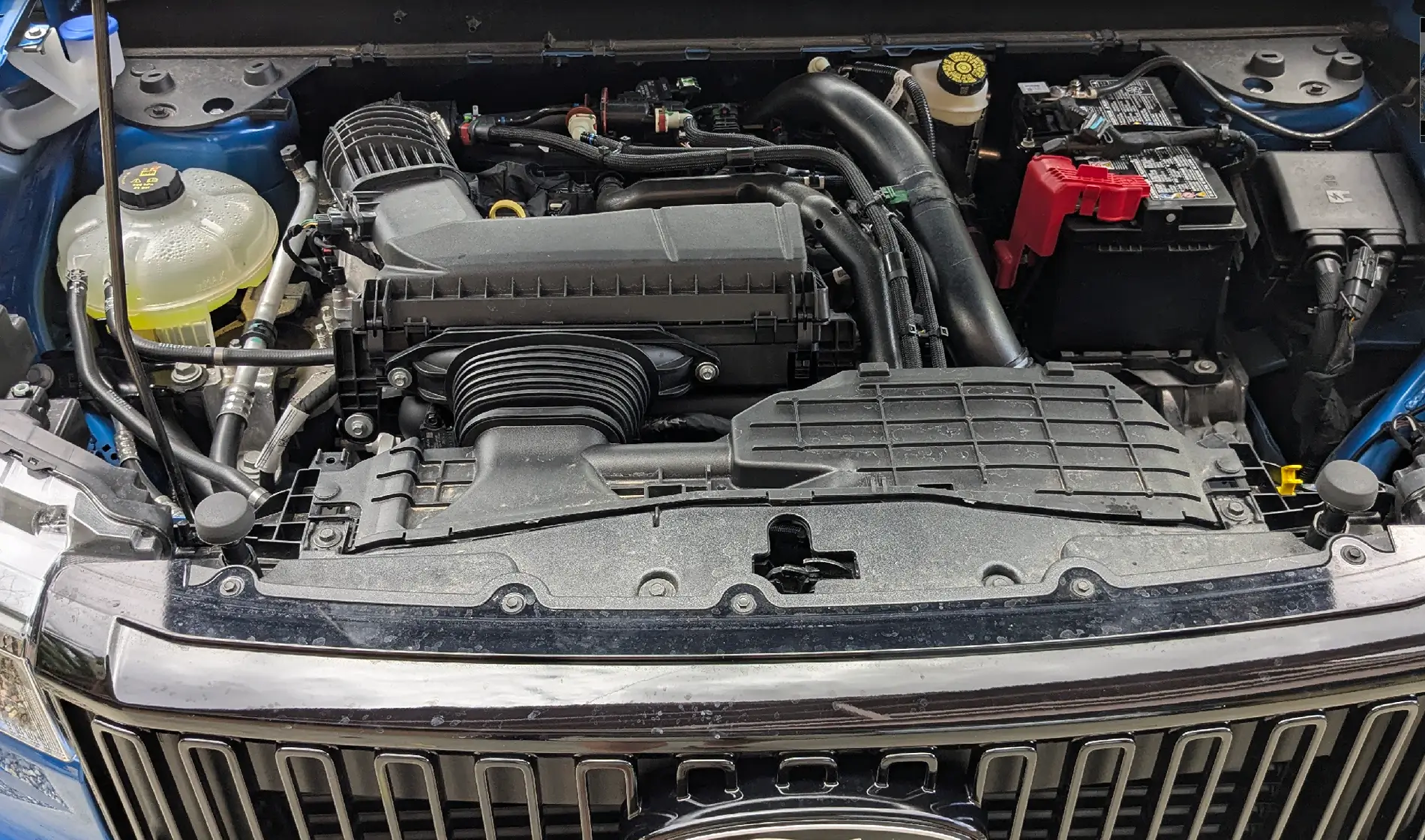

I did some inspecting, I do not see any signs of damage or wear in the external body panels (bumper/fender gaps). So I think the front fascia stayed on. I checked gaps and edges pretty closely in the day light.

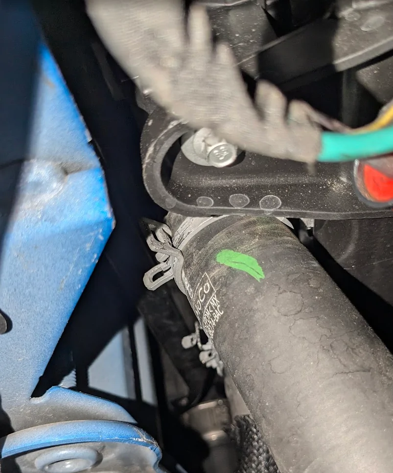

I see obvious signs of hose clamp manipulation, normal scrapes from prying the clamps open-not damage. Nothing appears to have been disconnected on the engine block side, only at the rad. clamps. (makes sense)

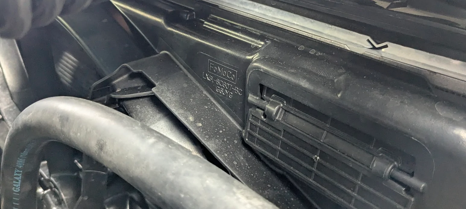

I notice more air-flow and Fan noise than before.
I can see and feel more air flow..but don't have scientific data, but I suspect this fan is higher amperage/power draw.

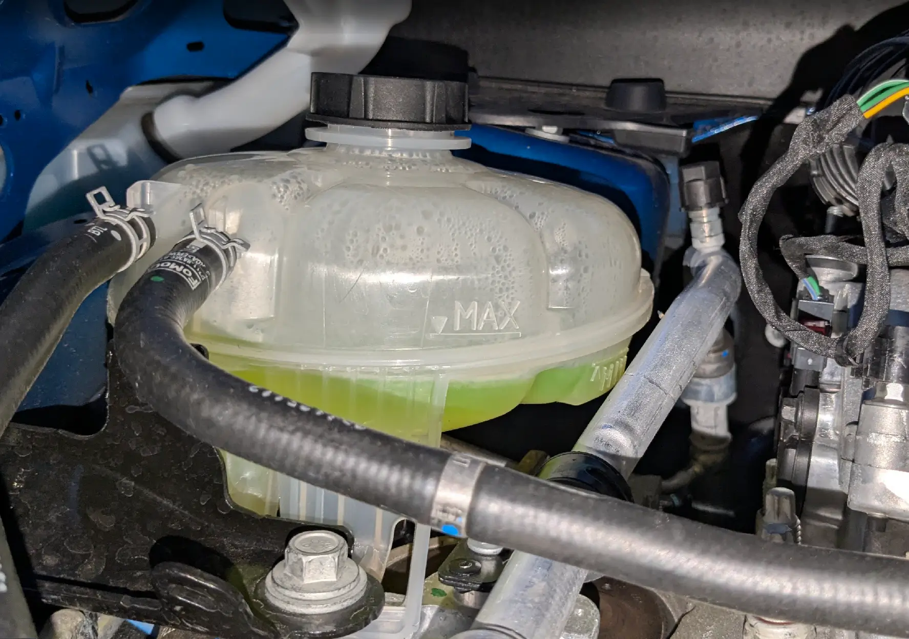

Coolant res. is at the MIN line (while in a 'Hot' state), and may need a top up after I put some more time/miles on it. This doesn't concern me, I expect it after such a procedure on the cooling system. I'll likely stop by and have it topped up after some more time/cycles.
I'll be doing some more extensive driving tomorrow and monitor and check further for any leaks. Looked Dry and Clean after inspecting after my evening drive up and down some twisties.

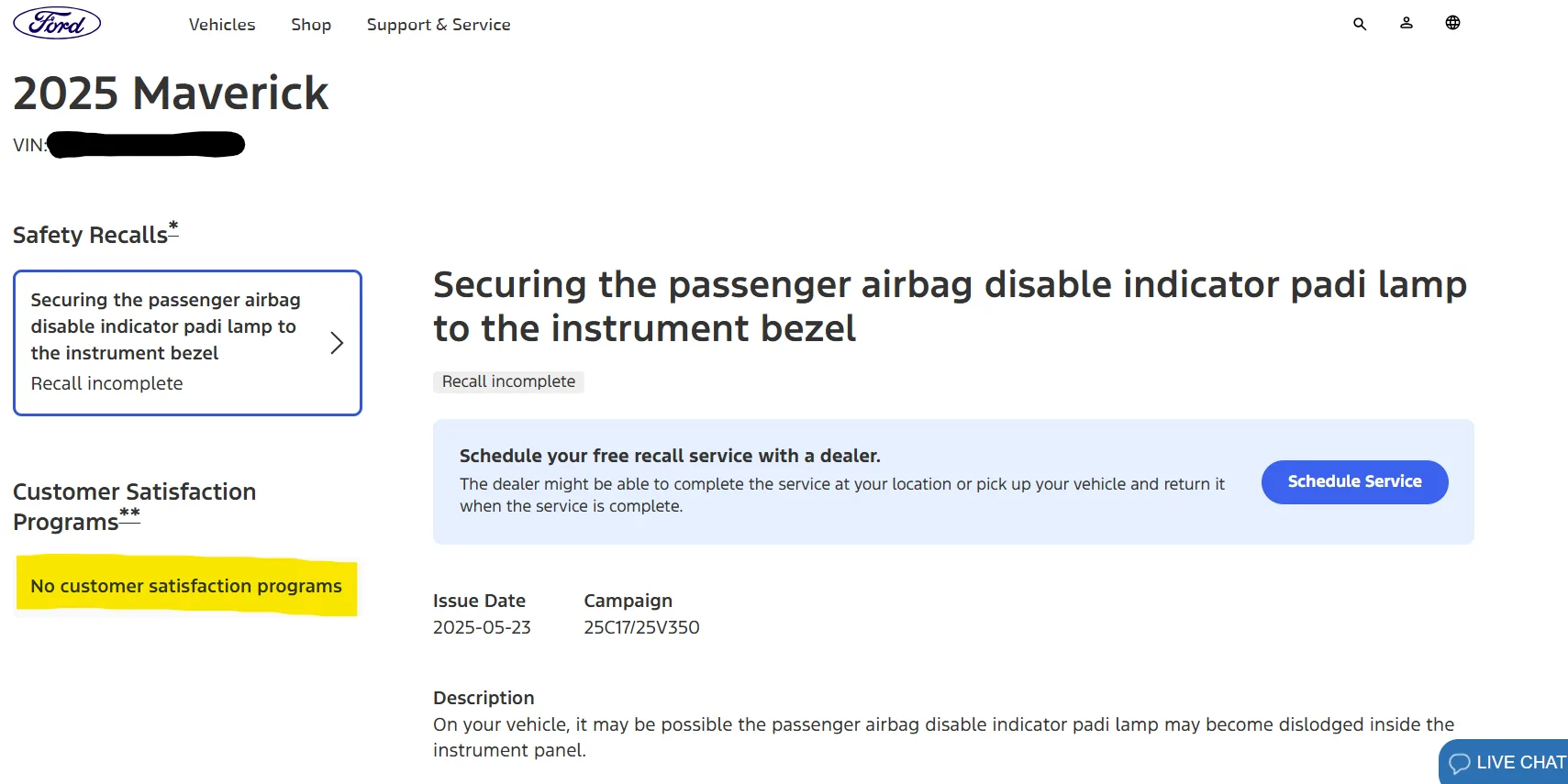

I had mine done about a month ago, no issues,
It’s a good thing to get it done especially if you plan to get the upgrade package they announced at sema ,
