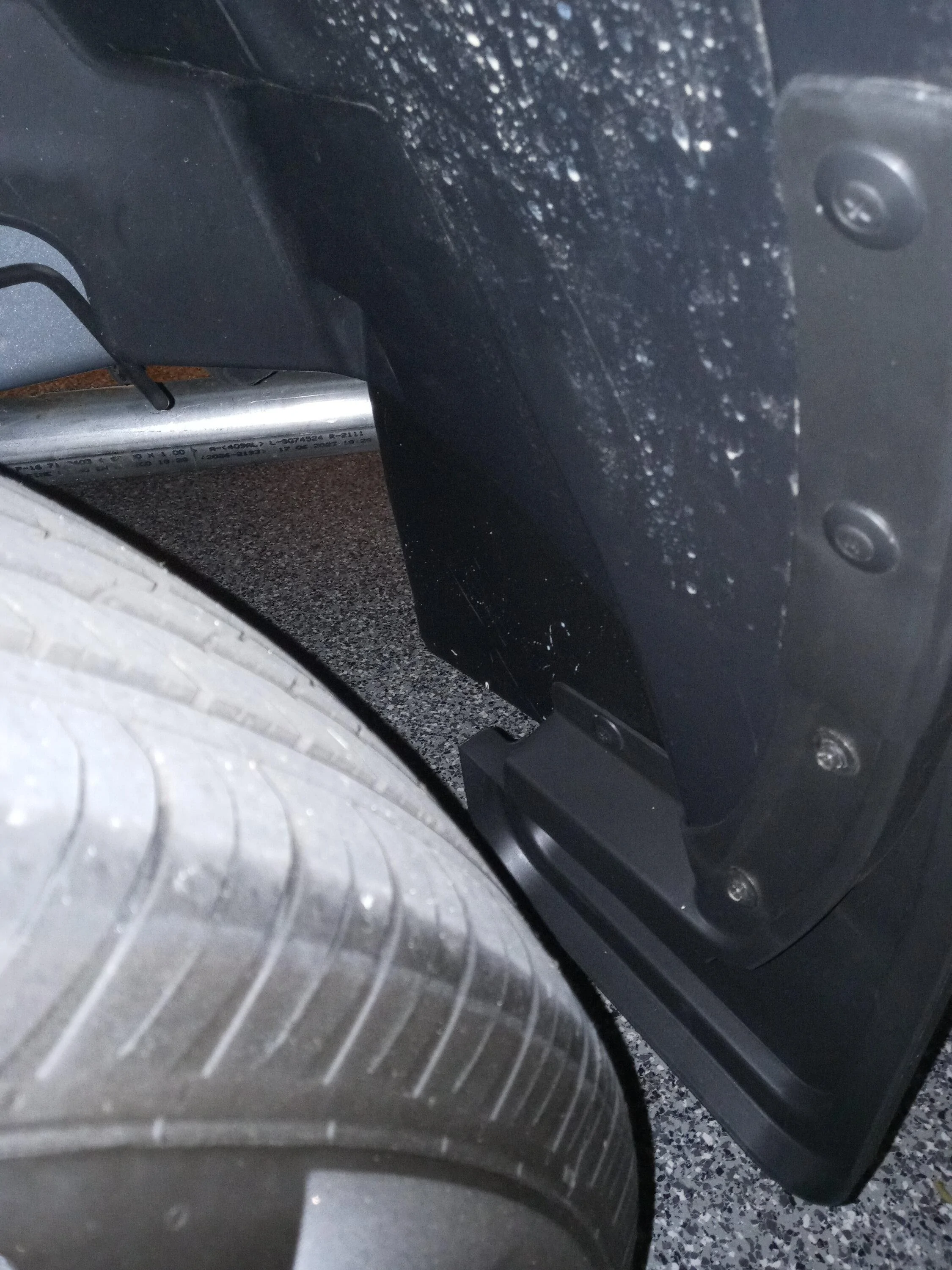

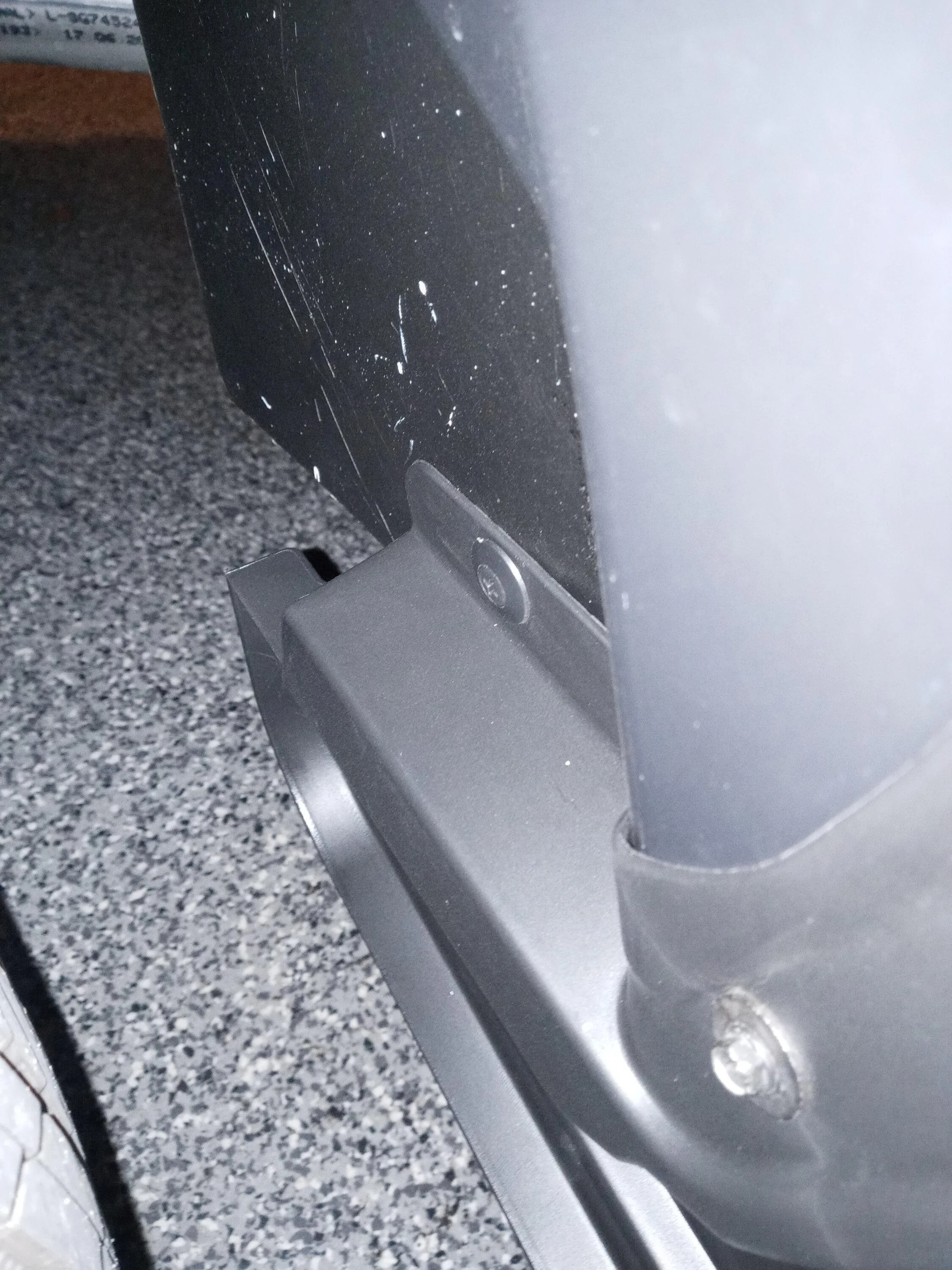

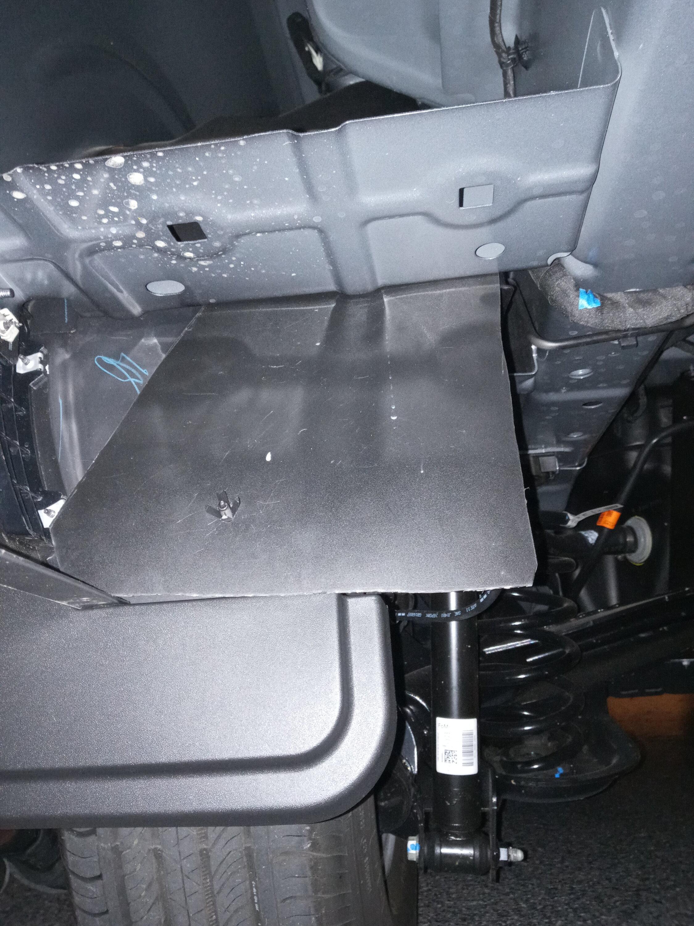

Simple addition for those with OEM or generic splash guards. Added a plastic sheet (cutout from old trashcan) by utilizing existing inner fender clip and adding one to the splash guard as shown below.
Truck has not seen rain yet, so I'm curious how much moisture will get up into that much talked about void.
