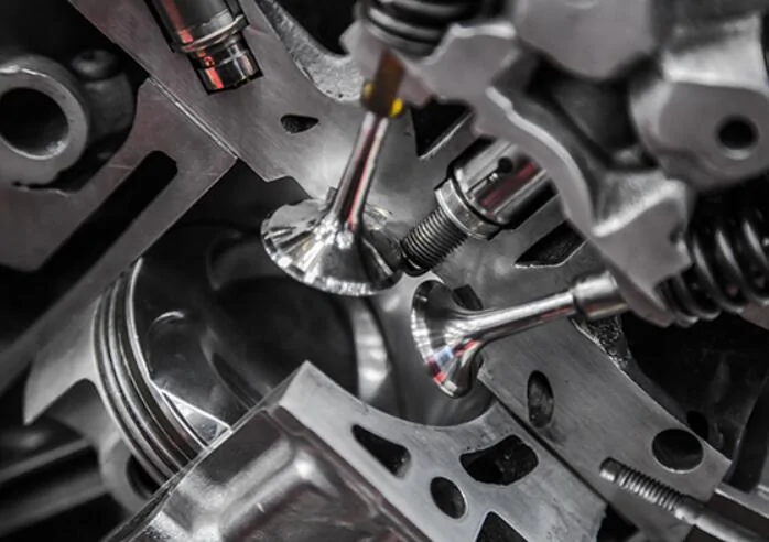

When the valves are opened by the camshaft they protrude into the cylinder. THAT is when the cleaning by additives takes place - in the cylinder. (Yeah, I know. I said I wouldn't comment to this thread any more........)

True, the valve opens, but it is the INTAKE valve that is the issue, and when that valve is open, the air is being sucked into the cylinder VERY quickly..... no way for any cleaning from the downstream fuel being squirted into the cylinder IMHO.
