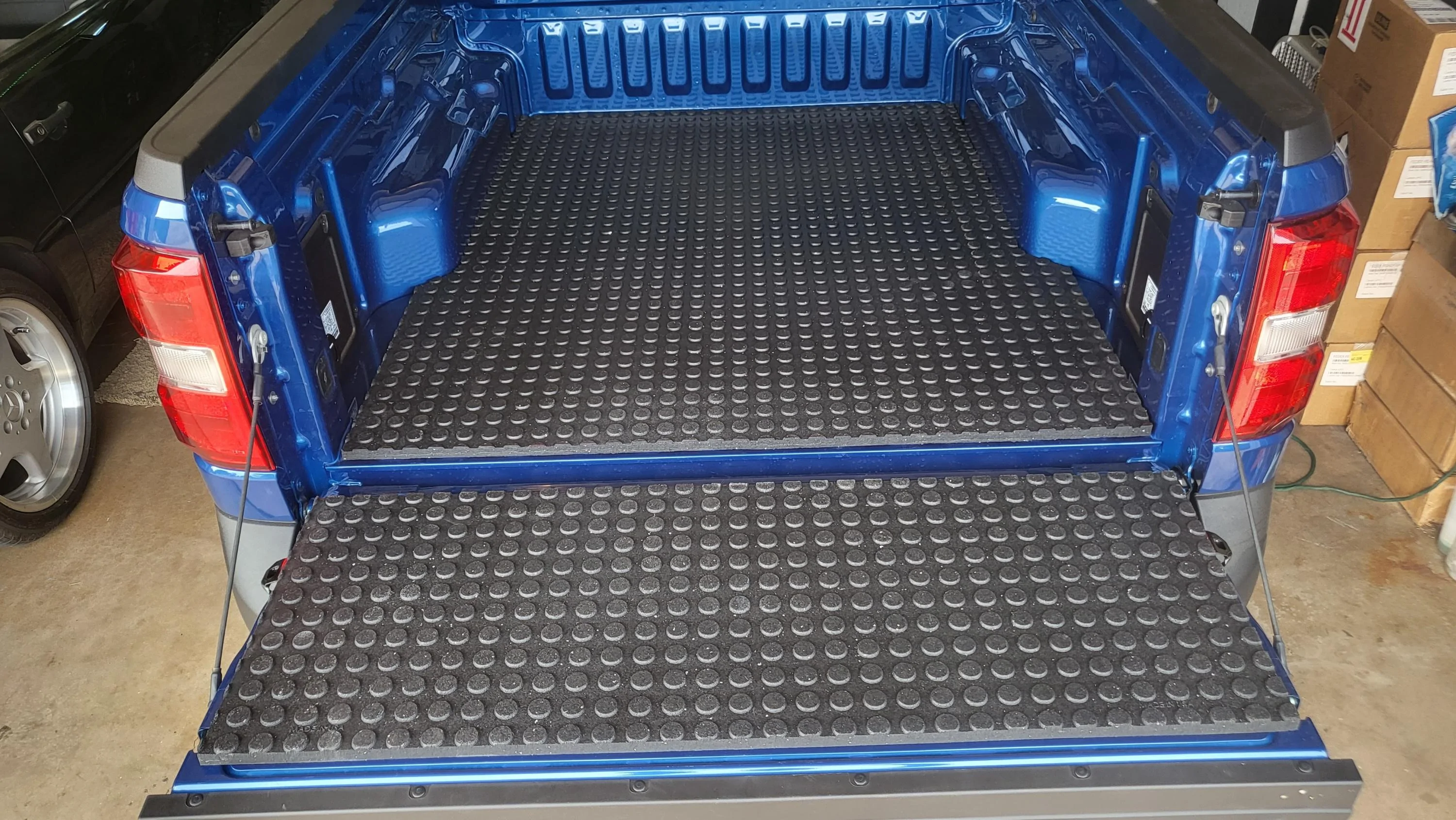

I just got this horse stall mat from Tractor Supply and cut it to fit (exactly enough to do the tail gate too!) 4x6 mat was about $50 and super heavy duty. It can be flipped over to expose a smooth side.

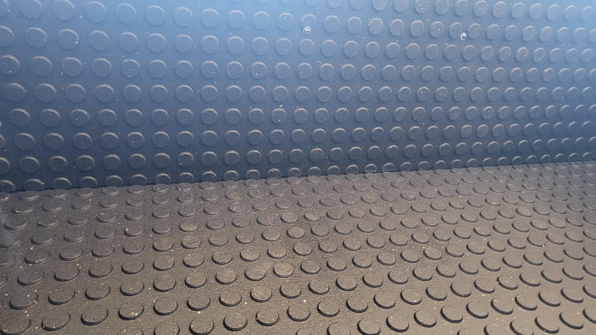

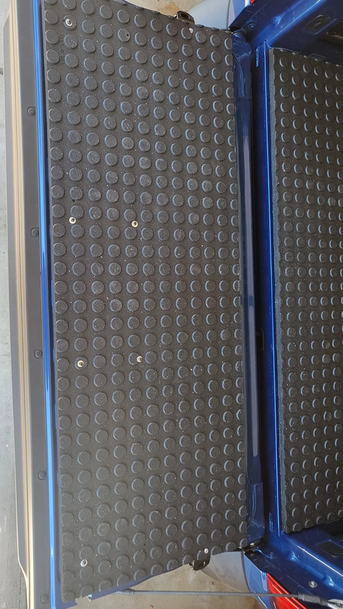

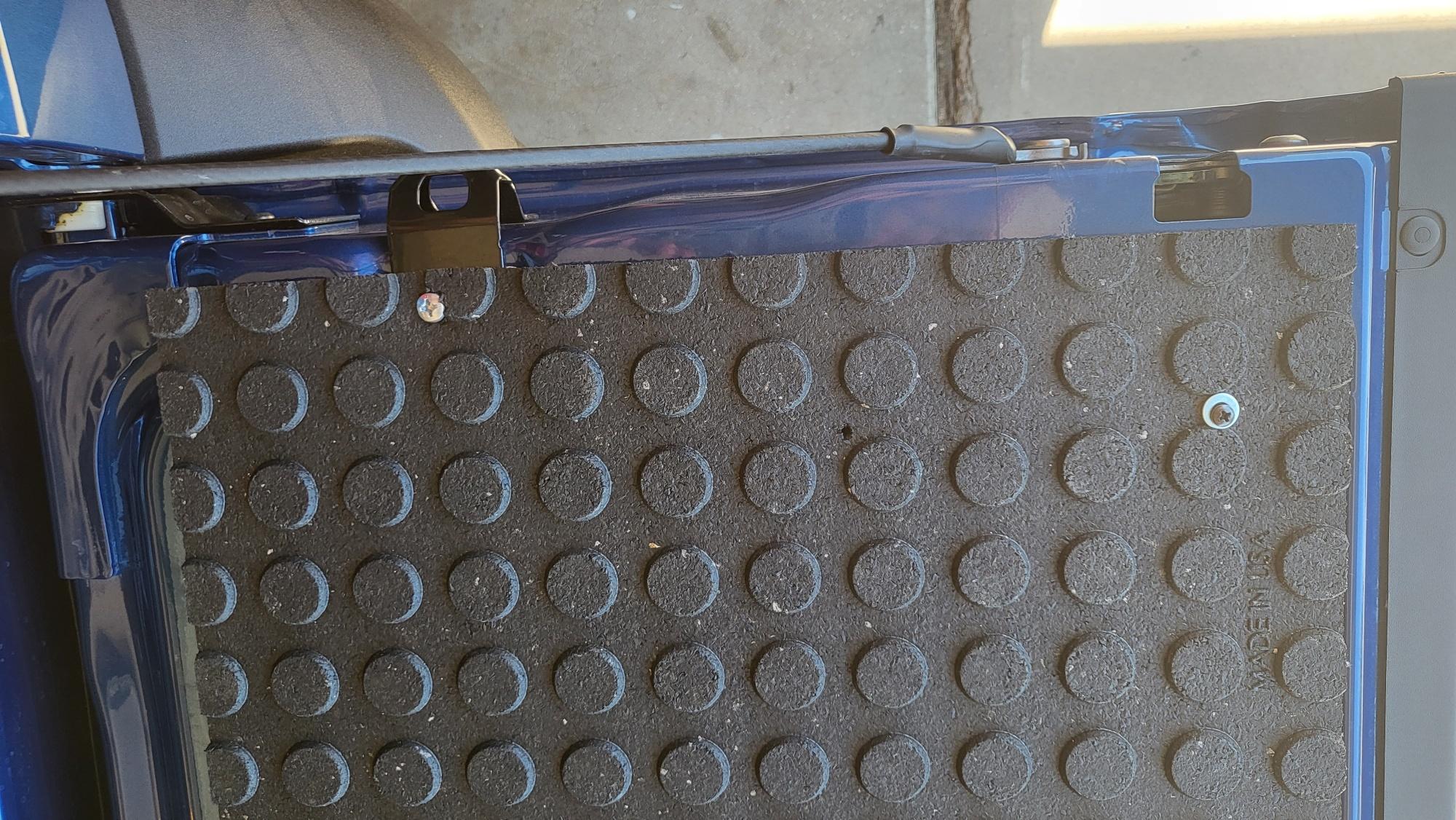

The 4x6 mat is very heavy (100 lbs). The tail gate cut section is probably 20 lbs alone. I used longer screws with washers in place of the 8 screws (I only replaced 6 screws) on the tailgate metal access panel and longer screws on the black (bottel opener) on each side. Very Important - Make sure the tail gate will close before you decide drill holes in the mat for the screws. My mat sits perfectly on top of the floor part of the bed mat (see photo of tail gate closed). I used a crayon to mark where the mat has to sit to clear the bottom mat. The hardest part was cutting the wheel well cuts. I used a strong razor knife (sheet rock knife). It took about 20 passes with the knife to get through the 1" thick mat. Be patient and don't scratch your paint in the bed or the tail gate. I am very happy with the result. Best of Luck!

Tip: 42.5" between wheel wells, cut 2.75" off of each side for 31.5" (Length of wheel well) that is where you start your (45 degree) cut to each edge of the mat. Slide the mat forward flush against the front of bed. Now you can mark and cut where the bed floor ends (should be 54.5"). I mounted the remaining 17+ inches on the tailgate. (y)
