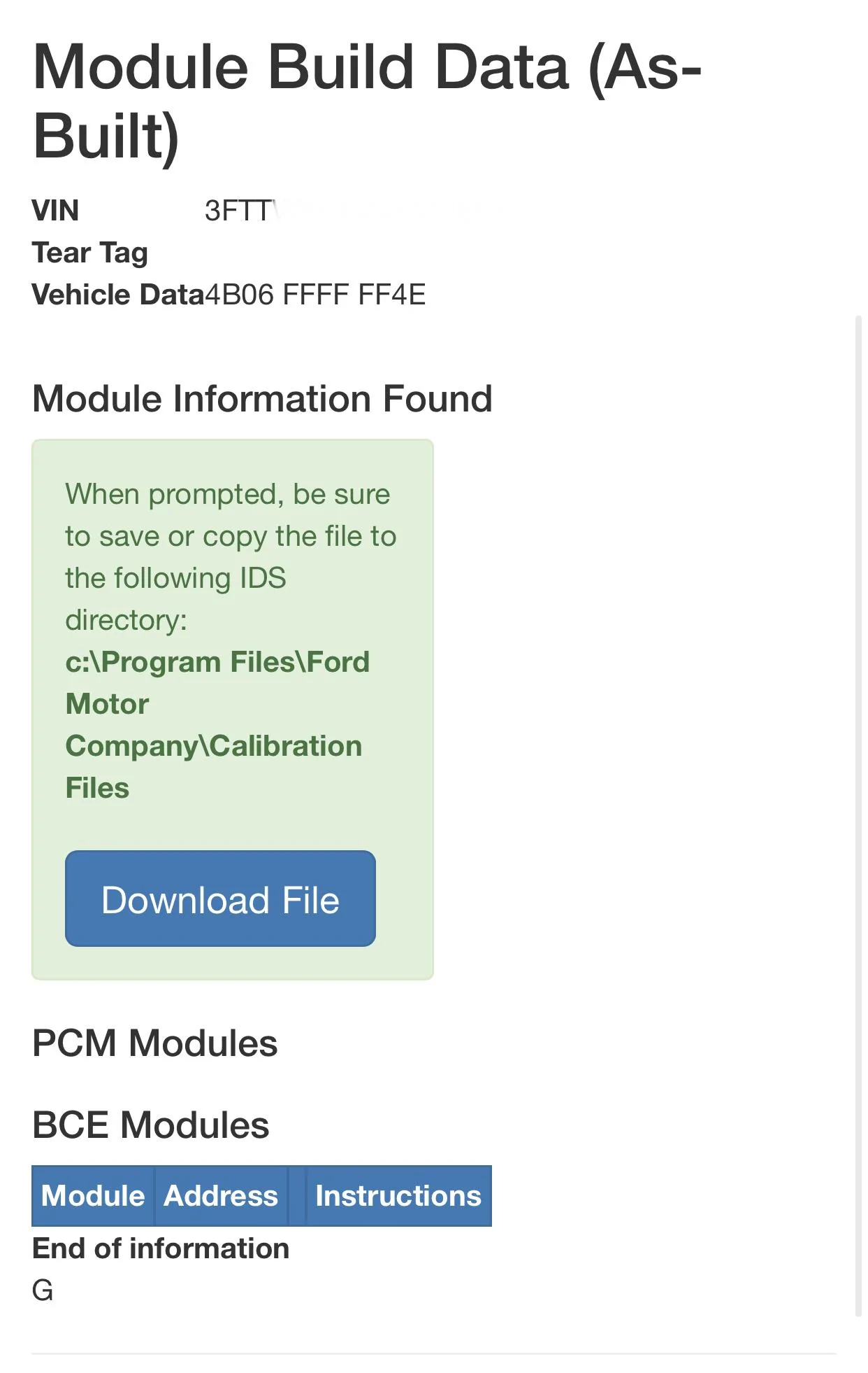

Can someone explain to me how this module tracker works? Ive clicked download file multiple times and it wont open tried 2 different computers and my phone. What is it exactly that i am looking for with this tracker? Thank you in advance

You are looking for your "as built" hexadecimal data for your various computer modules. It is quite useful to have these backup files to restore from if you make a (gasp) error when writing data back using Forscan. What it means is that your new Maverick is alive and out the door of the assembly plant.

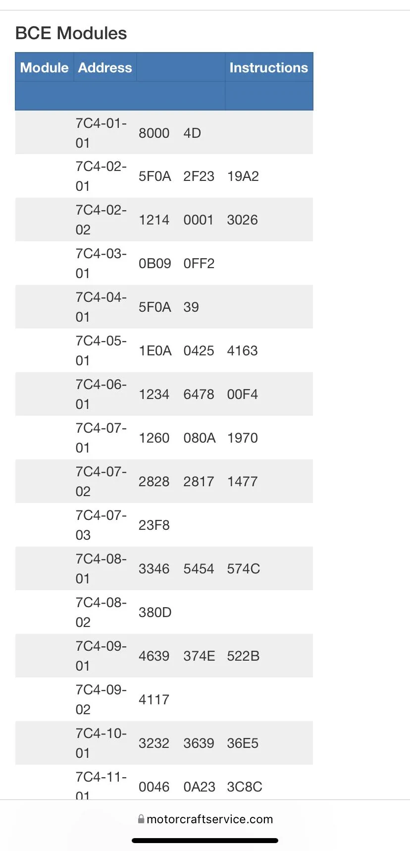

When your truck is alive it will look something like this:
