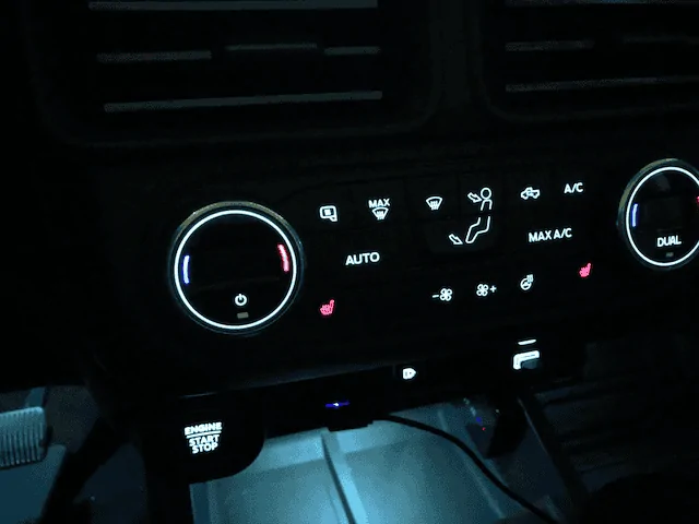

Probably. However, I've already DIY'd the ambient lighting in the console and front foot wells. Also, the Ford factory lighting (at least in the console) is a 3-wire layout that requires a canbus signal to operate. I have no proof, but I believe they are universal across all Ford products and contain the ability to change colors. See below...
There probably is a setting that would allow it. However, there is no wiring that would allow it, so you'd have to rewire it anyway.

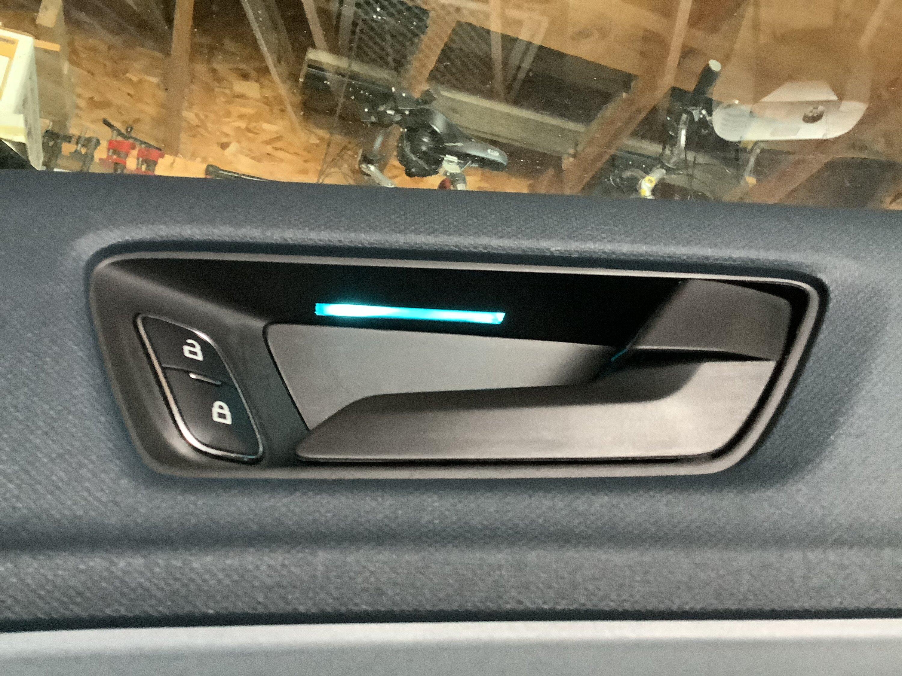

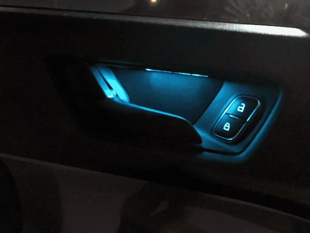

Check out my post on how I used The stock ambient lighting from a wrecked 15 to 22 mustang..super easy and you can choose between 3 colors
