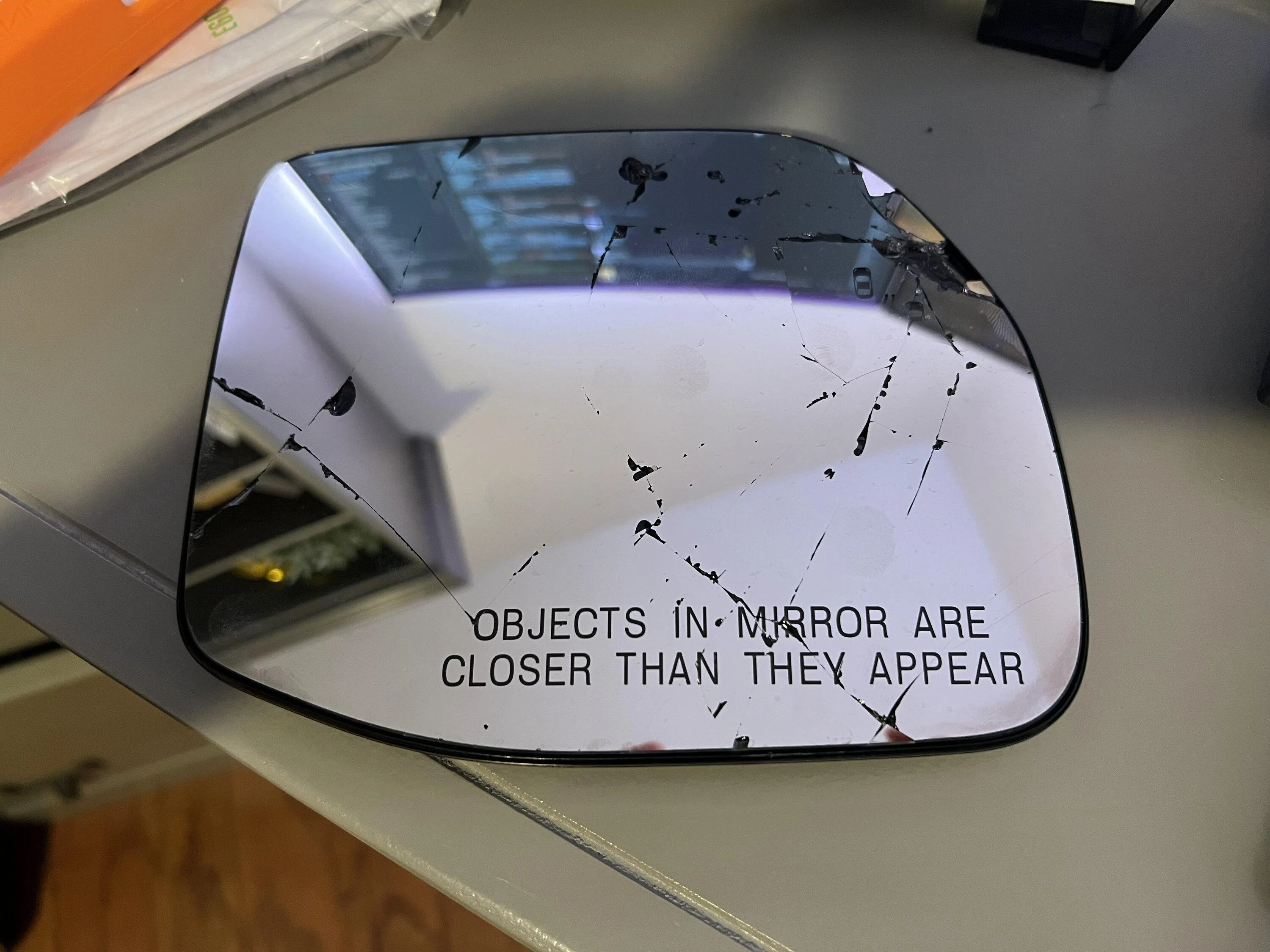

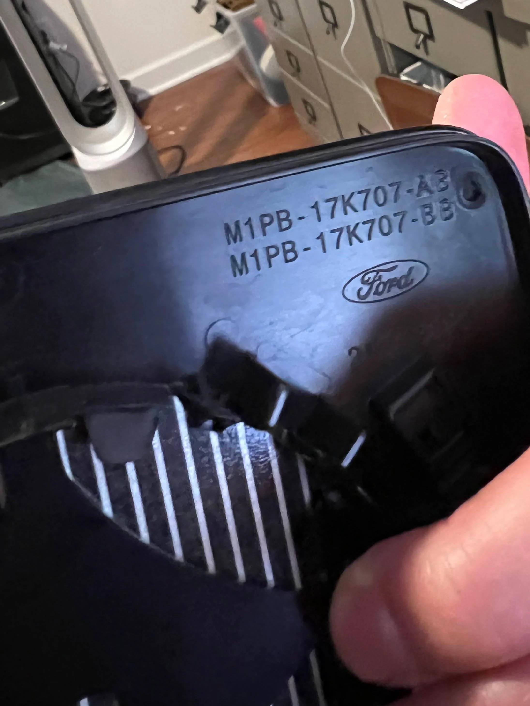

Good evening friends! I have a '22 Hybrid Lariat, which has the blindspot monitoring + heat on the passenger glass. My wife played chicken with a trashcan today and lost, shattering the glass. I'm having a tough time tracking down the part number for it. The part number on the back has felt pretty useless so far. I have been able to find the entire mirror assembly, but not the glass with my features. Would anyone be able to help track this down? Thanks so much in advance.

Message me your VIN and I will get you a part number tomorrow if the glass is serviced separately. In some cases, it is only available as a complete mirror assembly, That number you see on the back is actually the engineering number, not the service part number.

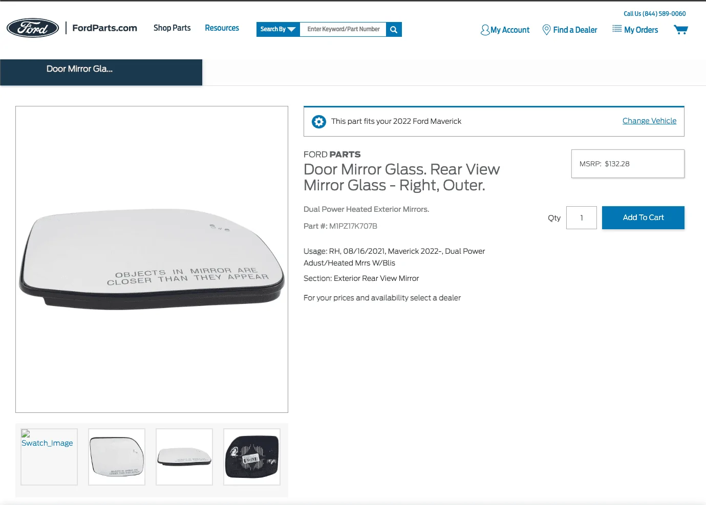

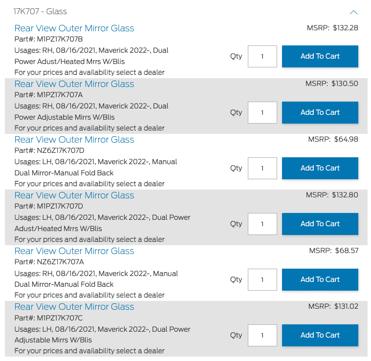

This one? Power + heated + BLIS + RH side glass.
https://parts.ford.com/shop/en/us/door-mirror-glass-rear-view-mirror-glass-right-outer-p-m1pz17k707b
Usages: RH, 08/16/2021, Maverick 2022-, Dual Power Adust/Heated Mrrs W/Blis
Part #: M1PZ17K707B
MSRP: $132.28
