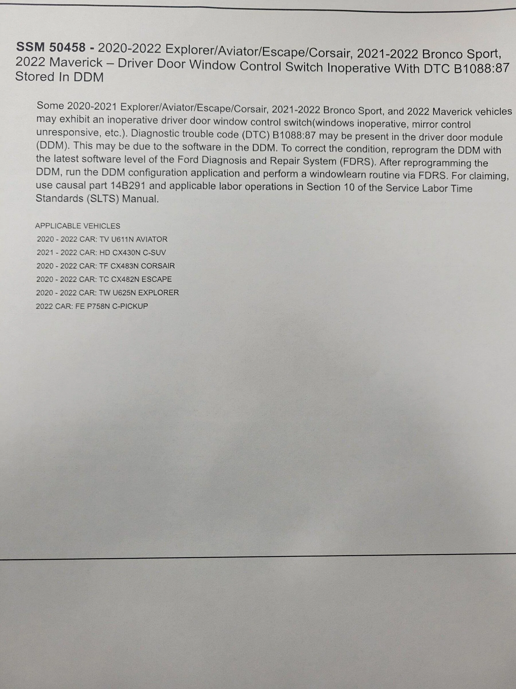

FORD SSM 50458 Driver window control switch inoperative with DTC B1088:87
tancolbert
Tanner
Dec 8, 2021
2022 Maverick XL
If your window switch quits working.
Ford Maverick FORD SSM 50458 Driver window control switch inoperative with DTC B1088:87 20220202_093627
Ccandrews
Craig
Oct 19, 2022
WA
3x volvo, lexus, explorer, expedition
is this the problem where you park with the window down and then later start driving and the driver’s switch cluster is dead? so you need to turn off, wait 20 minutes and then it works like normal again? Or is this a different problem? My January build 2023 has the “dead for 20 minutes” problem too, so it extends beyond MY2022.
