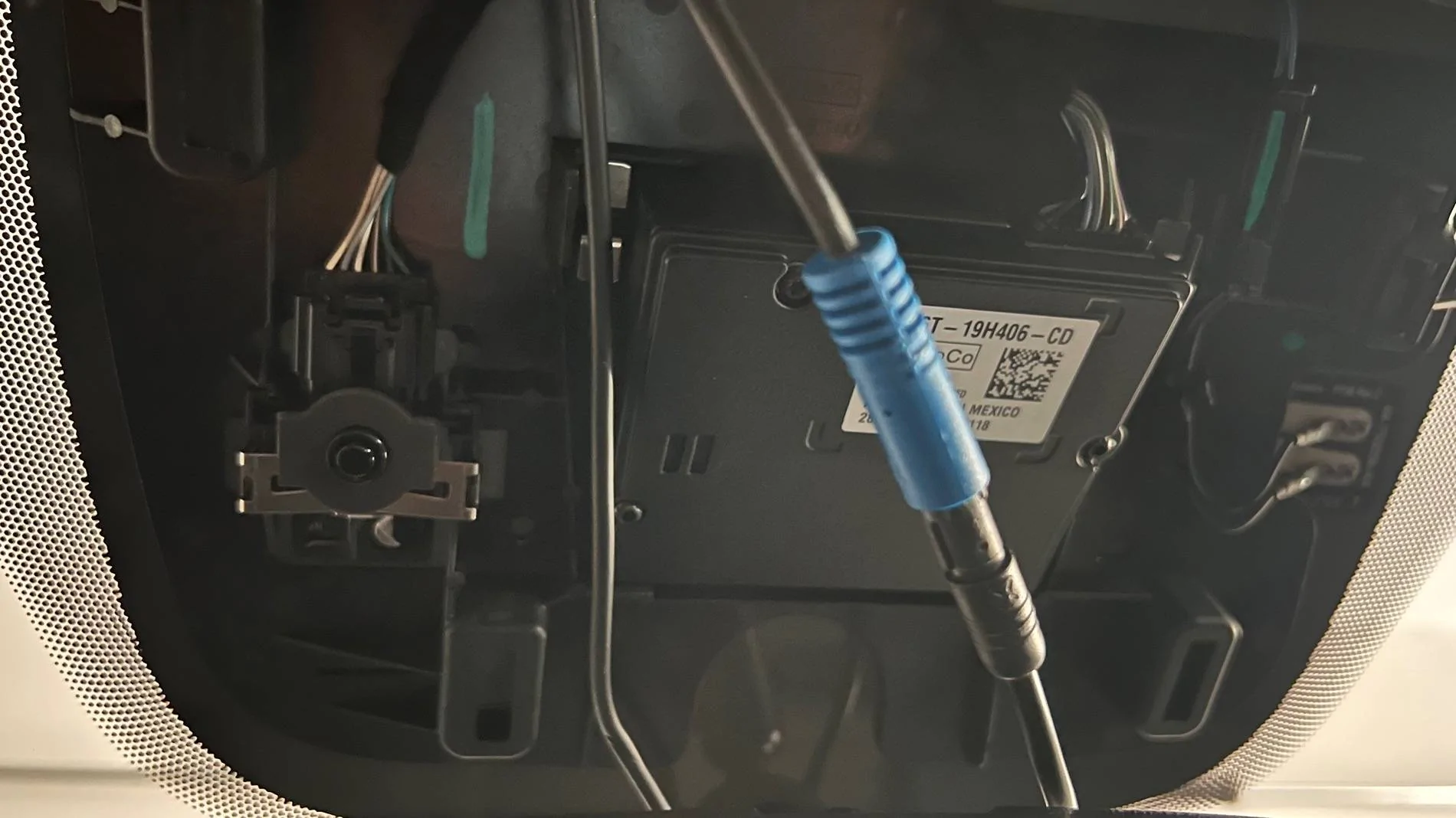

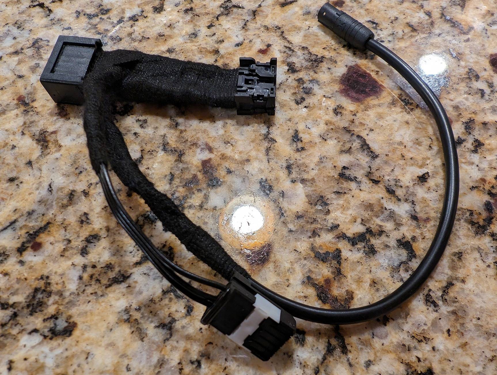

I’m attaching 2 photos and curious which wire you tapped into? they sent me this connector but assumed that since we don’t have rain sensor couldn’t use.

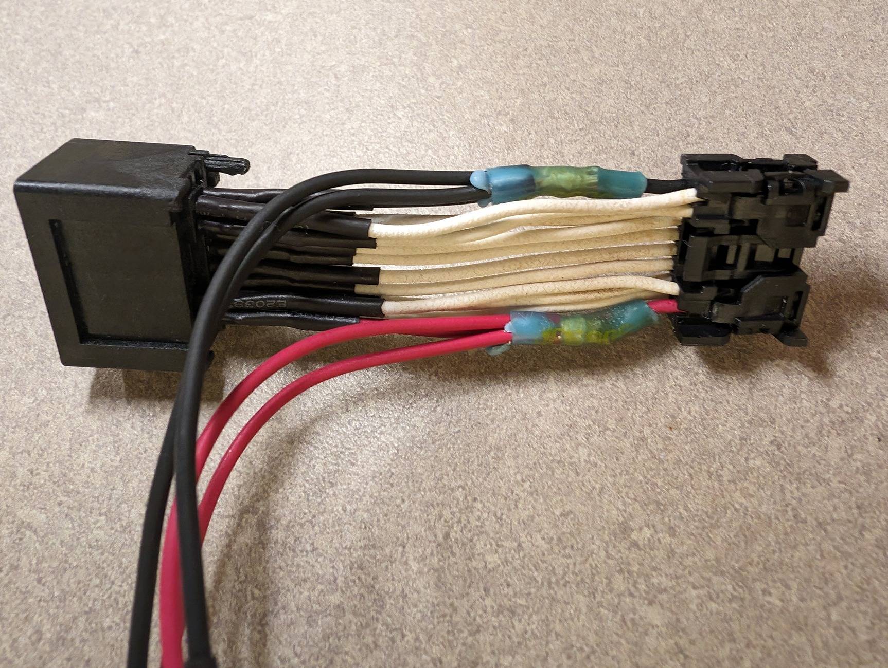

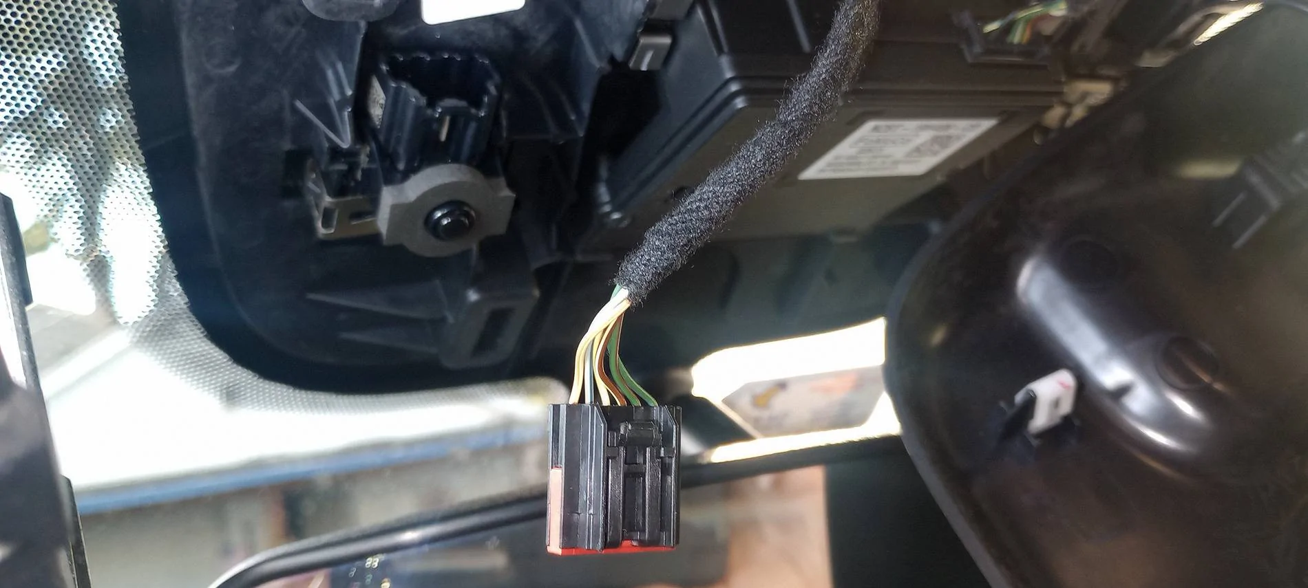

I hacked apart their connector and built my own jumper, as well as added a connector for my homelink mirror. It goes inbetween the windshield camera in the center of the overhead and the factory wire harness.

WOW that's impressive. Way above my skill level. I'm hoping that maybe I just got a bad one and the new one hooks to the cables I've already run and are tucked away nice.

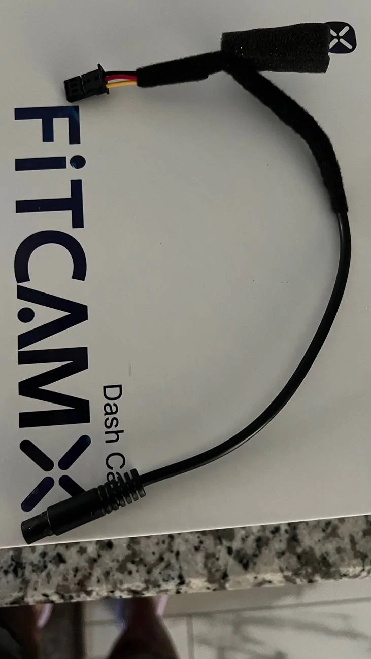

I also bought the FitCam. I pulled off the ceiling cover and found the Connector that I assume is used for the rain sensor ,(that I do not have on my 22XLS). My first thought, ooooh I bet I can use this?!?
Do you mind telling me the details?
What's the wiring schematic for the plug?
Where and which mated connector to buy?
Which fuses? I assume it's not currently powered and needs fuses?
