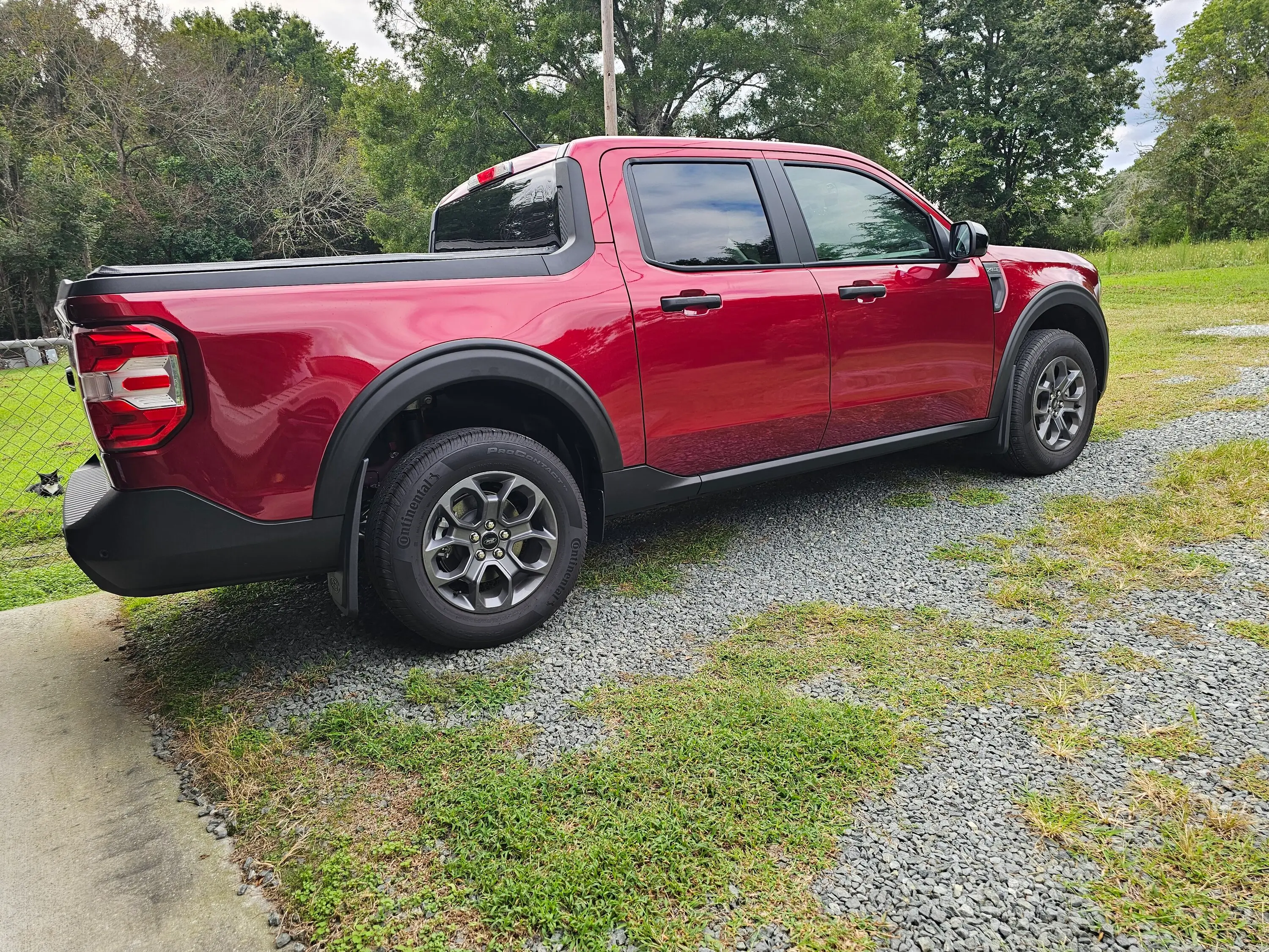

They look good with the red! What brand are those and the mud flaps?

Hey Cancun, both are OEM
The mud flaps were on first. They had to take them off and do a little work on them so they'd fit with the flares. Surprised it wasn't a perfect match up.

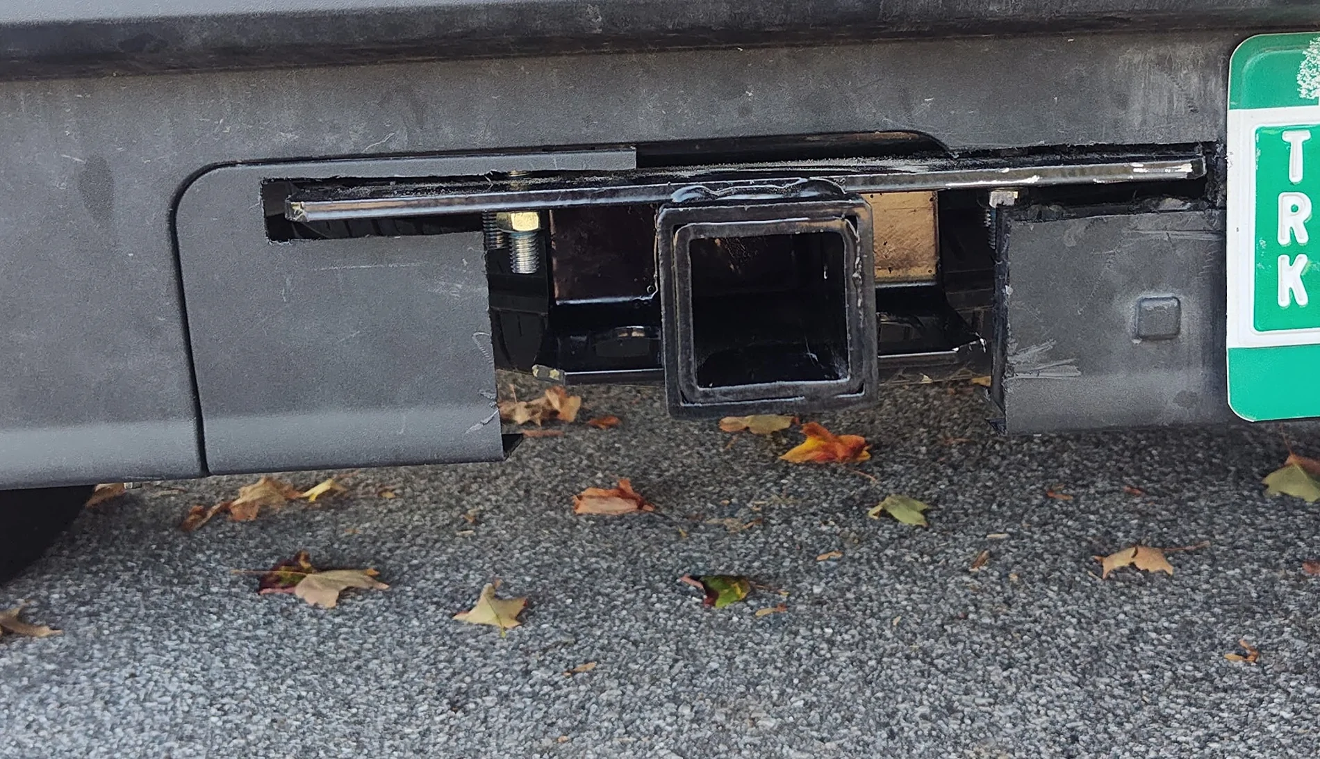

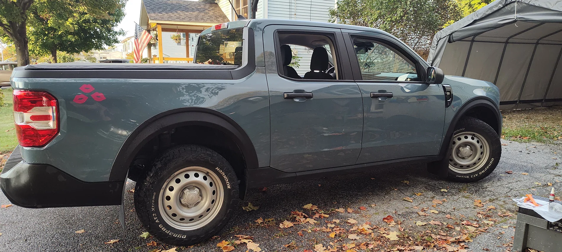

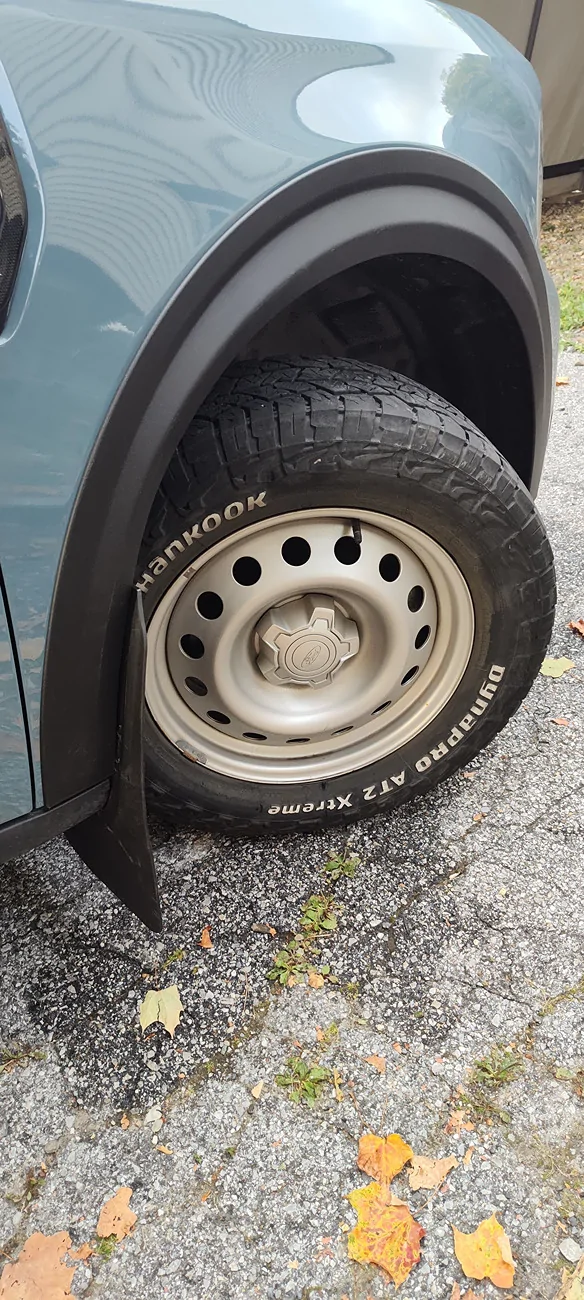

I also added fender flares but I also put on mud flaps and a hitch receiver. Got the receiver from Harbor Freight. It's the bigger one w/ 5000lb capacity and as you can see it is too big and I had to do some serious cutting and trimming but it came out ok. Probably should get the smaller one a 3000lb capacity. I did not fully removed the bumper cover, I just pulled it away enough to slip 2 U bolts 1/2" x 2" x 5" . In had to drill 2 - 1/2" holes in the mounting plate and I used Lok-tite and lock washers for the bolts. Mud flaps and fender flares are Mabett and I had to do a little cutting and trimming to get them to fit together but it came out pretty nice I think. I like the appearance of the fender flares. I watched J.C.'s video ( The Cuban Redneck ) for instruction on how to remove the bumper cover.
Ford Maverick Fender flares installed hitch receiver
Ford Maverick Fender flares installed fender flares
Ford Maverick Fender flares installed IMG_20250918_180321783
