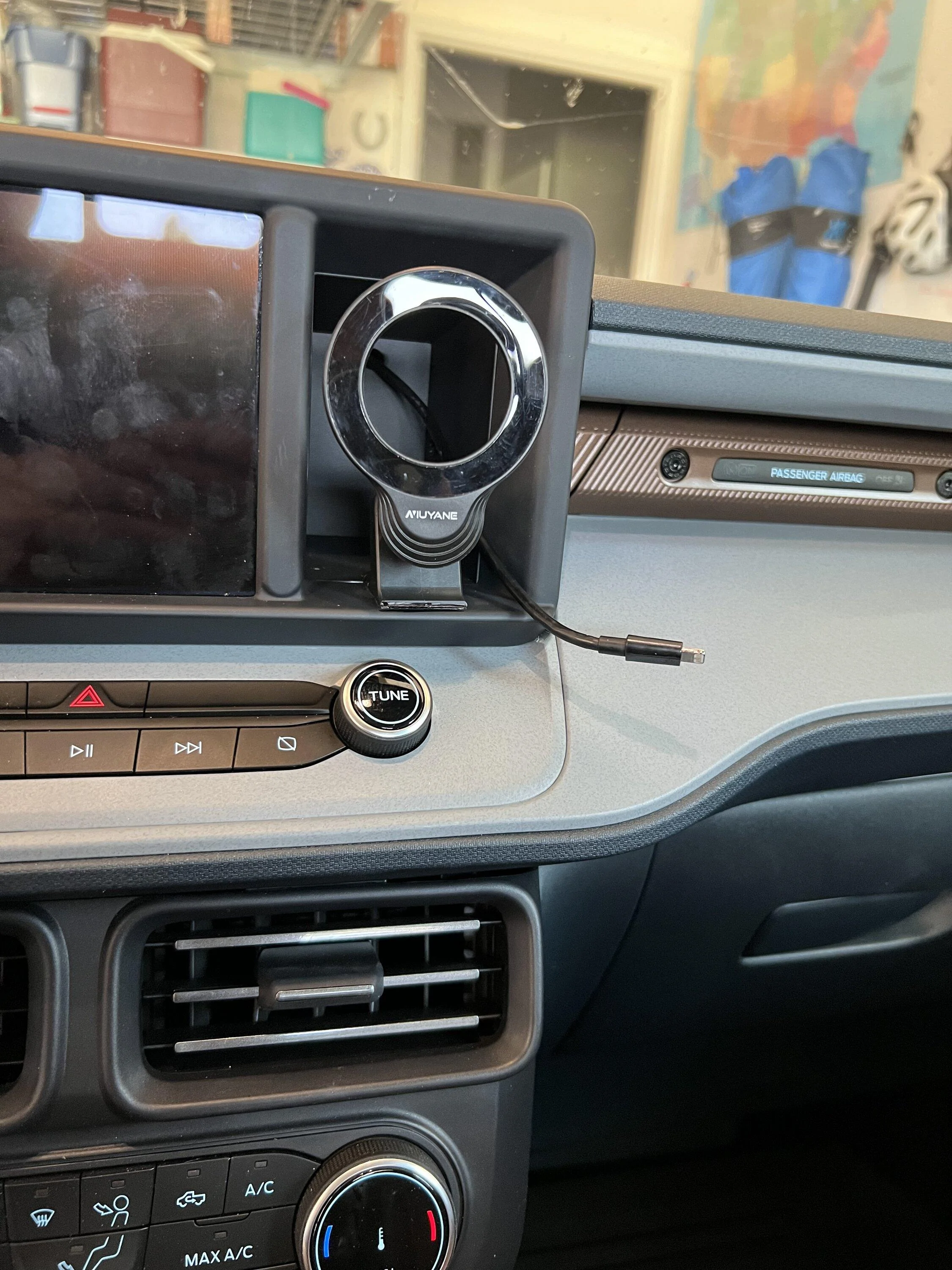

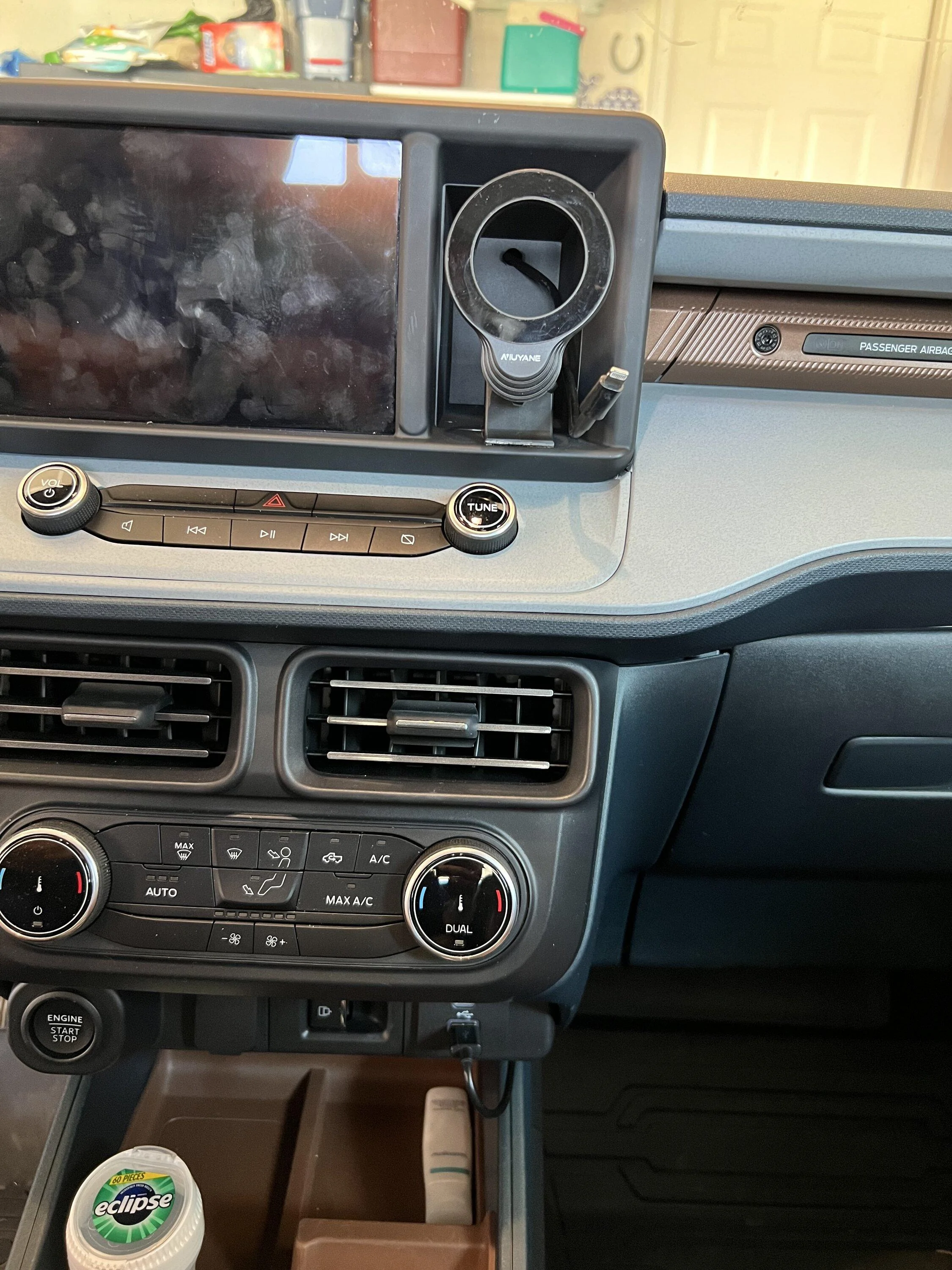

Filled up the cubby with a MagSafe style iPhone mount..works great. Took out the radio/head unit (google it) and fished the charger cable up from behind the glove box and up into the head unit area. Drilled a hole in the top of the cubby..
