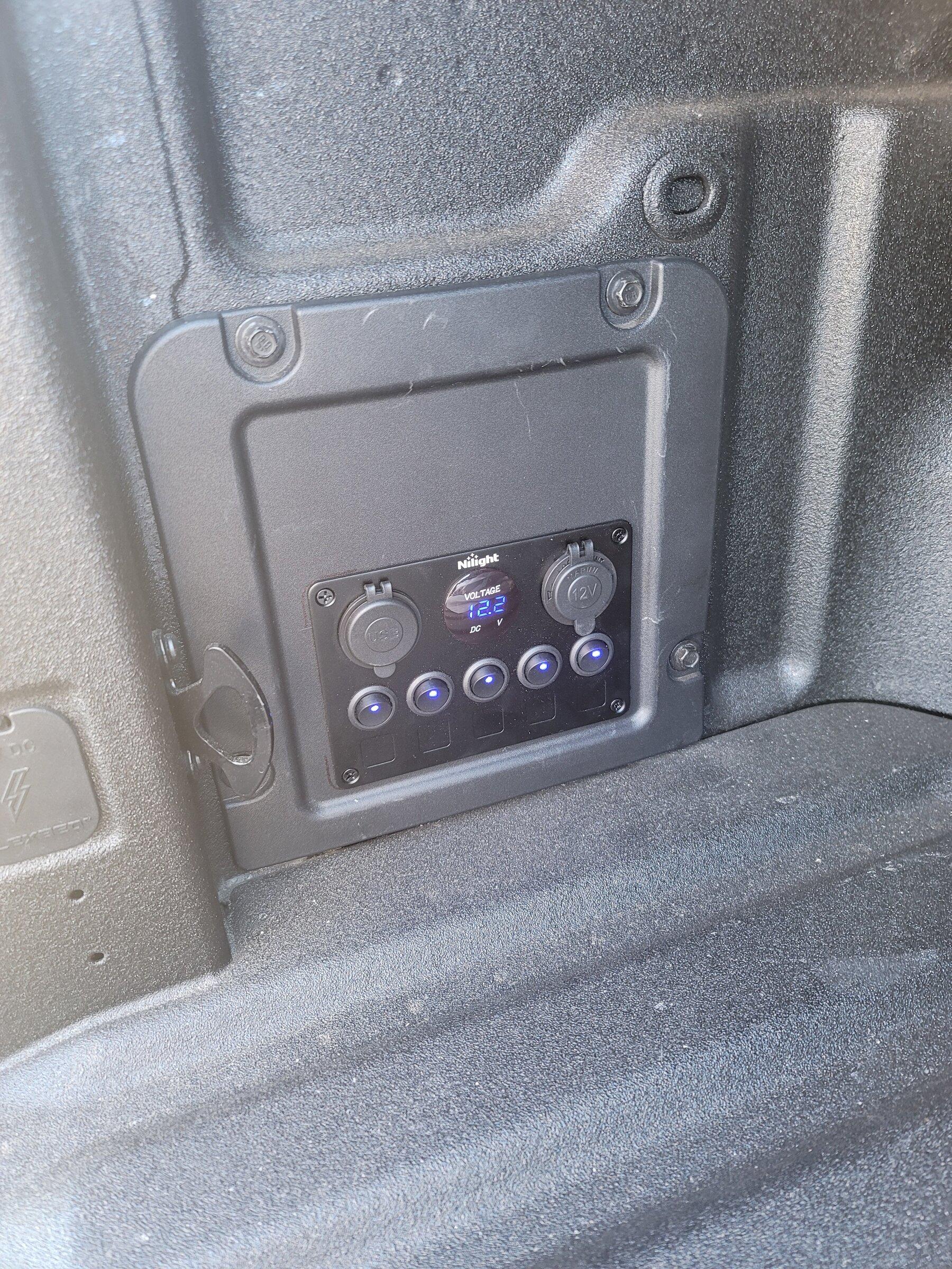

Finally got a quick minute to add a couple small things to the truck. Nothing attached to the power yet but will add LED bed lighting and maybe some spot lights if I can make it look clean. Not sure what else to add to the other spots.
As of now it's tied in to the 12v wiring in the bed. Going to eventually run a power cord to the battery to have continuous power.
Also added the switchback bulbs for the front turn signals. There is a hyper flash even though i thought the Alla bulbs were supposed to not force it. But it doesn't really annoy me.

can you link that panel? Why does it have five switches?
