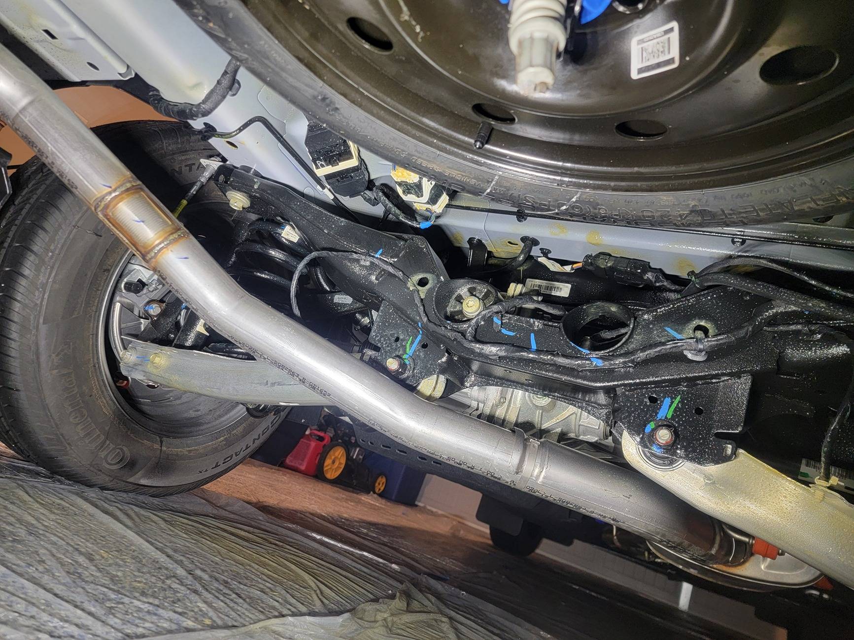

Phone giving me problems, this is just a quick n dirty rust & moisture proofing DIY undercoating I did after watching some YouTube videos on DIY undercoating.
Why do it? Look under your truck with a flashlight at those plastic electrical connectors to your brakes, taillights & rear differential sensors. how soon till they're coated in a layer of salt & start corroding from moisture ingress.
Strong recommendations not to spray rubberized undercoating, it gets nicked by rocks & then when moisture seeps in the nicks, the rubberized coating traps the moisture at the streel.

5) before warming the can you're suited up. Start spraying the inside channels from the top of the vehicle above wheel wells & work your way down.
I started from back removed the black covers & rubber grommets, stuck the red tube into the holes from top down & sprayed up, sides & a little down, heat will make it migrate down over time.
A work light is great so see where the spray is going, when the lanolin is warm & thin, it's easy to wipe off overspray on the paint with a rag.
Otherwise cold it's gooey you'll need a hairdryer to soften enough to wipe off clean.
If it's cold outside your can gets cold, put it back in the warm tepid water weigh it down until the can is warm again, shake it & back in the warm water till all the stuff feels warm after shaking.
The difference betwen warm & cold spraying is horrible, warm liquid coats a wide area evenly with a thin layer, cold spray comes out as a clump like expanding foam & doesn't spread with fingers too well.
6) If you do nothing else, spray those electrical connectors, especially the backs where the wires go in, when those metal connecting ferrules start corroding from road salt & moisture youre gonna have problems.
& spray all your grounding terminals screwed to the chassis. Lanolin is non-conductice electrical safe you can spray anywhere. All that cloth wrapped cables just spray it keep sealed from moisture.
7) then try to spray the inside of the frame through the holes. I kept losing straws so you have to hold the straw in 1 hand & can the other.
There are undercoating can tops with flexible tubing makes it much easier, I'm ordering some now for Part 2.
8) spray the suspension, springs up into the top of the cups, steering knuckles, control arms, everything.
Except try not to get any on the brake disk but a ton of YouTuber channels with shops said it'll be fine if you get some spray on the disk Just drive around brake to a stop a few times & it'll wear off.
CV axle covers recommended not to spray only because if 2 rubber bellow sides stick together so bellow can't flex it might strain during driving & tear.
Honestly for me better lanolin than road salt, spray lanolin & dump some talcum powder or something on it so a buildup & not sticky.
9) spray over any bolts, inside areas that moisture or mud could settle in a muddy drive, the screws holding your underpanels on. When you get time to take the panels off you won't face rusted stuck nuts on corroded screws.
