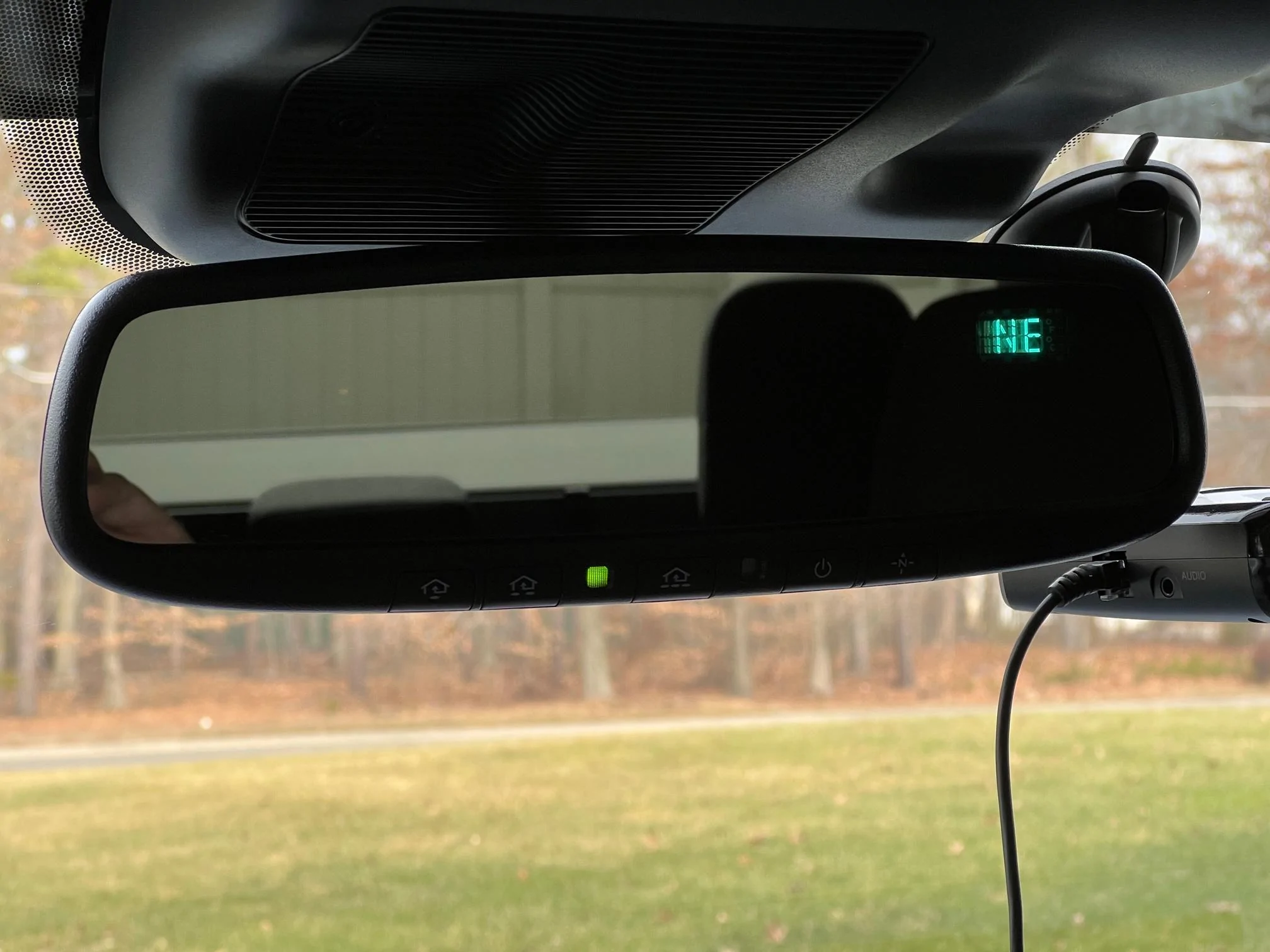

I also finished the Kia Cheapy mirror upgrade. I was able to use the wiring to get me within 8 inches of the fuse panel. Really easy to do. I added 10" of wire & fuses tapped to circuit 3. Calibrated the compass, programmed the door openers and voila. The auto darkening is really great. Best bang for the buck modification yet.

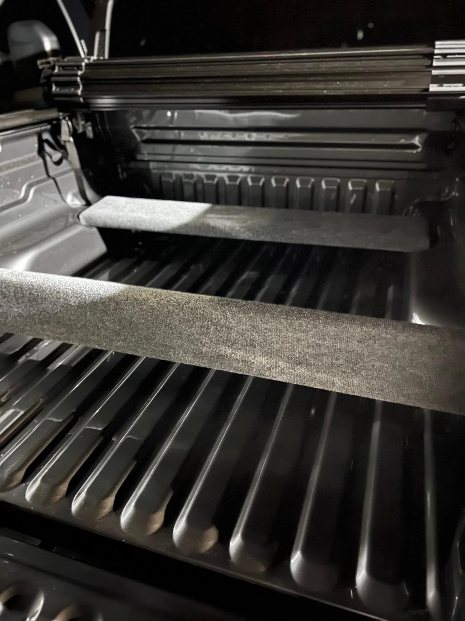

Lastly, I had some boards from another old project laying around. Cut the divider board 54.5" and the ledge board (front) to 45.5". Going to grab outdoor carpet today and probably over the weekend I will sand and carpet the boards. I want to round the edges of the boards off a little with a palm sander.

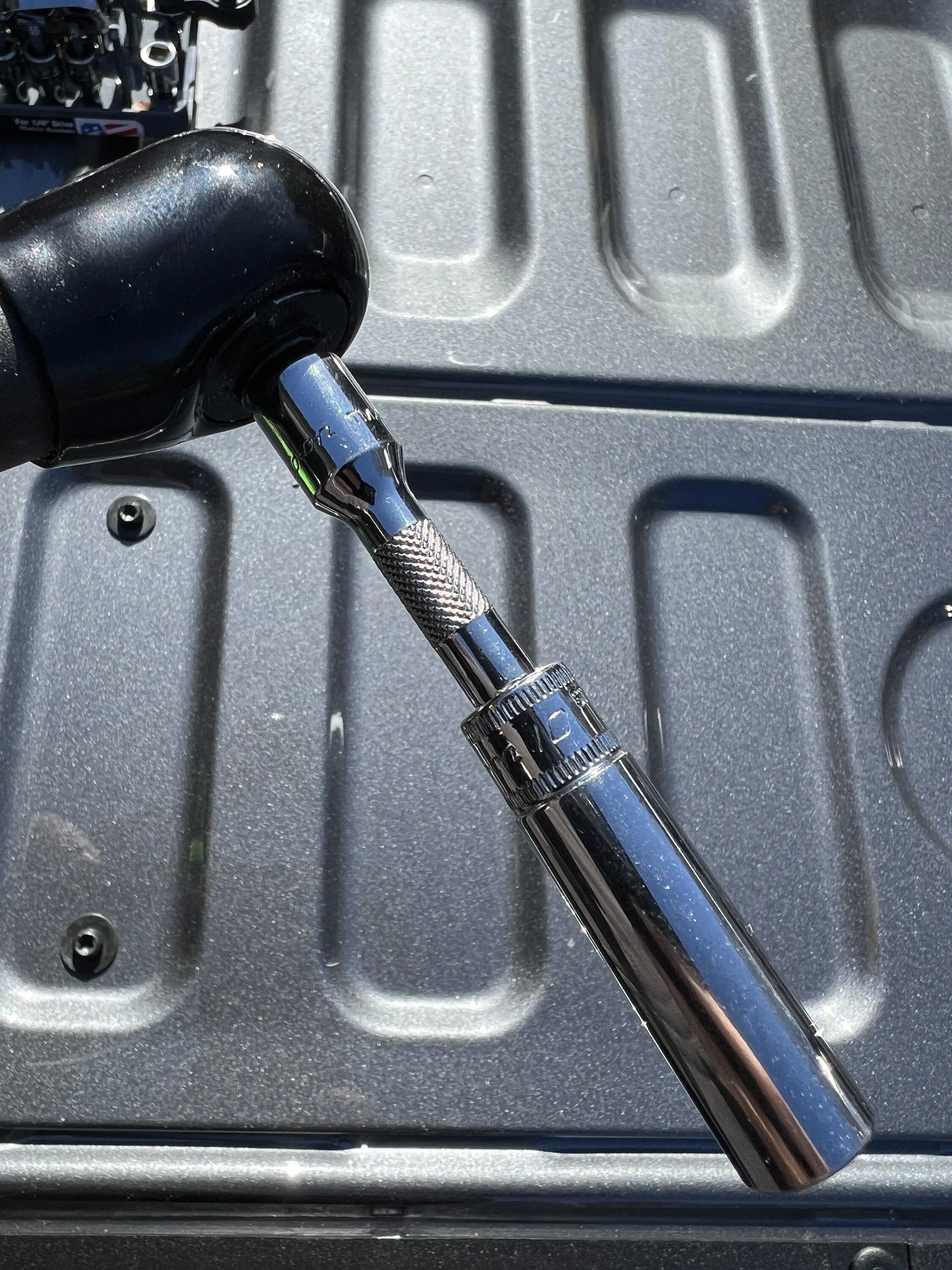

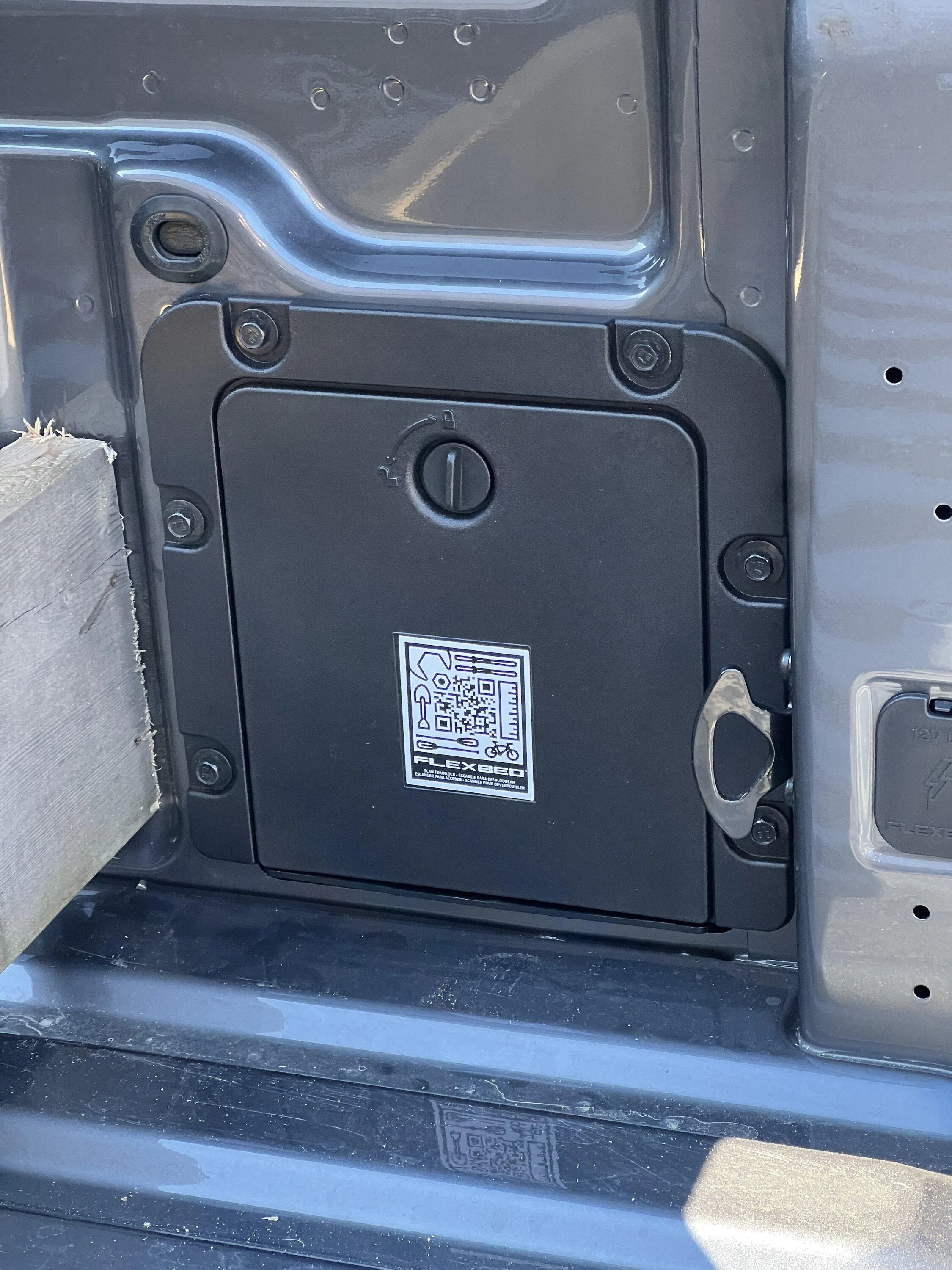

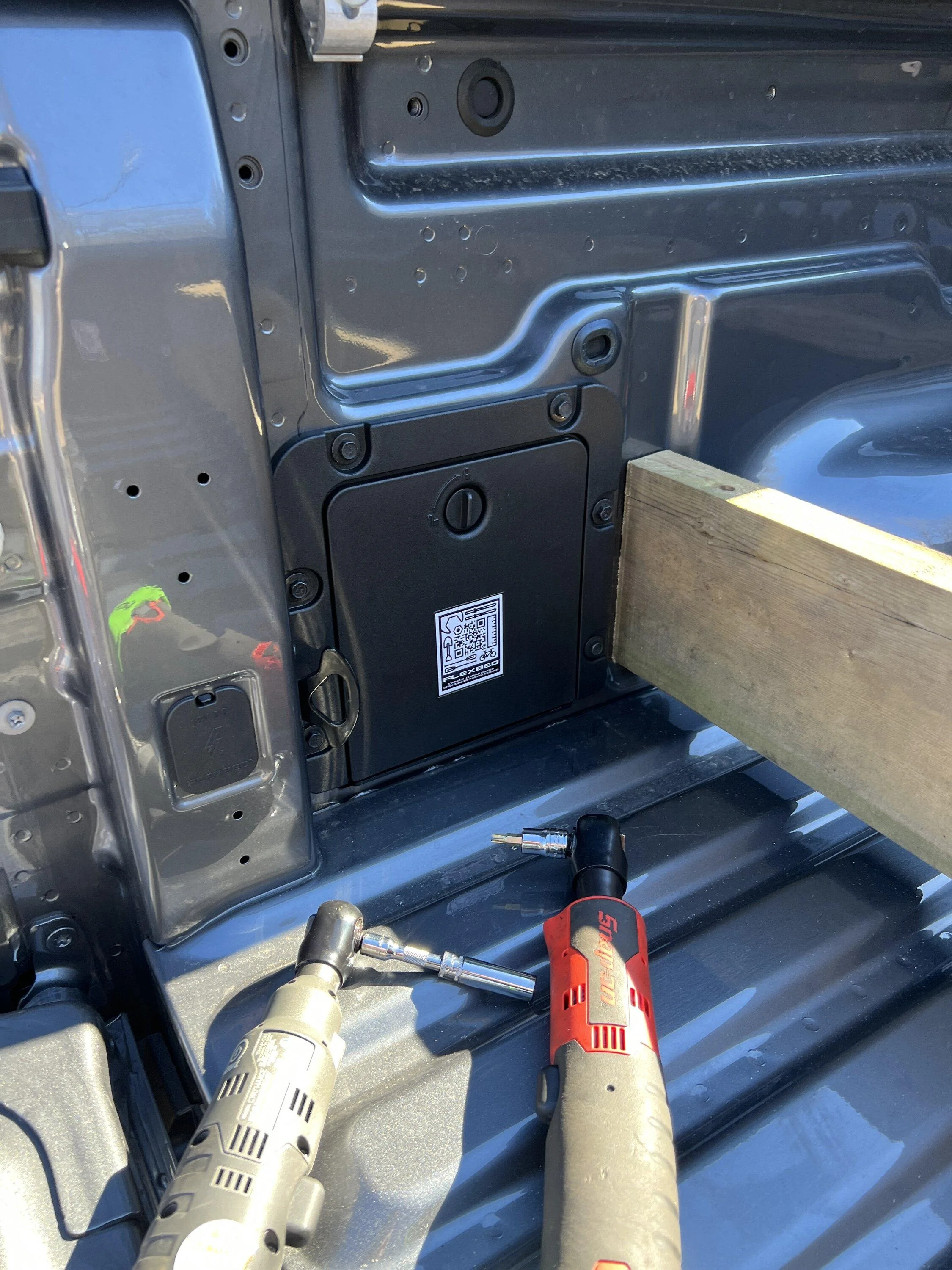

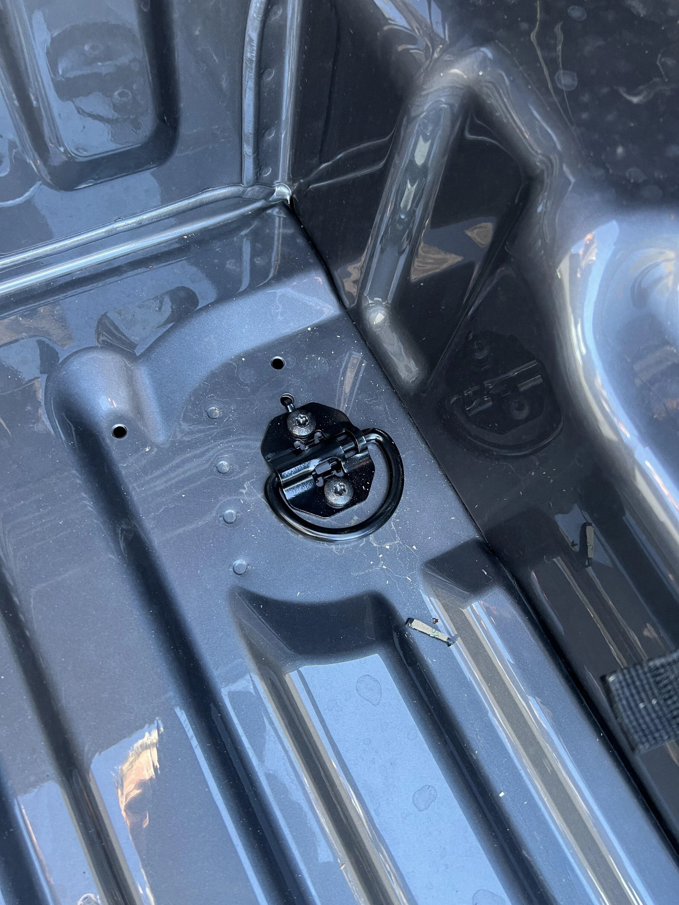

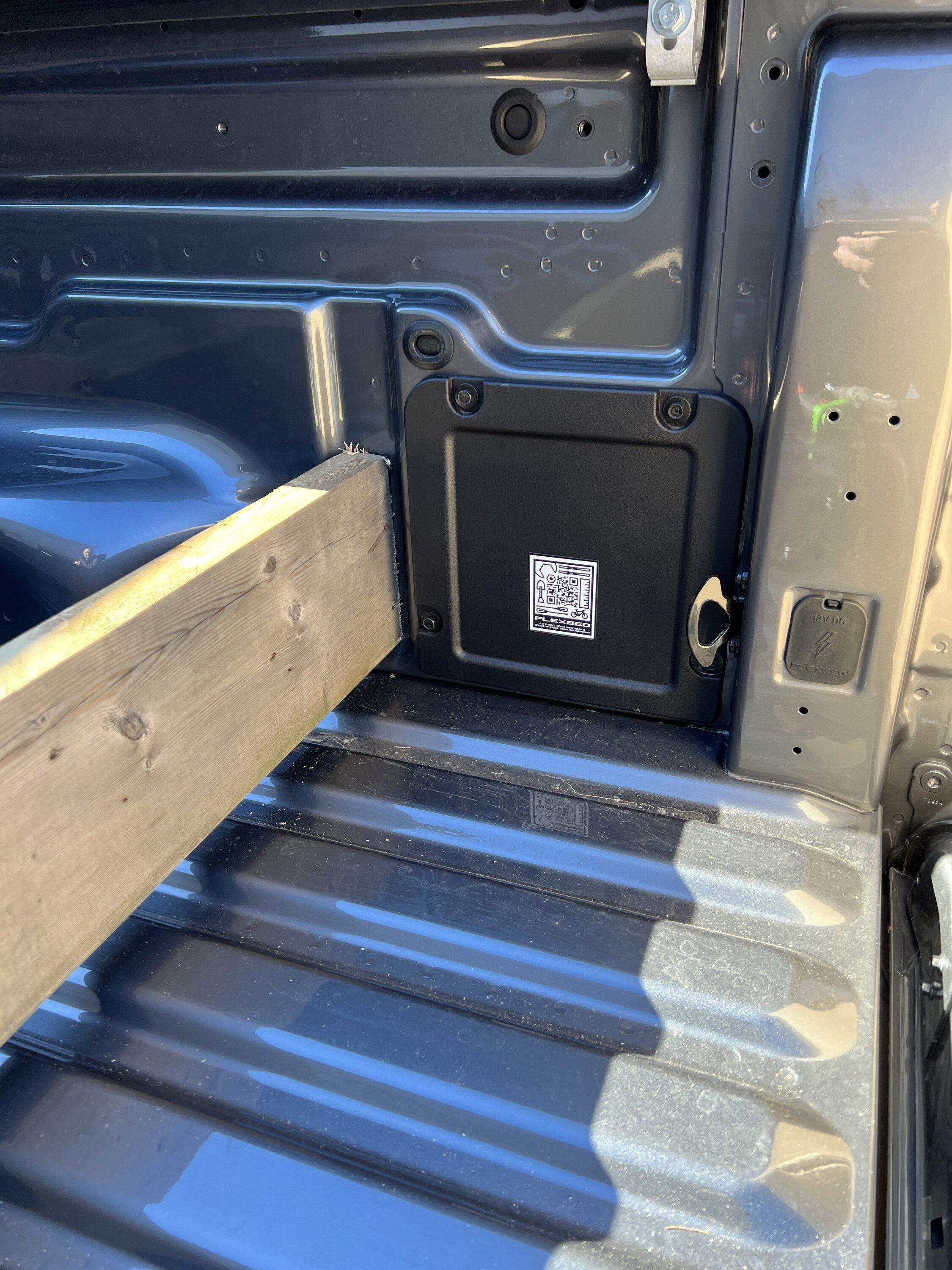

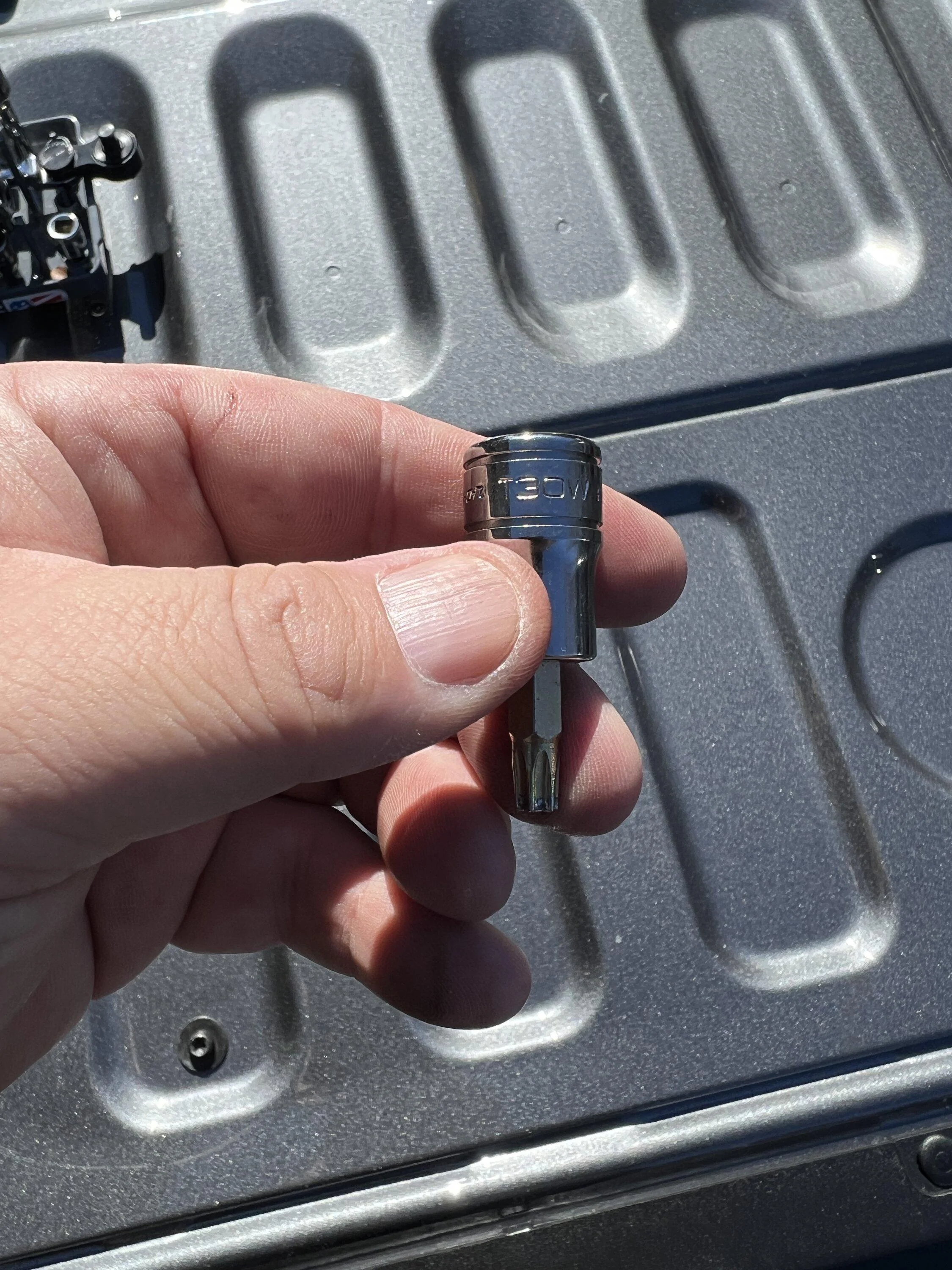

So I grabbed the bed cubby’s, the front bed rings, rear top tie downs and associated bolts today from Ford. Installed the cubby’s. The lost the rear bed d-ring bolts so they’ll be dropping them to me Tuesday. The bolts for the cubby’s are a 10mm and the d-ring screw are a t30. Went in easy, took 5 minutes each side.
inalso installed the fron floor bed tie down. Those screws were a t35. I just used an impact and sent it. I could’ve threaded the holes but I think my way was faster with same result.

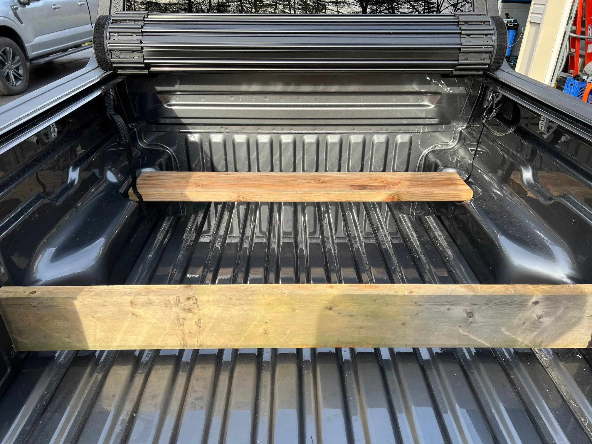

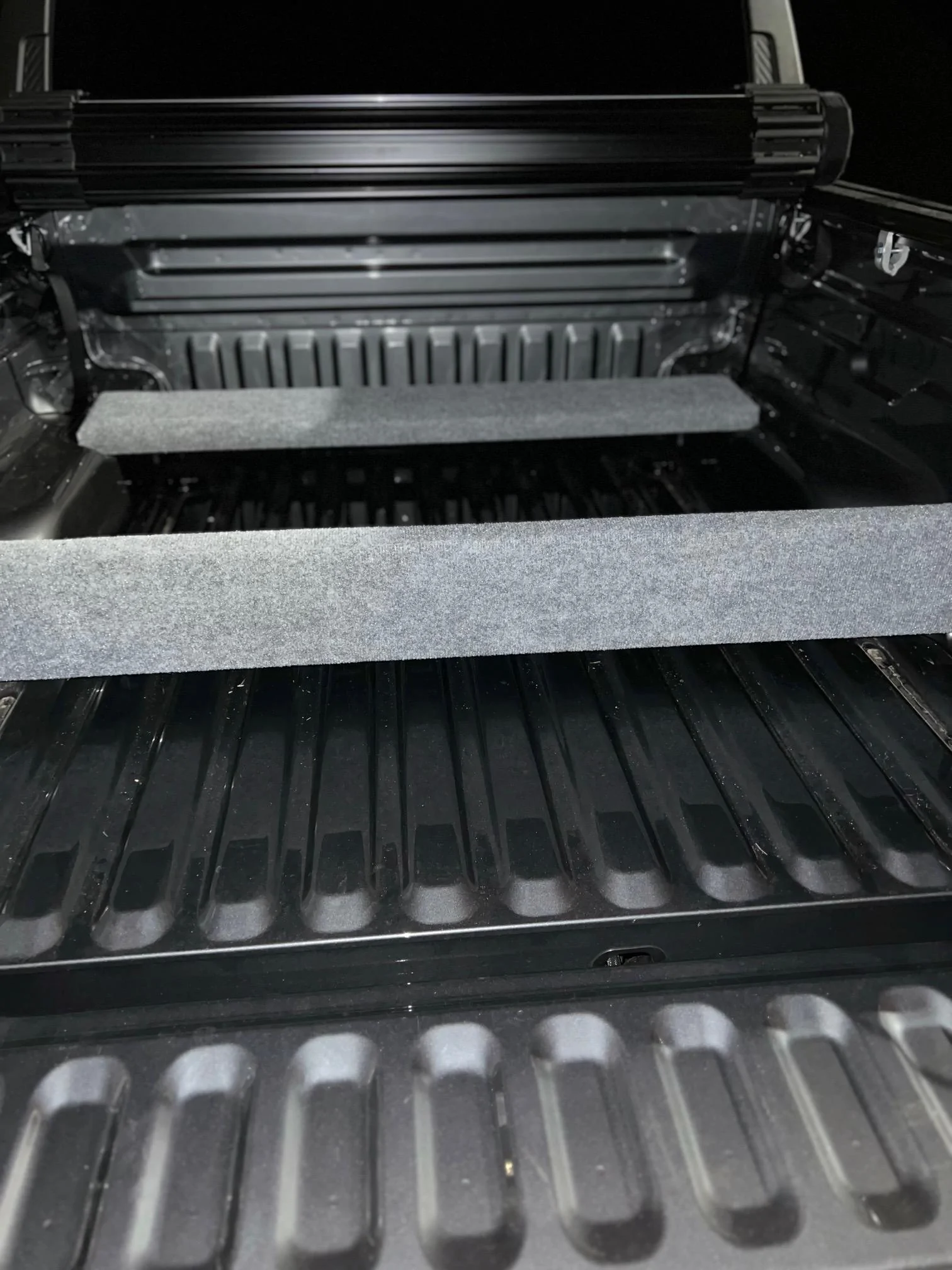

Picked up some cheap outdoor carpet at Home Depot. Broke out the ole Dewalt palm sander and sanded my board for the bed down. Wrapped the board with carpet and used 1" staples from my pneumatic stapler. I think it came out nice. Started late, so finished in the dark. I'll take more pics today.
There are holes on the wheel well hump to steady that board. I may just unwrap it, and put some type of bolt or pin to keep the board steady when driving empty. Maybe sent a lag bolt through the board and grind off the threads on the bottom.

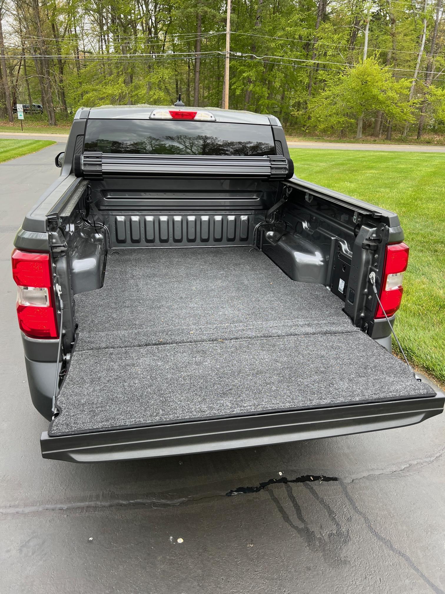

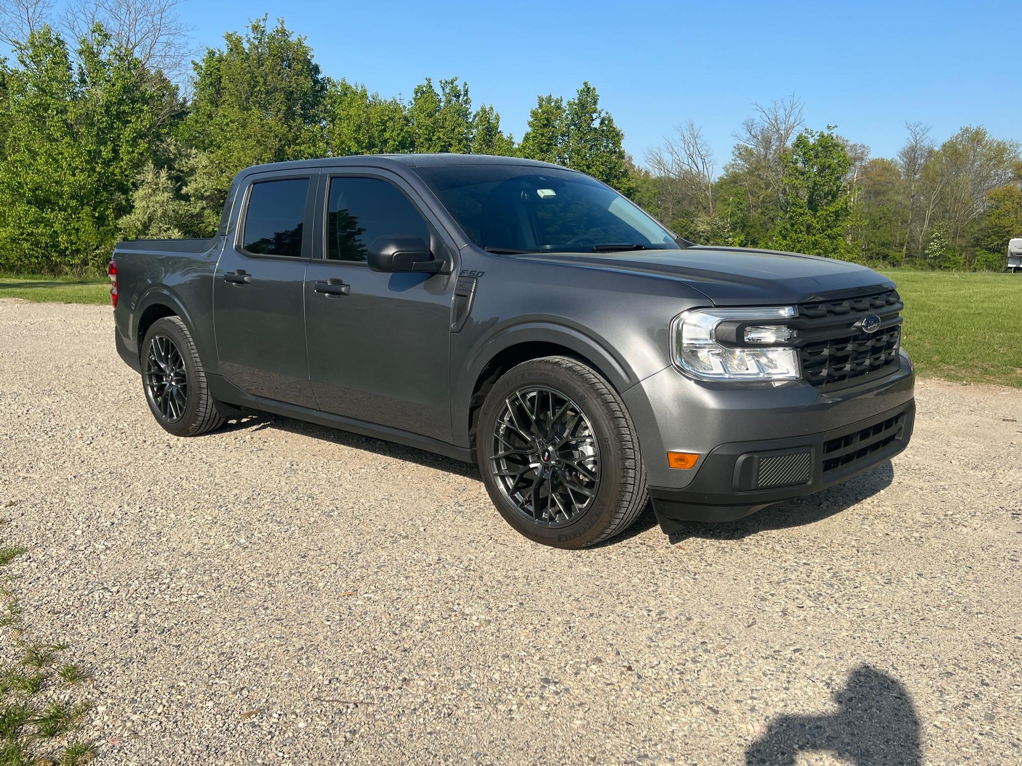

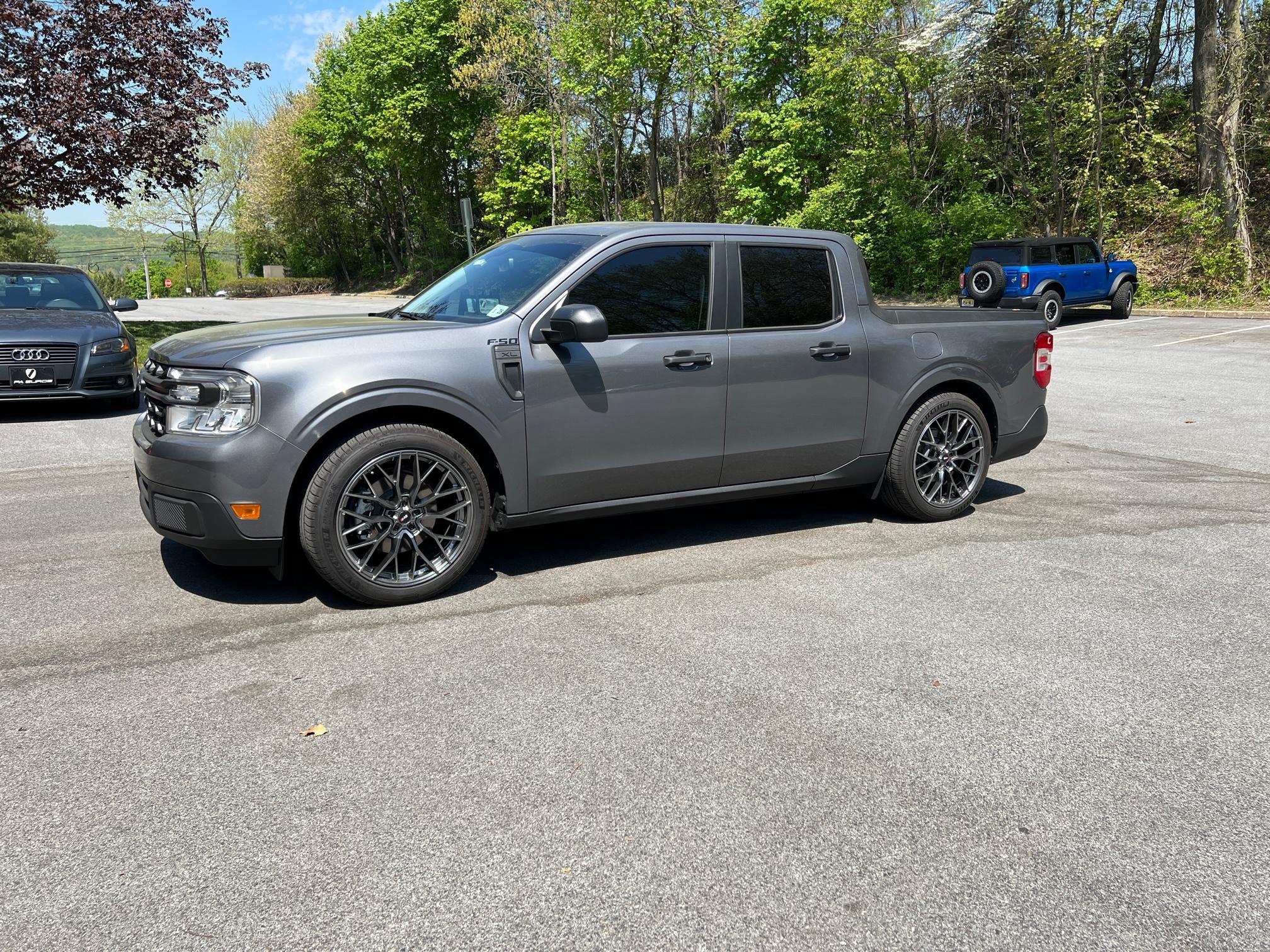

So some slight updates to the Mav. Installed the bed rug. Also lowered the Maverick 2", installed 20x9' wheels. Pretty happy with how it's turned out. Not much more I'm looking to do at this point.
It's pretty filthy and needs a wash bad. I also need to detail it and ceramic coat it, but I'm super busy.
