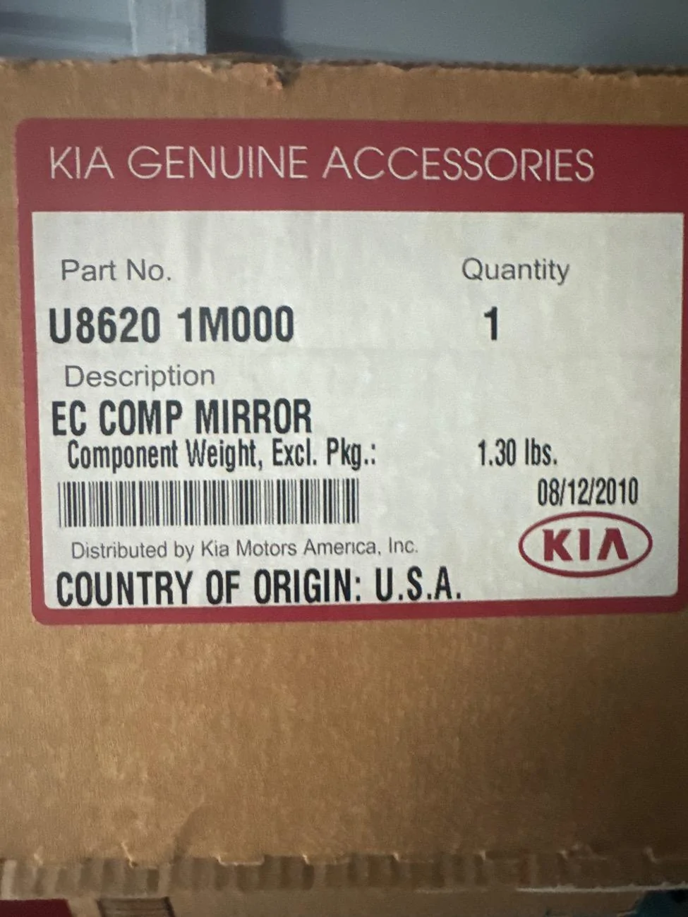

I bought a Kia mirror for mine that only has the auto dimming and compass, when I get home tonight I will look at the part number and post it.
