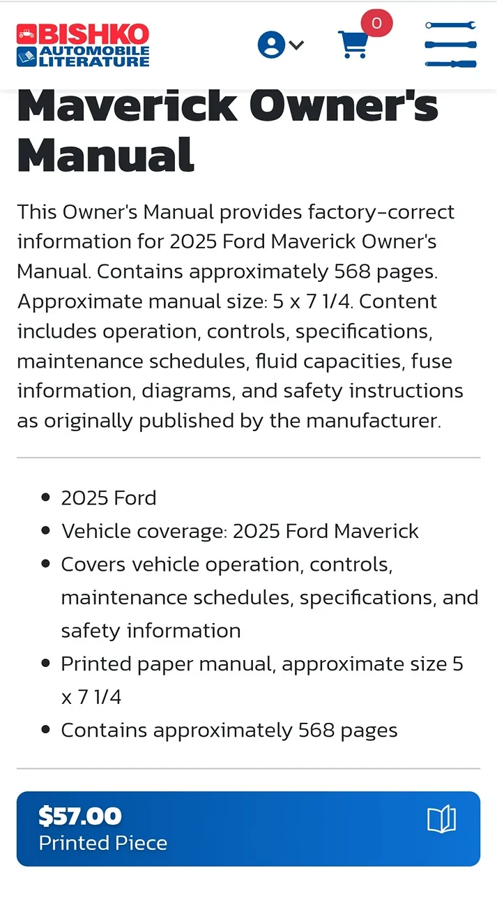

Did't known that even was an option. Boy do I miss having a real owners manual to leave in the john !!
