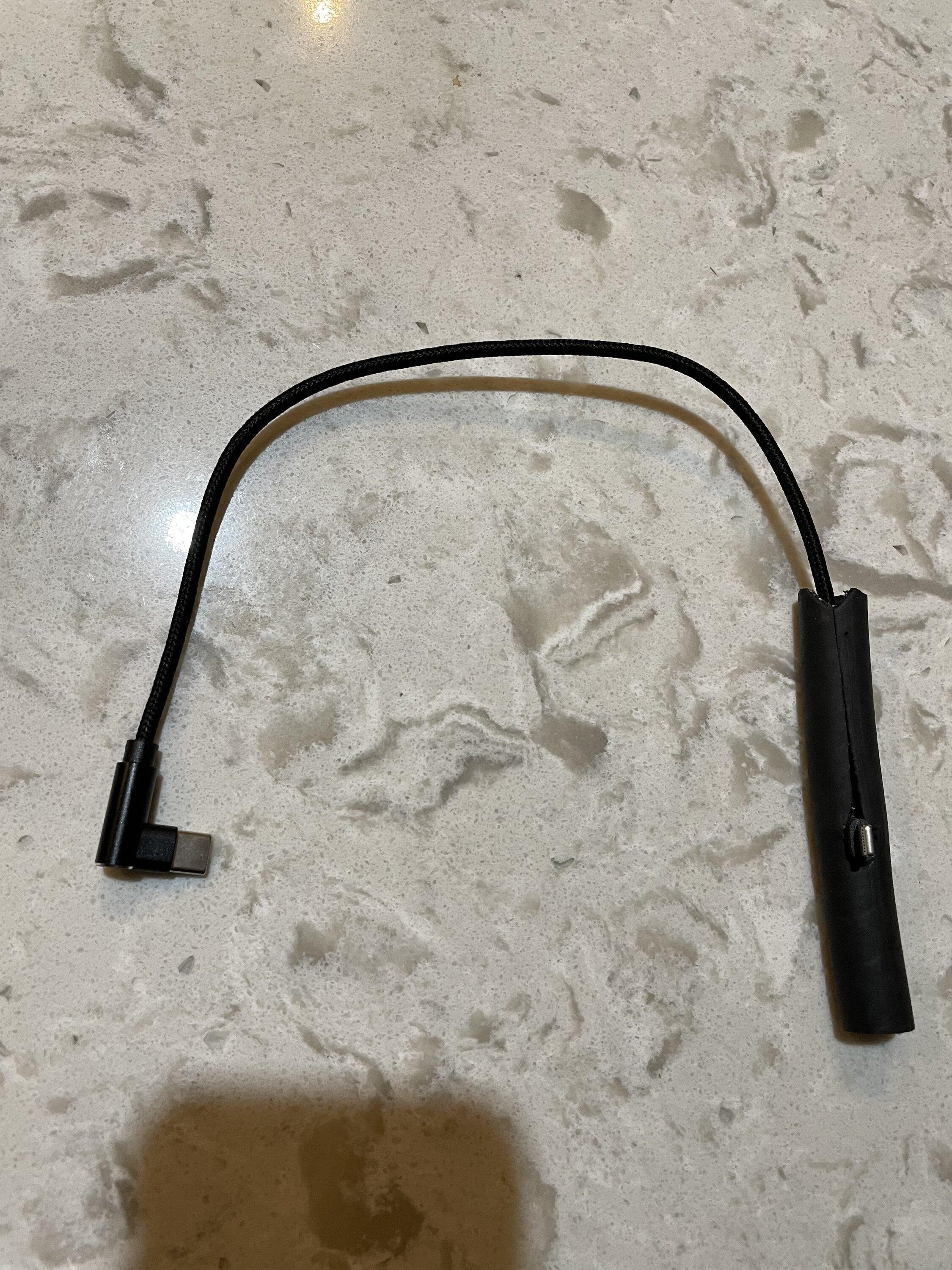

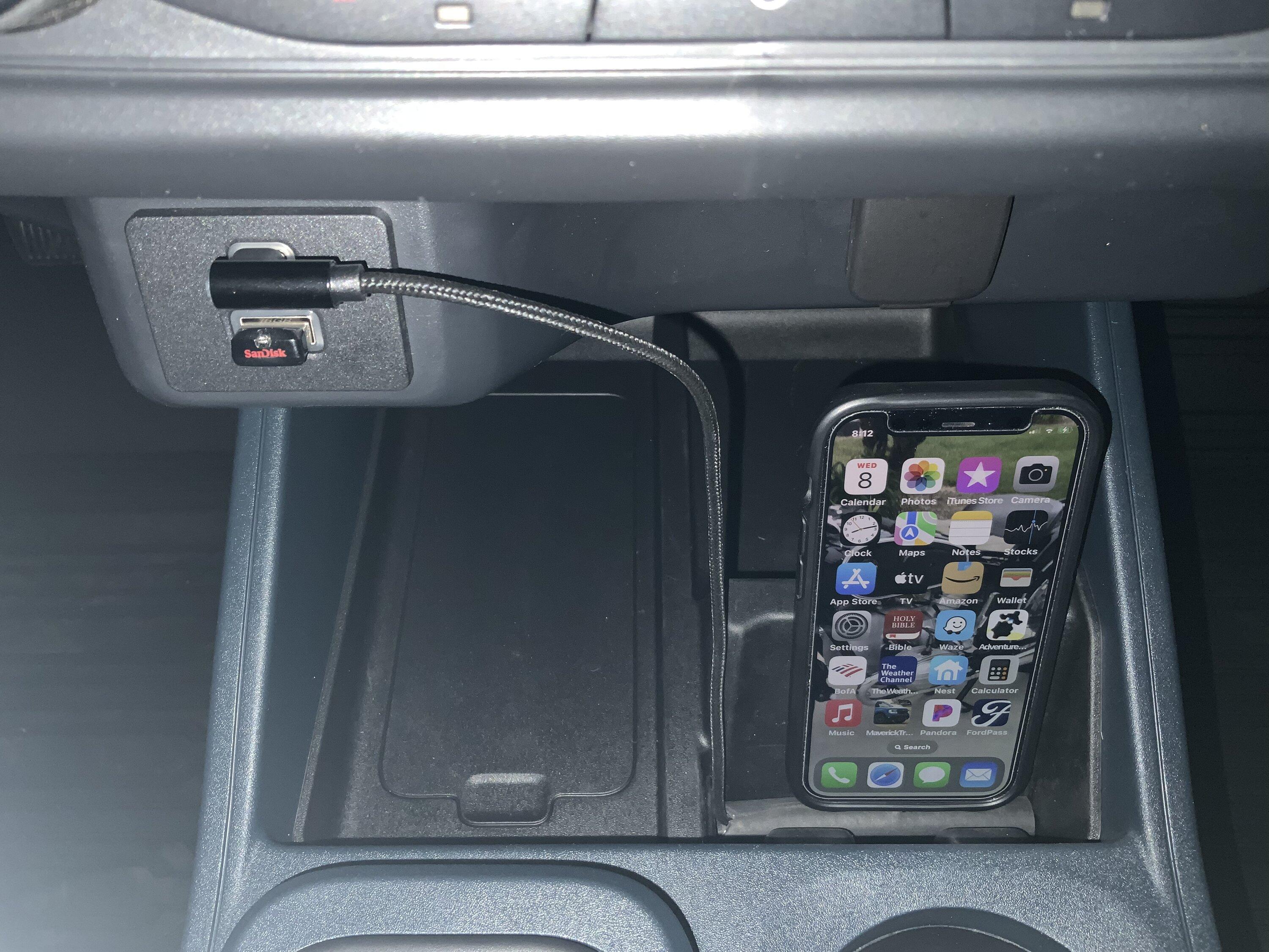

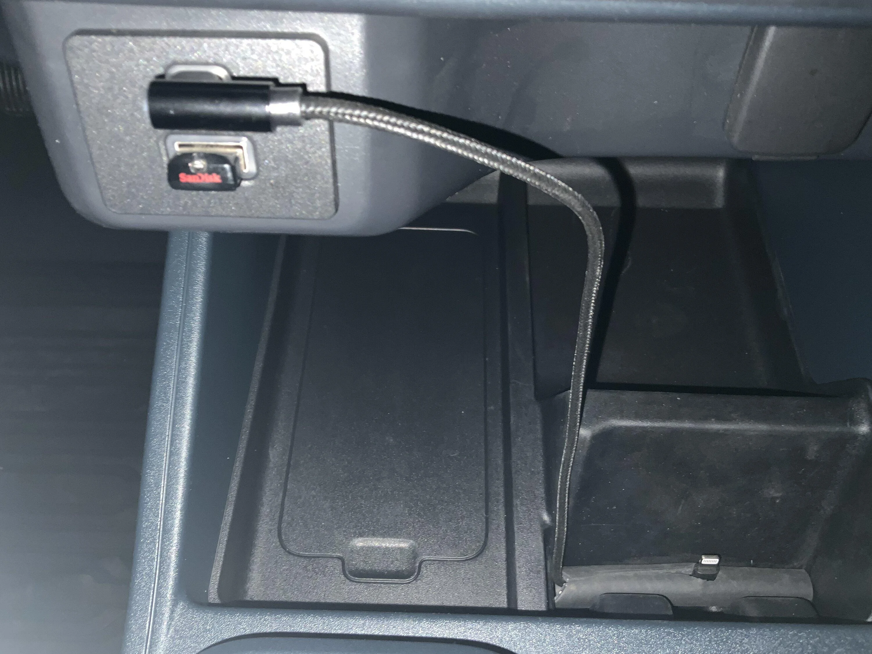

I like the angled phone holder in the console but the phone moved around and took both hands to plug in. On this site, someone made a 3D print power cord holder for the same location. I don’t have a 3D printer but I do have tons of motorcycle parts. I used a piece of 5/16” ID, 5/8”OD hose approximately 100mm long. Drill a few holes for the 90 degree lightning plug and slice hose with an exact knife to install cable. Trim or grind the hose to a length that is a firm fit in the console so the phone won’t move. The 90 degree cables are 3 for $10 on Amazon. This was literally a 10 minute job, it’s solid, vibration and rattle free and you can just grab and pull if you need your phone out. Will use for a while to de bug then do a better fab job.

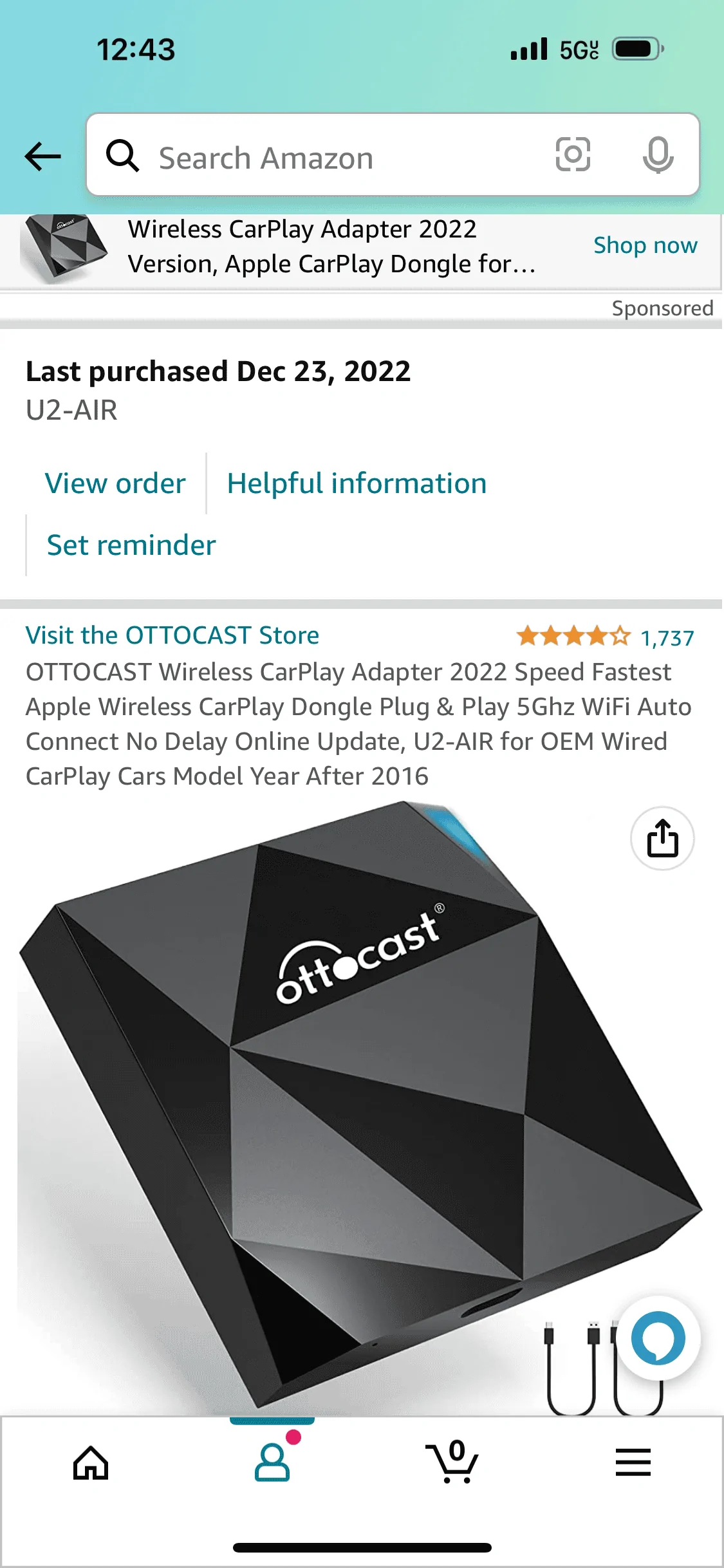

Something I found better is a wireless CarPlay device. Connects perfect every time I get in the ride. Keep phone in pocket or wireless charge tray.

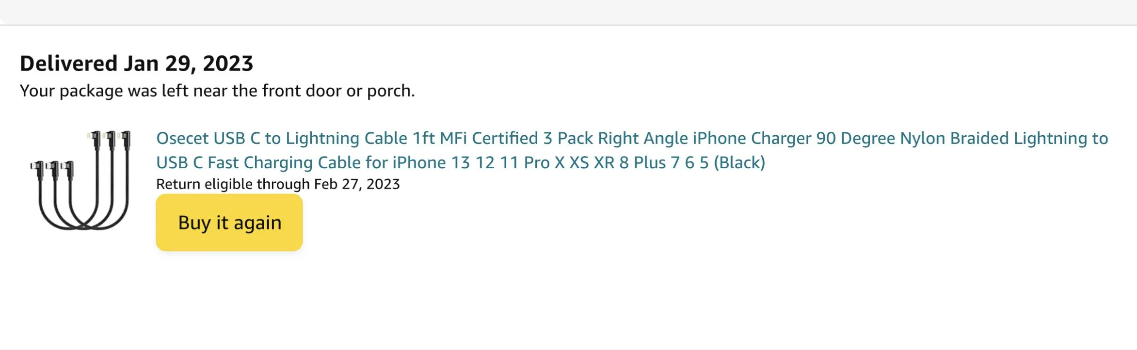

What length cable did you go with? I may try something simar with Android phone (USB C)

The last pic shows a 12” 90 degree cable. Not sure if there’s an android variant.
