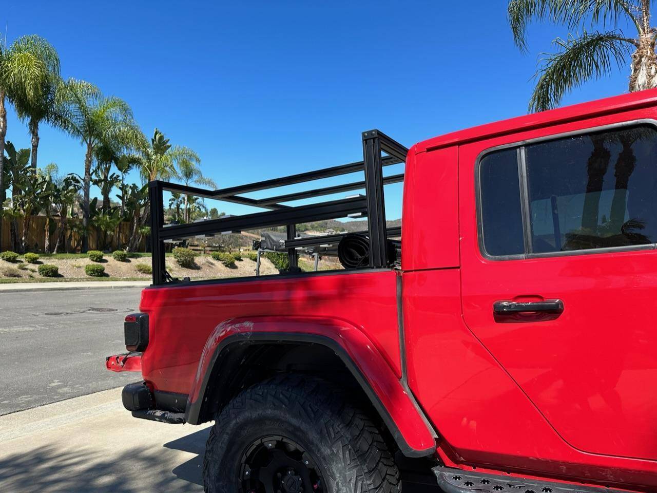

I am hoping to make somthing similar to those posted on this thread on the gladiator forum - https://www.jeepgladiatorforum.com/...usion-t-slot-rack-for-bak-revolver-x4s.59111/

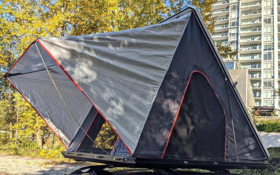

thinking about 18" tall so it just clears the antenna fin and then getting a Aluminum wedge roof top tent similar to this one. It has lengthwise T-slot rails on the bottom so I should be able to position it forward above the cab so the rear lines up with the tailgate.
Ford Maverick 2025 XLT AWD Hybrid - Light overland / camping build - Looking for feedback 1747543800855-gf
The idea with the higher tent set up is to leave enough space in the bed to fit mountain bikes in the bed for shuttling with a tailgate pad.
