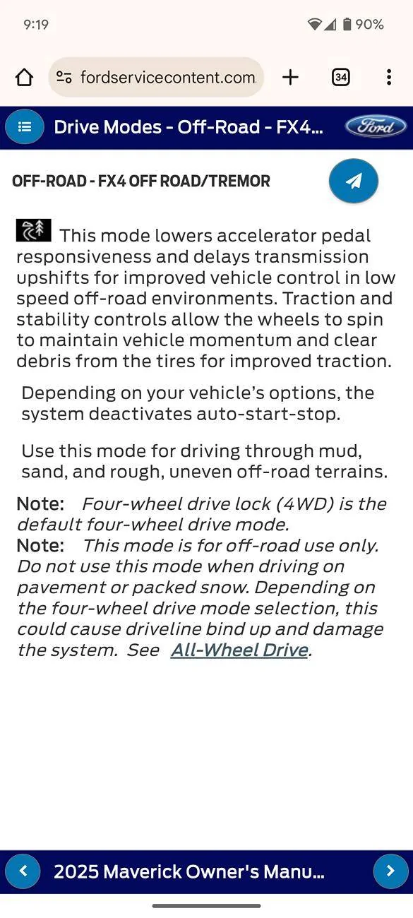

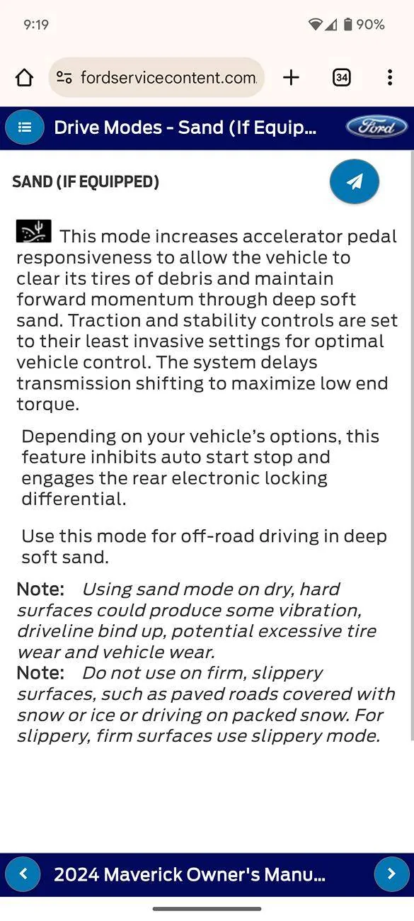

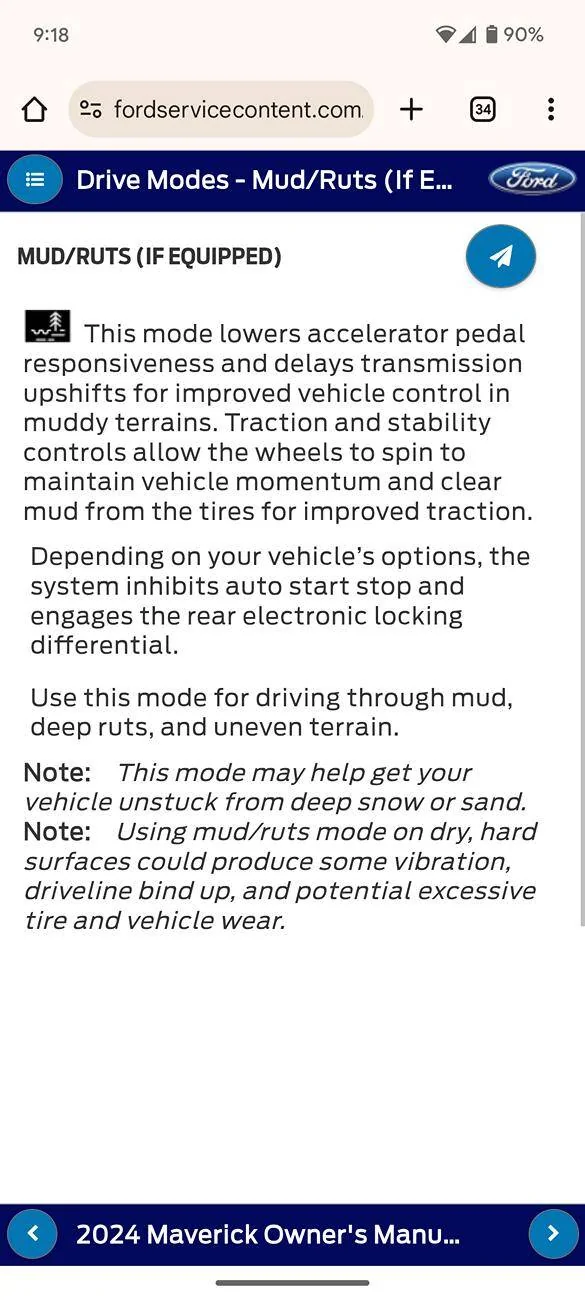

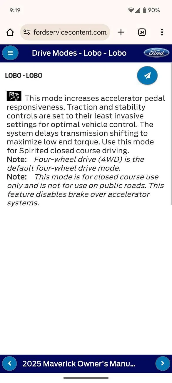

Found the answer I was looking for. I am posting here for anyone else who is interested:
It seems that the new "Offroad Mode" is just mud/ruts with a new face. I was hoping that it would be closer to sand mode which many users have reported as a more fun, engaging and useful drive mode.
Reading on I noticed that the old Sand Mode and new Lobo mode have incredibly similar descriptions. It makes me think that sand mode was removed from the Fx4 and tremors to further differentiate the Lobo. Which if true is incredibly frustrating.
Here are attached the description for the new and old drive modes:

So I enabled SDM mode 09 (Sand?) in forscan... low and behold it comes up as Lobo mode so you may be right :LOL:
Although it does say "Track Use Only" and seems to only be for racing mavs so not sure. 🤷‍♂️
