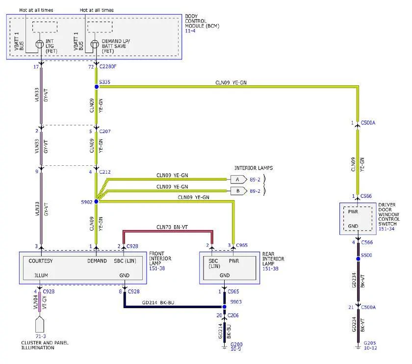

Has anyone figured out where the sunvisor wire harness is disconnected from the courtesy power on the XLT? The harness is on the headliner and has the correct connectors for the Lariat visors. Where is it disconnected from power?

Hi you need to tap on the yellow green cable at the right side A pillar. I reused the connectors with cables + a ground you have behind the glove box.
