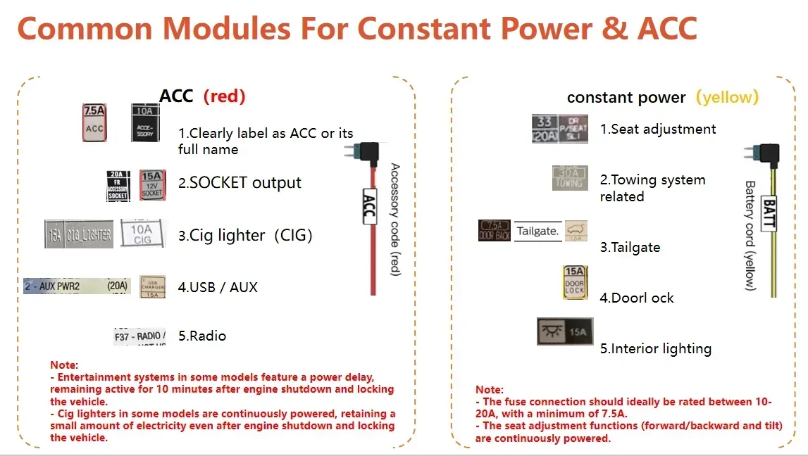

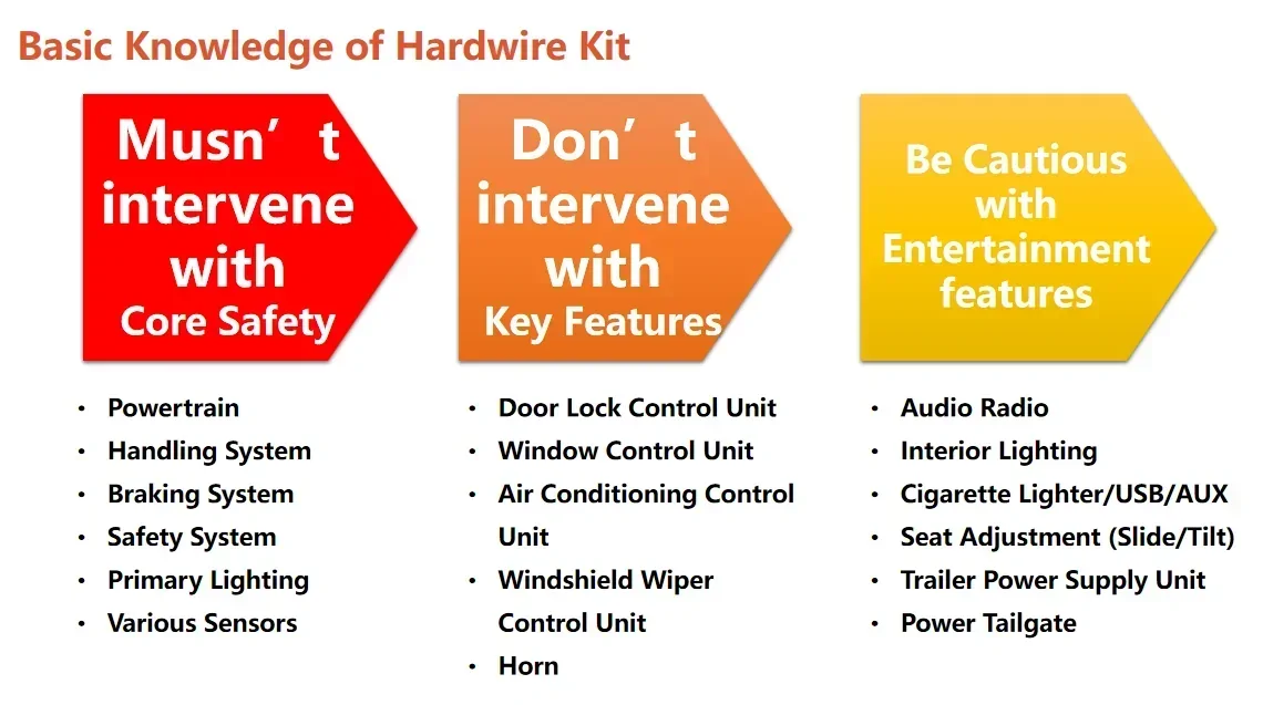

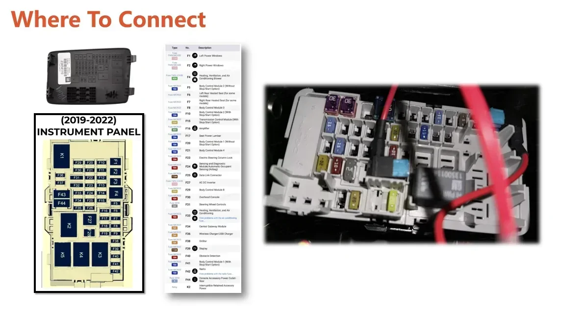

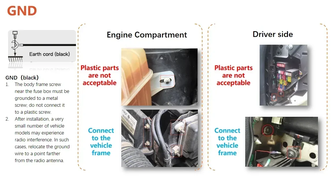

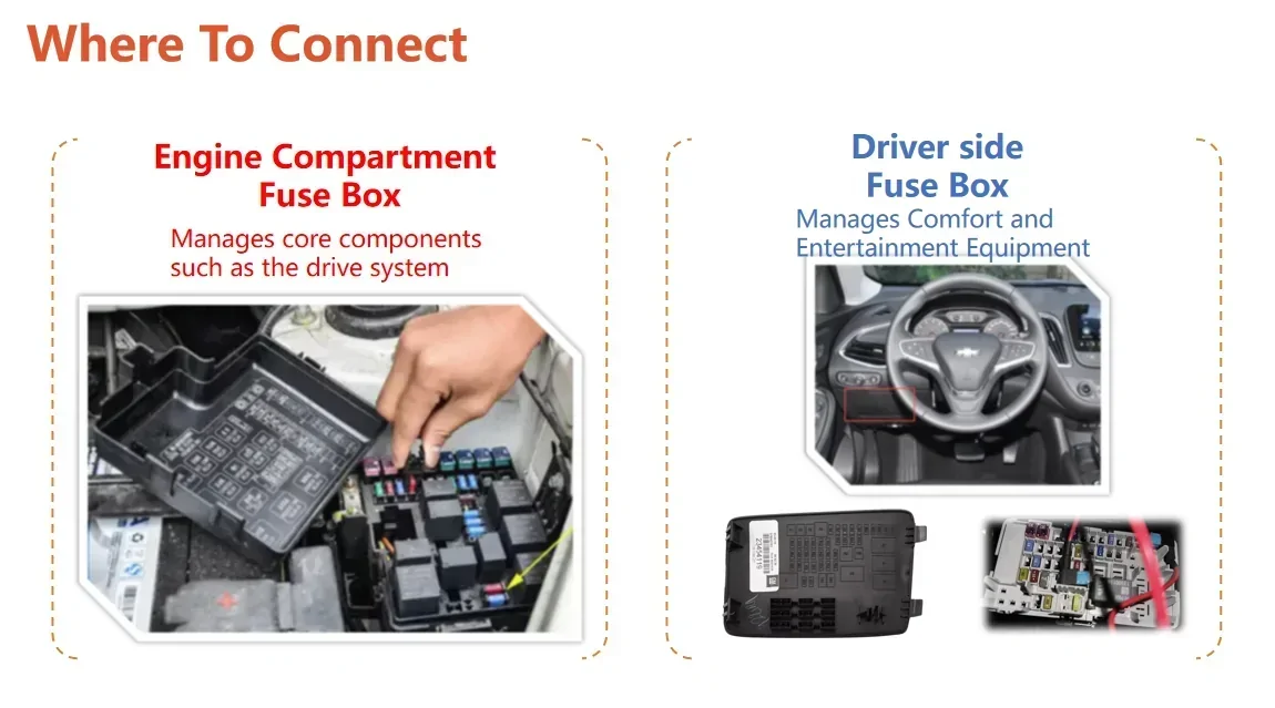

Ford Maverick Wolfbox: Knowledge on Hardwire Kit and Installation [Part 4] 1773657026751-xk
Ford Maverick Wolfbox: Knowledge on Hardwire Kit and Installation [Part 4] 1773657041581-rz
Ford Maverick Wolfbox: Knowledge on Hardwire Kit and Installation [Part 4] 1773657050841-w6
Ford Maverick Wolfbox: Knowledge on Hardwire Kit and Installation [Part 4] 1773657059563-0v
Ford Maverick Wolfbox: Knowledge on Hardwire Kit and Installation [Part 4] 1773657067635-ih
