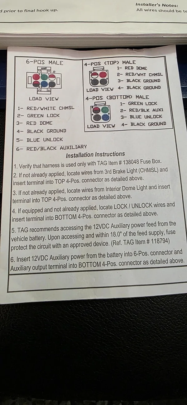

I'm looking into getting a truck cap, and one of the features I'm looking for is a electronic lock that hooks into the tailgate lock, so that when I lock/unlock my truck, the truck cap locks/unlocks as well.

Bought my custom ordered LEER cap from a local dealer. They did a fantastic job on install. I have had zero issues with the electronics (locks & lights) on cap.
LEER has been my cap of choice over the years, and have always been fantastic.
