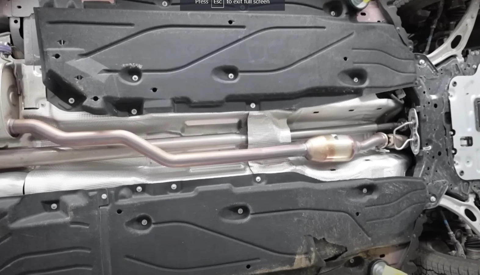

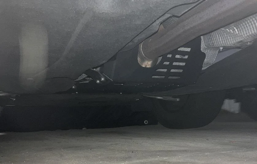

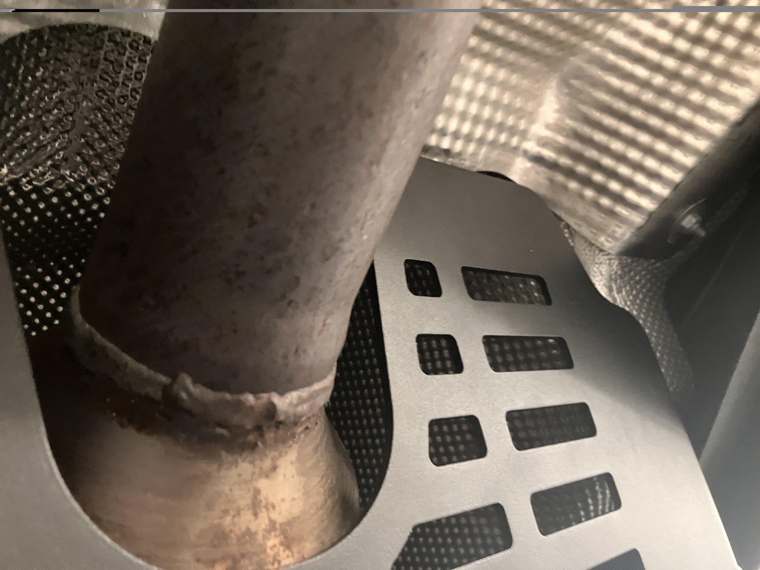

Just thought I would post a photo of the issue.
How the skid plate fits on the Maverick. Notice how close the cat is to the rear opening:
How it looks on their website, apparently the Bronco Sport catalytic converter sits further forward than on the Mav

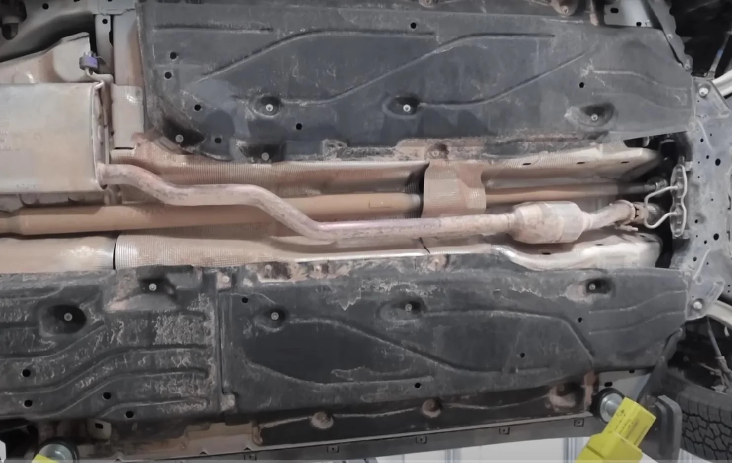

Just to update the saga, JCR Offroad says they have one of these on their in house Tremor.
Here are photos of the undercarriage of a Tremor and a regular Maverick AWD. They look the same to me but I suck at those "spot the differences" games. Anyone notice anything significantly different?
Mav FX4 undercarriage:
Tremor Undercarriage:
Other than your Mav is an earlier model with the umungus resonator, probably no difference.
Might be some other minor dimensional differences as well.

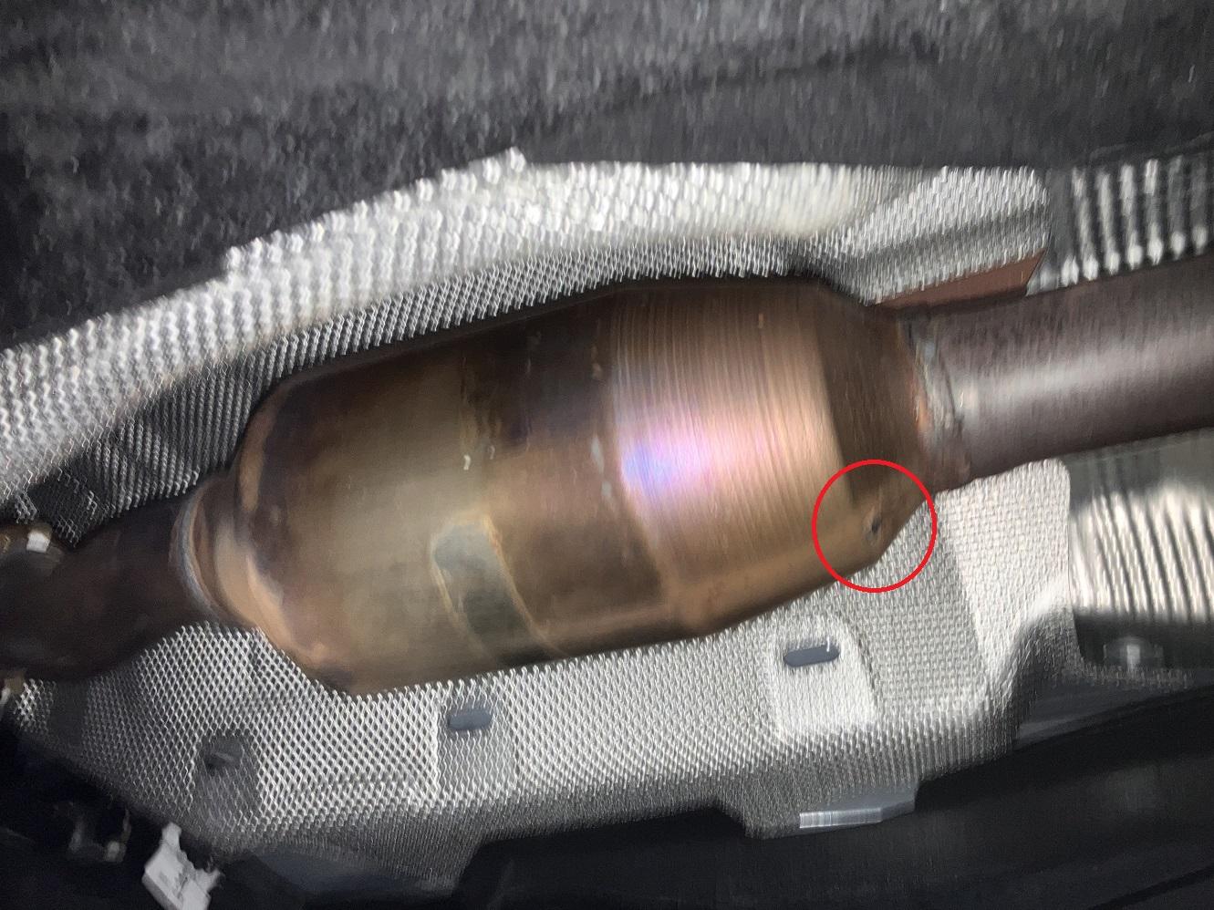

Everything about mine looks the same underneath. Here's the spot where the cat was resting on the skid plate.
