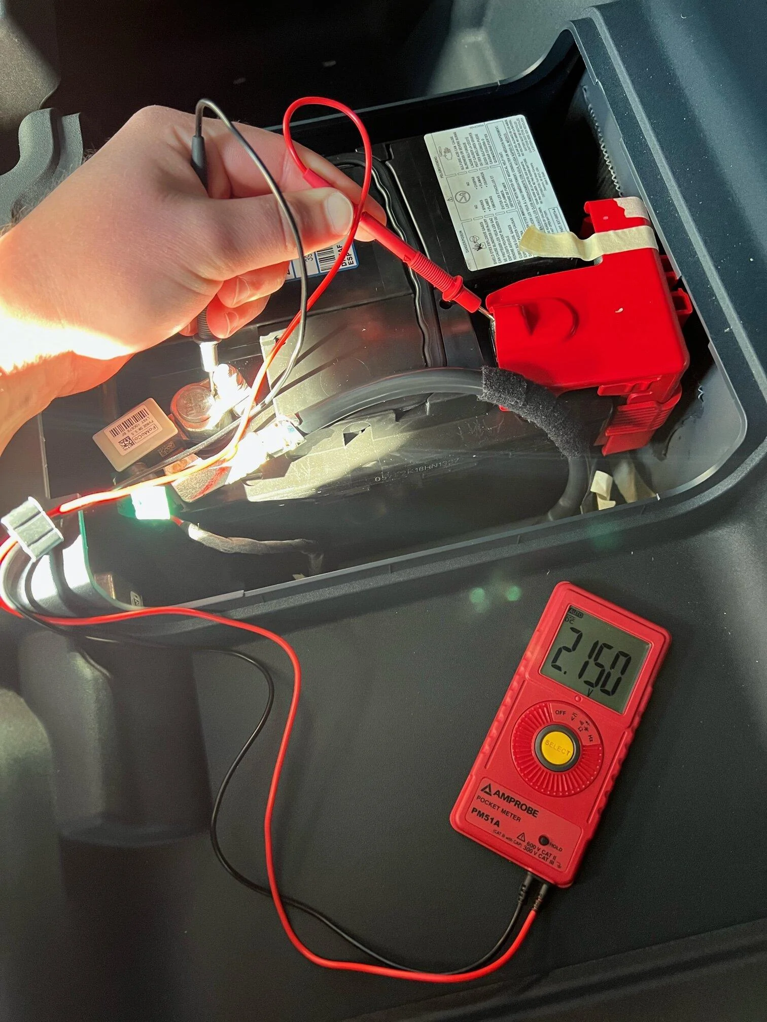

First Update: Fixed for now at least, took it to the dealer, they performed a load test on the battery, it failed (any battery with only 2.15 volts will fail a load test), so they replaced the battery. They didn't perform a parasitic draw test like I hoped they would but if this happens again, I will make sure they do next time.

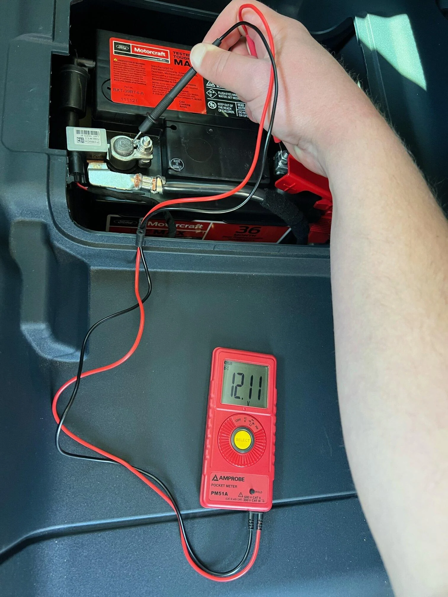

Another Update 2/4/22: After the dealer replaced the battery a couple days ago, I just got another FordPass Deep Sleep Mode notification. I checked the battery voltage with my multimeter while the car was off and with doors closed, and it read 11.6 volts. So it does look like the battery is draining on it's own for sure and the first battery wasn't just a "bad battery" as new batteries should read 12.6 volts. I have a Mercedes with a 4 year old battery that still reads 12.3 volts with the car off. I'll give it another day or 2, see if it completely dies out again, and back to the dealer it goes...

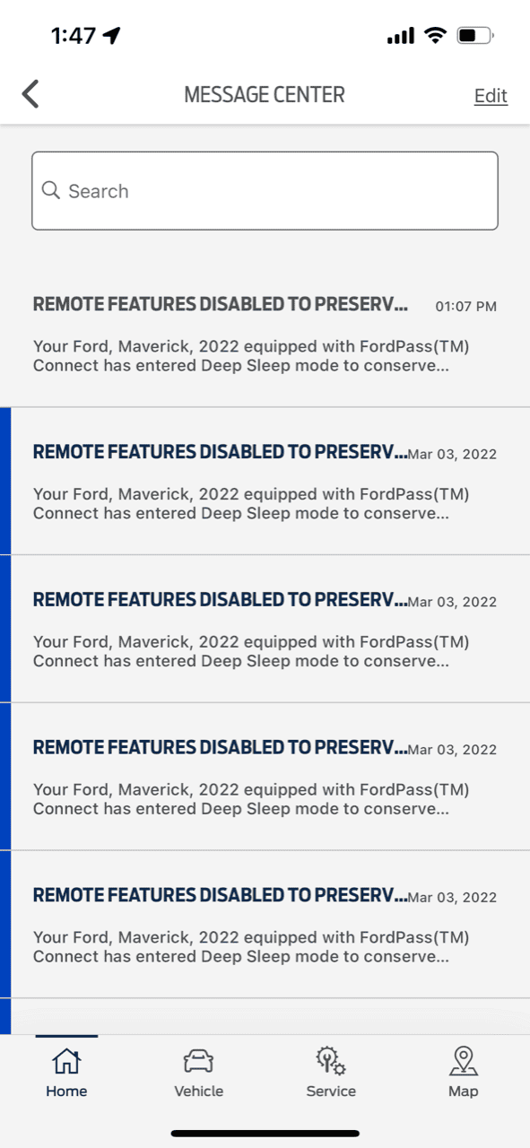

UPDATE 3/13/22: Have had the truck back in my possession now for 5 days and it hasn't died yet. I only got 1 deep sleep mode notification on the day I got the truck back. About a week before that, I noticed a notification on my FordPass app that said the software has been updated to the most recent version. I believe this may have been the fix for my issue. Normally, my Mav would have died by now. As far as the deep sleep mode notification and 12.1v battery reading the day I got it back (3/8/22), I think that may have been because the dealer didn't fully recharge my battery before returning the car to me. Will keep driving the truck and update. Otherwise, the truck is driving great so far.

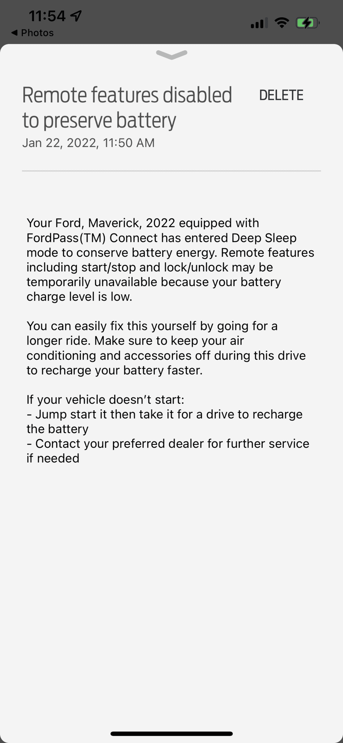

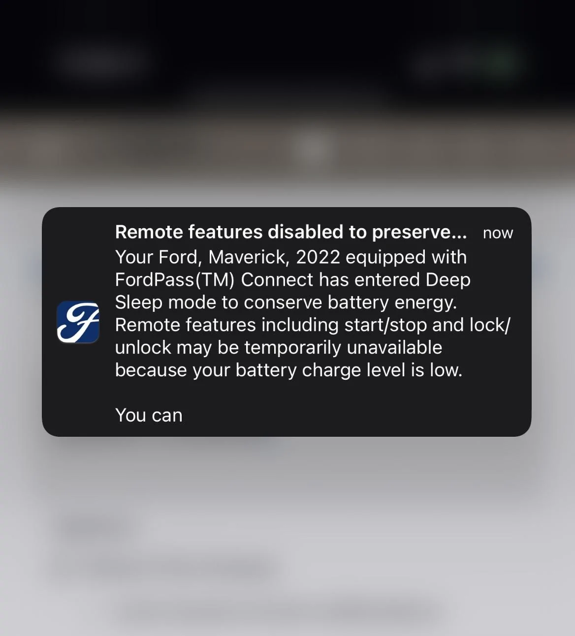

I've been getting FordPass app notifications saying my vehicle has entered "Deep Sleep Mode" because the battery charge level is low. In addition to this, the door open/ignition chime started playing out of a small speaker within the steering column instead of the car speakers. Keep in mind, the vehicle was driven every day and nothing electrical was left on or plugged in while parked. I also noticed the ICE (Internal Combustion Engine) was kicking on sooner and more frequently over the last 2 weeks causing my MPG to drop as well. Probably trying to recharge the 12v battery.
