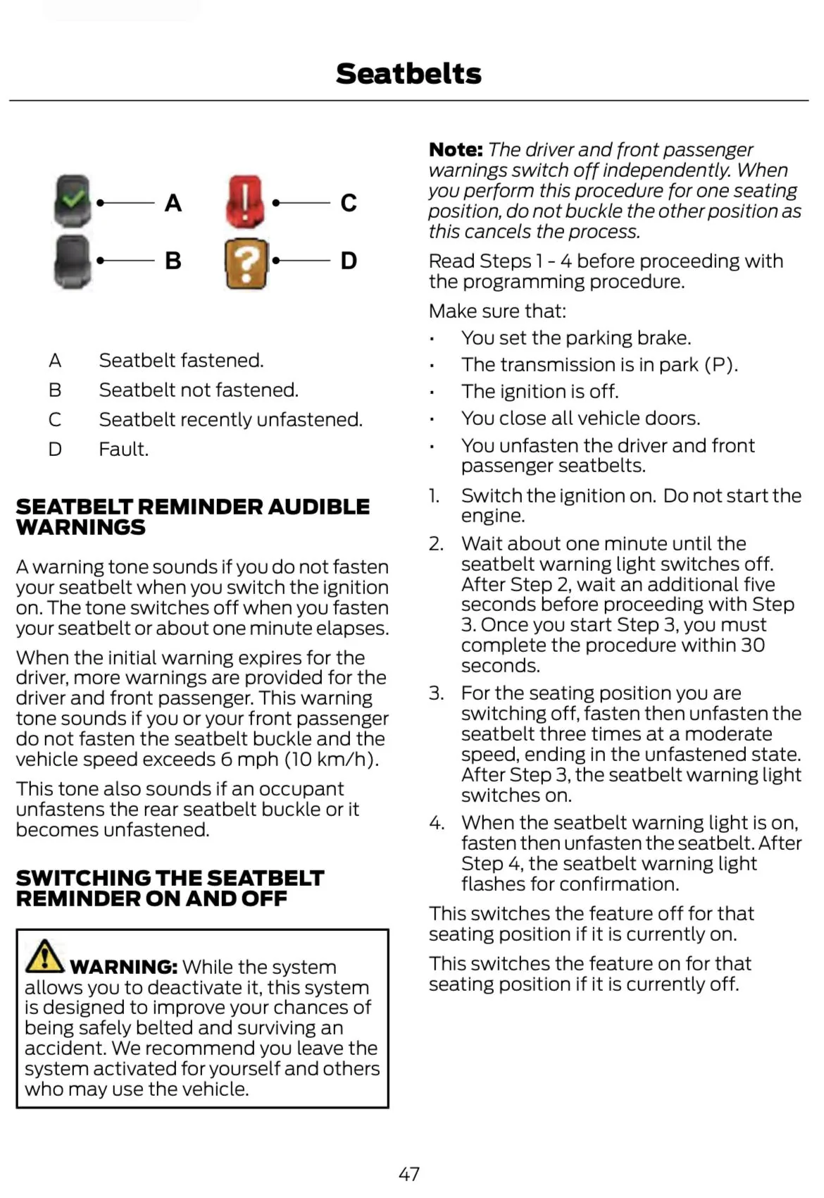

So I did what the book says to disable the seat belt chim but can’t get the seat belt dash sign to turn off so I can do the process. What gives??
